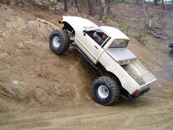

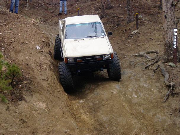

i'll say:
Attached Thumbnails Project Cream Dream + The Crush = Colorado fun!-p1010038.jpg   Project Cream Dream + The Crush = Colorado fun!-p1010045.jpg

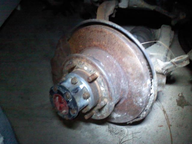

OldGold, I just got me a set of IFS Hubs, calipers, and rotorsProject Cream Dream + The Crush = Colorado fun!-0427092201.jpg. Thats just surface rust, the parts are actually in great condition. Calipers are in good condition and the pads are new! , the rotors won't be used, but they are like new...well after I get a couple of months of surface rust off of em. (might use them on the rear disc swap if possible). It's good to know people who have stuff like this laying around for free . Thanks again for getting me pointed in the right direction.

Don't worry about the surface rust, because you won't be using IFS rotors. What you need are land cruiser (fj-60) rotors. They are .250" taller than the IFS rotors, and line up perfectly with the IFS calipers mounted on the outside of the steering nuckle. Good job on the free parts score!
