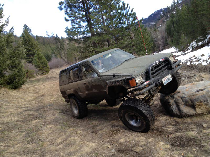

Old Jul 10, 2013 | 07:22 PM
84runnerWa's Avatar
Joined: Apr 2013
Posts: 11
