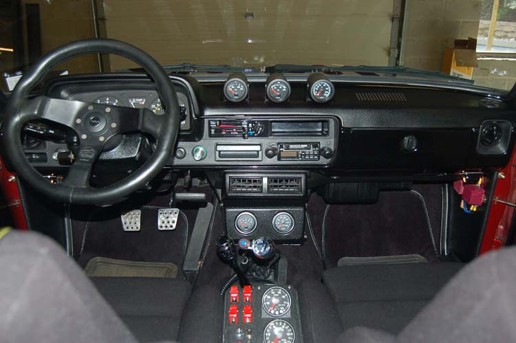

Auxiliary Gauges
Here are mine.

suncomb1- Bad A**

+1!!!

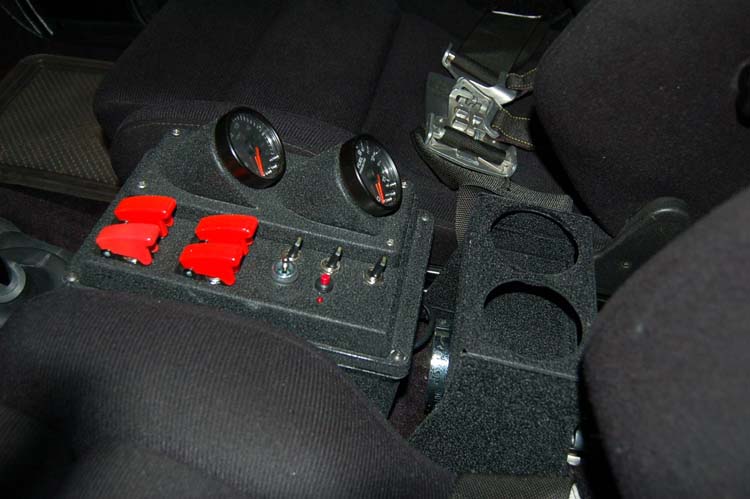

Can we see more of that custom job up close? Really curious about the center console

The center console was made from a Hoffman fiberglass electrical enclosure and the dual gauge pod was purchased at a flea market then mounted onto the top of the electrical enclosure. The SS cup holder unit was purchased on Ebay and I made a bracket to bolt the cup holder unit onto the rear of the electrical enclosure. After all of the switch holes were layed out / drilled and everything was bolted together I painted them with black crackle paint.

Yeah that's one of the coolest first gen interiors I've seen
