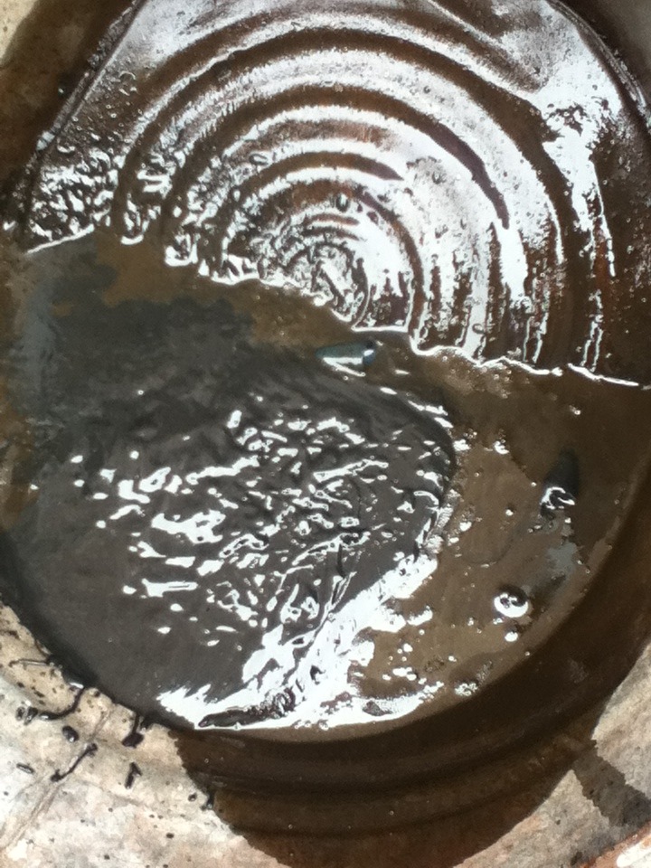

Super dark and thick. Foamy is not good. Lot's of little metal shavings, not good. Some metal shavings might be normal, but a lot is not, and chunks are not good.
But yeah, if you've got a manual tranny, changing the fluid is a good thing, and the sooner the better. If you drive it around and get it nice & warmed up, you should be able to get the crap out without worrying about flushing.
Also, beware hijacking someone else's thread. You can start your own if you have a lot of questions.
This is what I took out of my axles. I'd say that's pretty bad! I used an air compressor to blow out the diff, seemed to work well.... there was no way that this stuff would have dripped out on its own.

wow.
mine wasn't quite this bad, but i did notice a change in both drivability and mileage.
