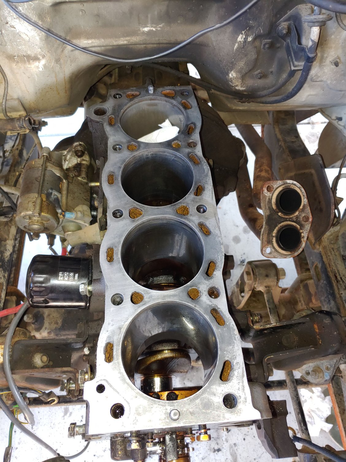

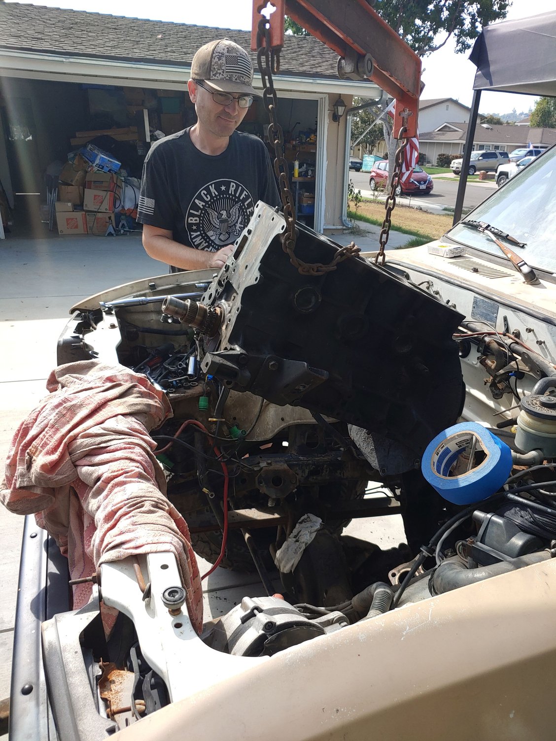

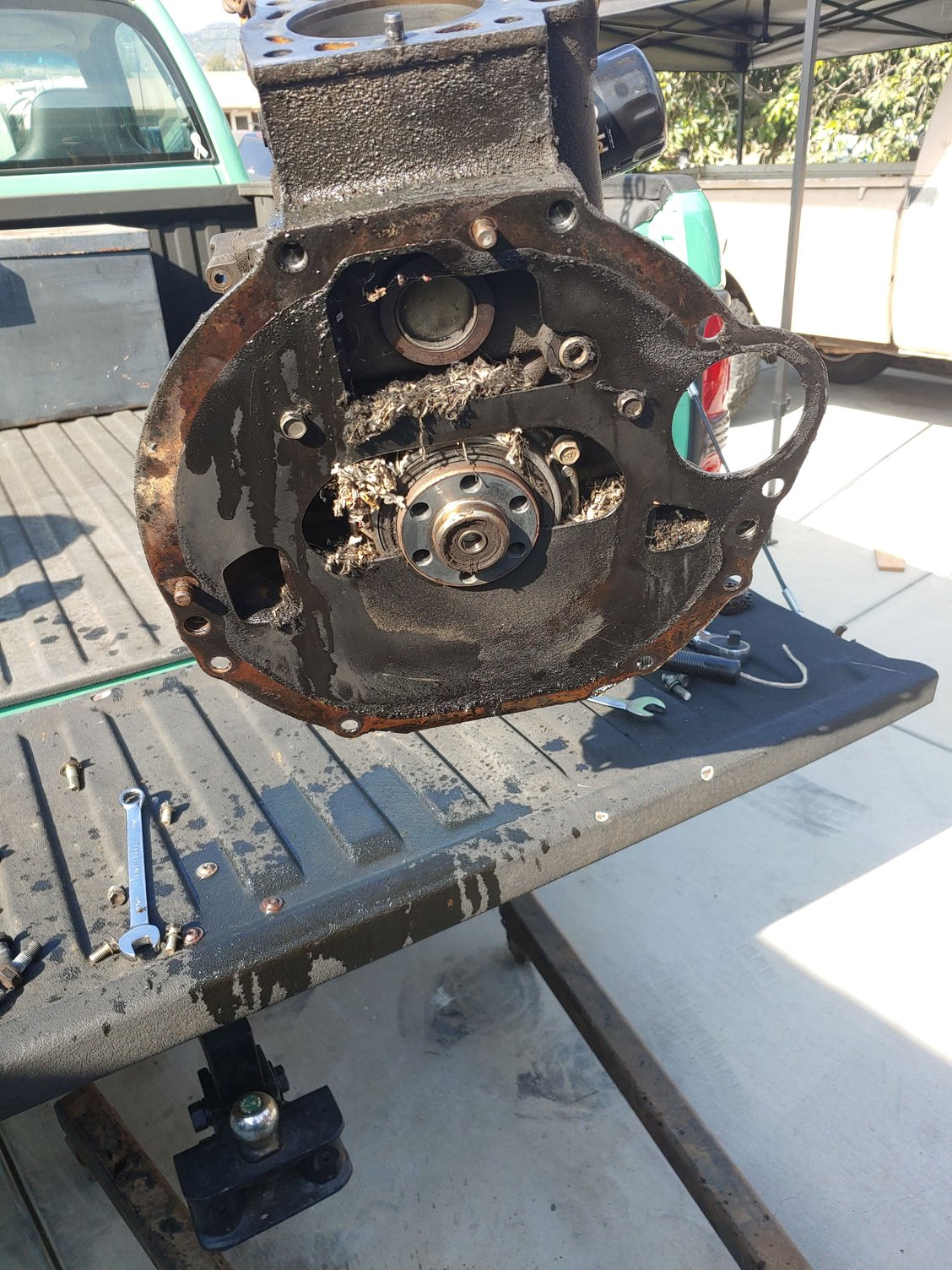

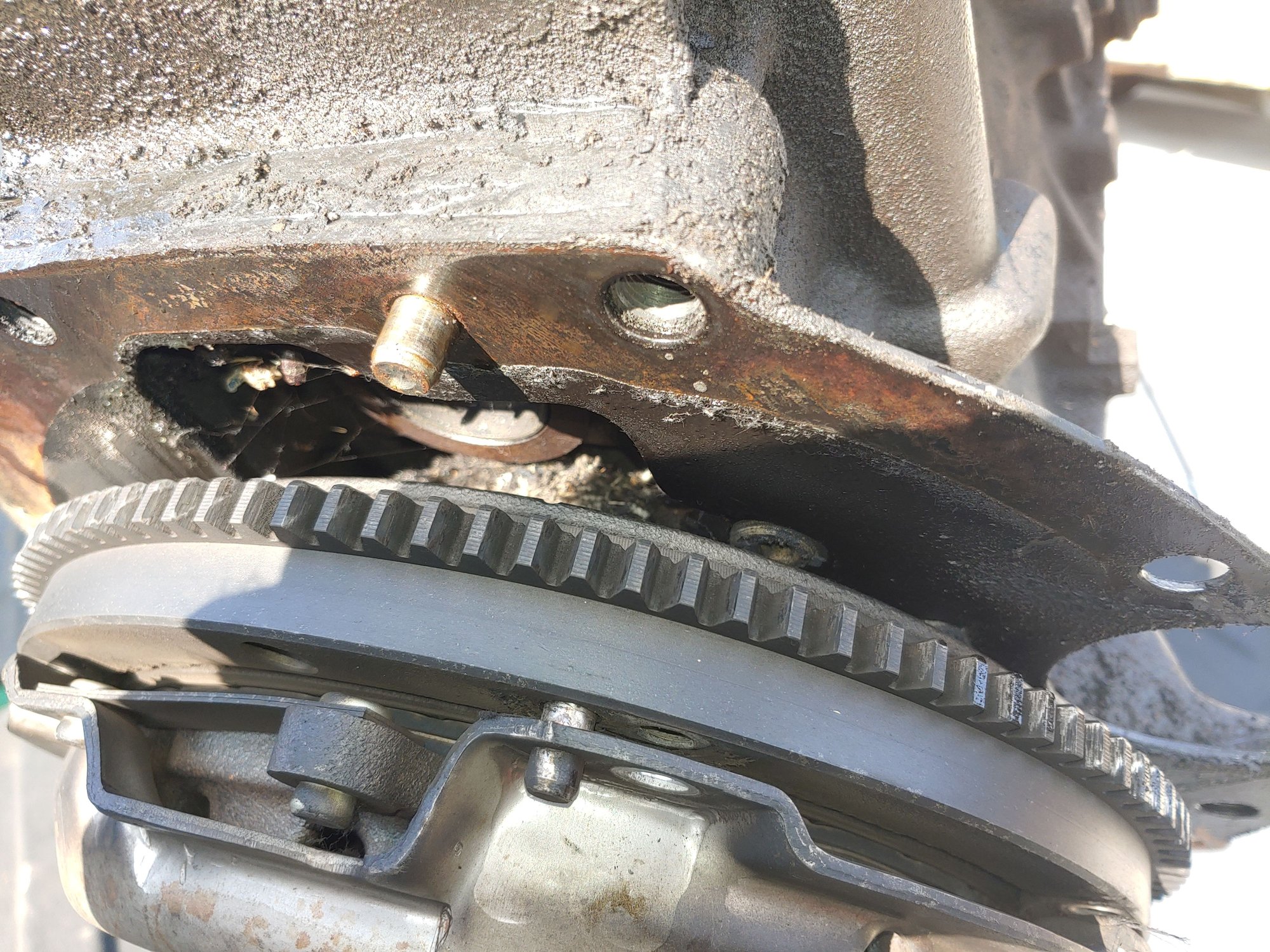

Well we changed our minds this morning after really looking it over. One cylinder # 4 looks odd. So out it came. Pretty easy really. Had a hard time finding the last 17mm bolt and found it hiding behind the clutch actuator at. Plus we found a Rats nest top of block and bottom sides. They ate the clutch rubber boot to get in there but none were home. Now tomorrow off to the same machine shop.

One other reason for pulling this engine was the condition of the oil gallery. When I pulled off the old timing chain tensioner the oil that came out looks like thick Texas crude oil. And no way to clean the oil gallery completely without pulling the engine. Now with getting it hot tanked it will be like a new block. I do think it had been over heated in the past and that's the primary cause of the thick sludge.

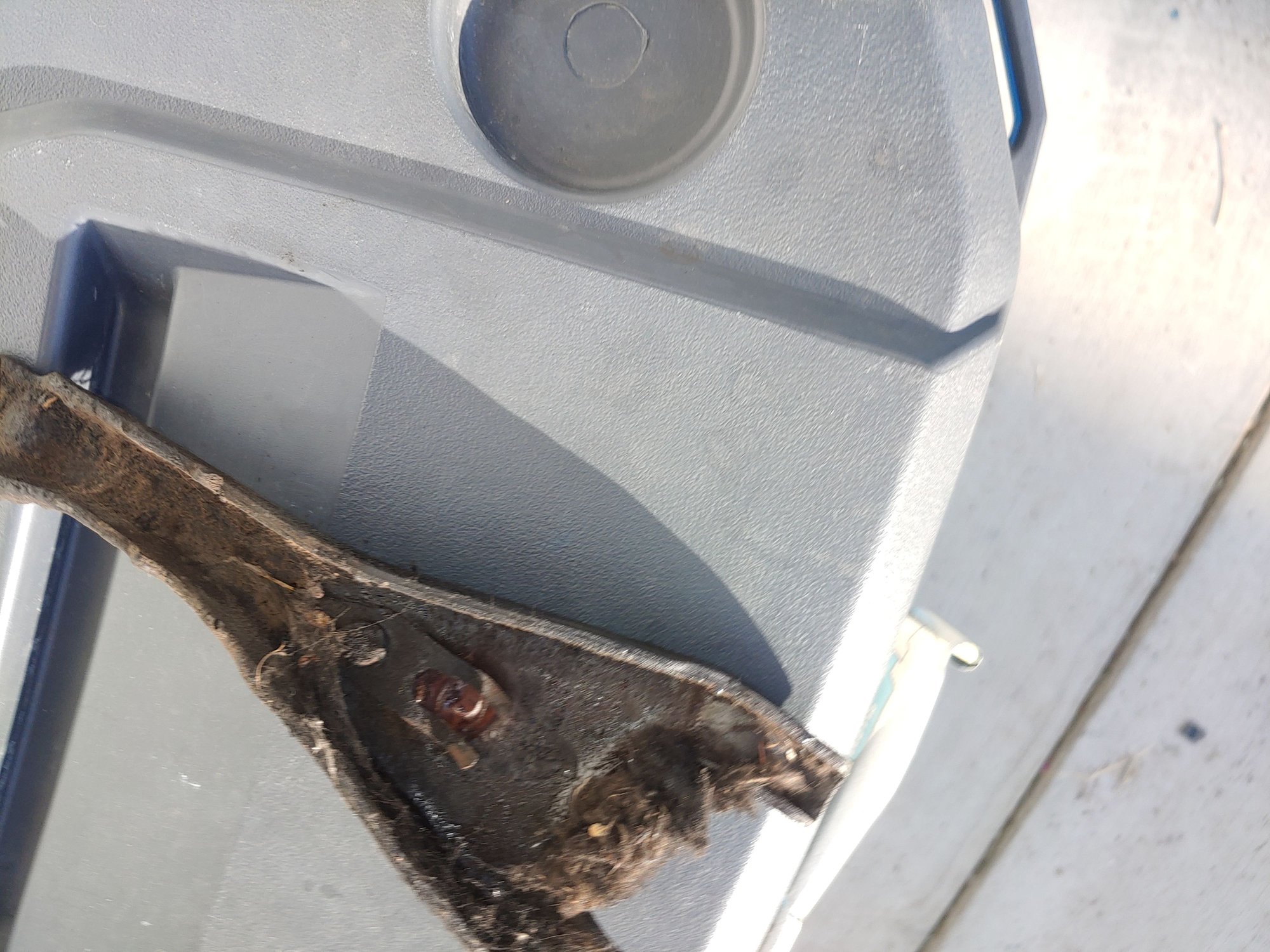

Here is a picture of the clutch fork. The rats had build a nest in it too. A very good reason to check the fork boot.

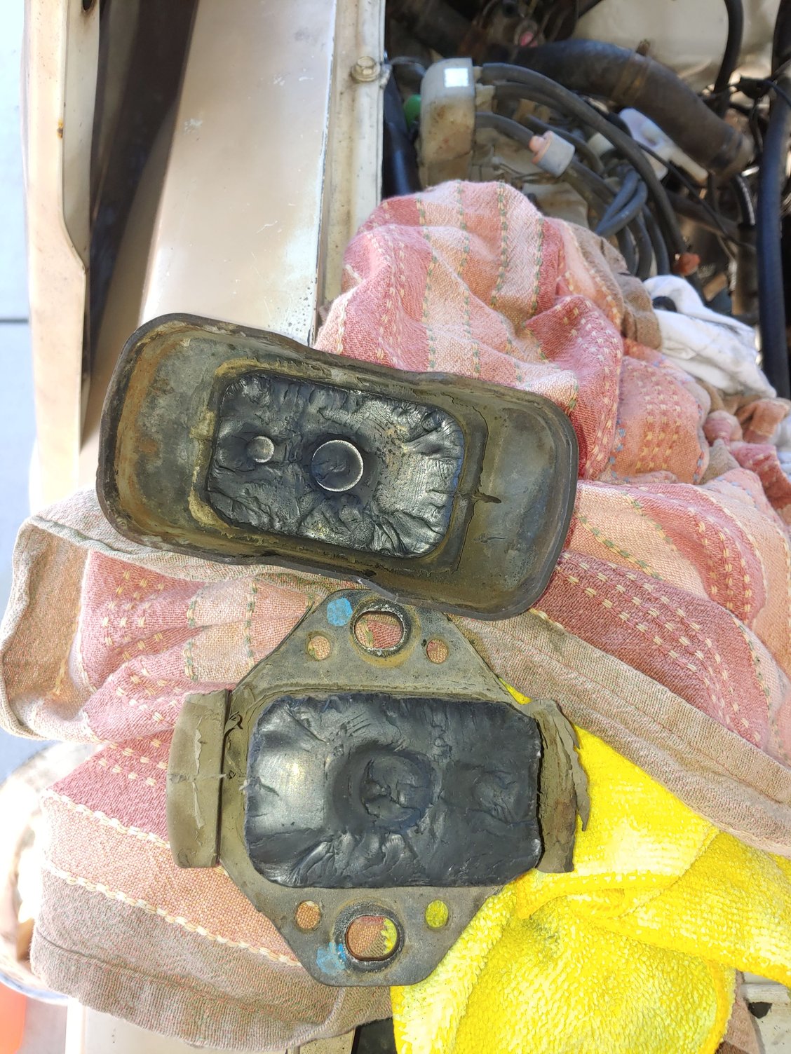

In cleaning up items and gathering parts we found that both front Motor mounts were shot. They had separated. There was so much oil sludge in the bell housing that I resorted to scraping it out with a putty knife and then 5 Coates of a orange based degreaser. Now getting clean.
