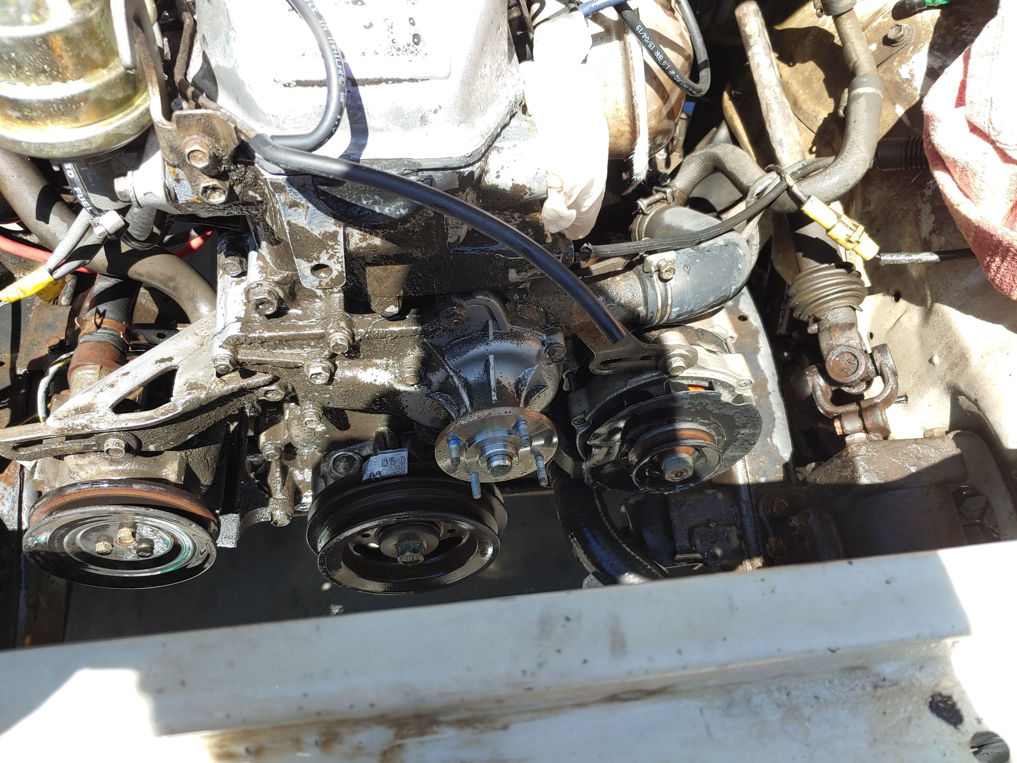

Going good , removing all the cheap tied into the from cover. Those tricky Toyota engineers oh boy. That Smog pump mount is really bolted down. They even ran the mount under one Motor mount bolt. Sneaky suckers.
I'm very pleased with myself in ordering a New Water pump too. I noticed brass shavings setting in the thermostat goose neck and thought water pump. Grabbed the pump impeller and tried moving it. Now it was not leaking but good grief what a wobble. And I can see that the altenator can stay I just had to remove the top adjustment bracket.

Looks like you're doing pretty well with it. Make sure you locate the "hidden bolt" in the head that points downwards. It's usually invisible under a pool of oil in a little "well", located just in front of the cam gear & timing chain. The bolt attaches the front of the head to the top of the timing cover. Some people miss this & when they try to pry loose the timing cover they break the cover. Also be advised that part of the head gasket extends out to the rectangular space that the timing chain goes through. If you're careful taking the timing cover off it should stay intact. I just put some very thin RTV sealant on it (Permatex Ultra Black or Toyota FIPG Sealant or equivalent) when re-assembling to prevent oil leaks there in the future. 2 years later & still no leaks.
I figured the water pump might be due for a change; nice catch on the brass shavings. That & the pump shaft wobble are sure signs that pump didn't have too much longer to live. You should also be getting 4 new studs with your water pump for the fan flange connection. I installed mine with a drop each of Loctite Red just to make sure they never backed out of the water pump flange.

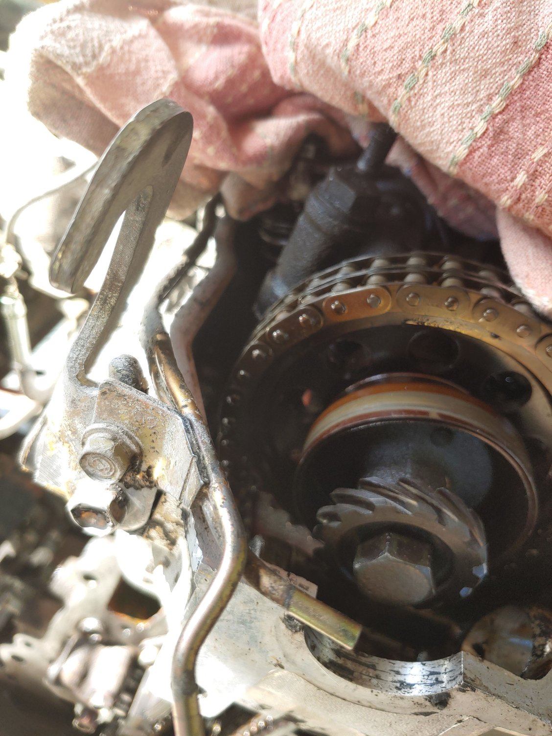

So another question. From looking at my picture is that a good sign of a Timing chain that's very worn?

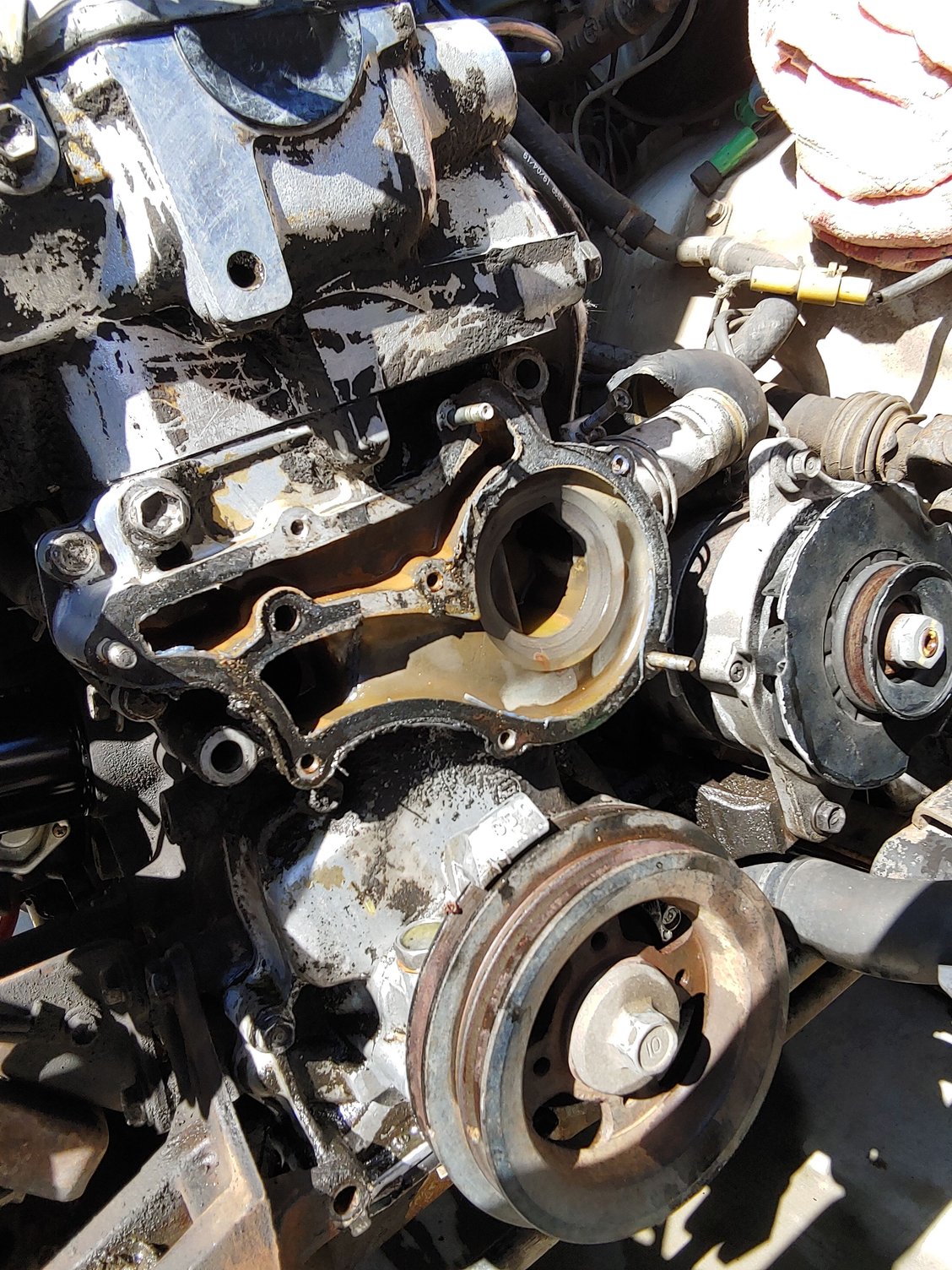

In cleaning up the engine block where the timing chain cover goes I found something odd. Either it has jumped time or the last installer paid no attention to the colored links. Crank and cam are setting right where they need to be. Or is this just the result of a Stretched timing chain?

I'll take these in order. Yes, the original oilpan gasket was cork & rubber composite, so that may be the original pan gasket. Whether you replace that or not at this point is up to you, but I'd do it. It would also give you the chance to clean out 37 years worth of crud, sludge & baked on crap on the inside of the pan & timing cover (your oil will stay much cleaner later!). It also gives you the chance to remove any loose pieces of plastic from worn/broken timing chain guides. New replacement pan gaskets are usually also usually cork & rubber composite but I have seen a few around that are Viton rubber. Either would work fine. Just remember not to over-tighten the pan bolts or you WILL get an oil leak at the pan flange. 8-10 foot pounds.
Yeah, I'd definitely say that chain is wayyyy stretched. It's that slack in the chain which causes the timing to jump around & not be consistent like it needs to be. In the pic the chain is so loose that you can push it over to touch the guide bolt. It's amazing that the guides aren't chewed up more than they are; you got lucky. At least the driver's side guide is intact so the chain had no chance to eat up your timing cover from the inside. I'm also looking at how much "baked-on" stuff is on the chain, which is a good indicator of how long it's been in use. Yep, it's due to be replaced IMO.
If the dots on the crank & cam gears are still lined up like they should be, it likely did not jump time. If the chain got loose enough to jump a tooth or two on the cam gear (most common way jumped timing happens due to loose chain), that gear would have stopped moving while the chain was not driving it, but the crank gear would have kept going. Then the marks on the gears would not be lined up. The "special color" link in the chain is only there as a visual installation aid. It's most likely that whoever did the chain last just didn't set that link on the dot on the cam gear. As long as the crank & cam are in the correct positions when the timing set is installed it will work fine. It really doesn't matter if the "special color" link is on the cam gear dot or not, just as long as the chain is engaged to drive the setup it will work as designed. For anyone wondering the answer is no, not having the "special color" link on the cam gear dot won't damage or hurt the chain or gears at all. Wear pattern & lifespan will still be the same too. This was just a slightly "sloppy" installation done by a previous mechanic.

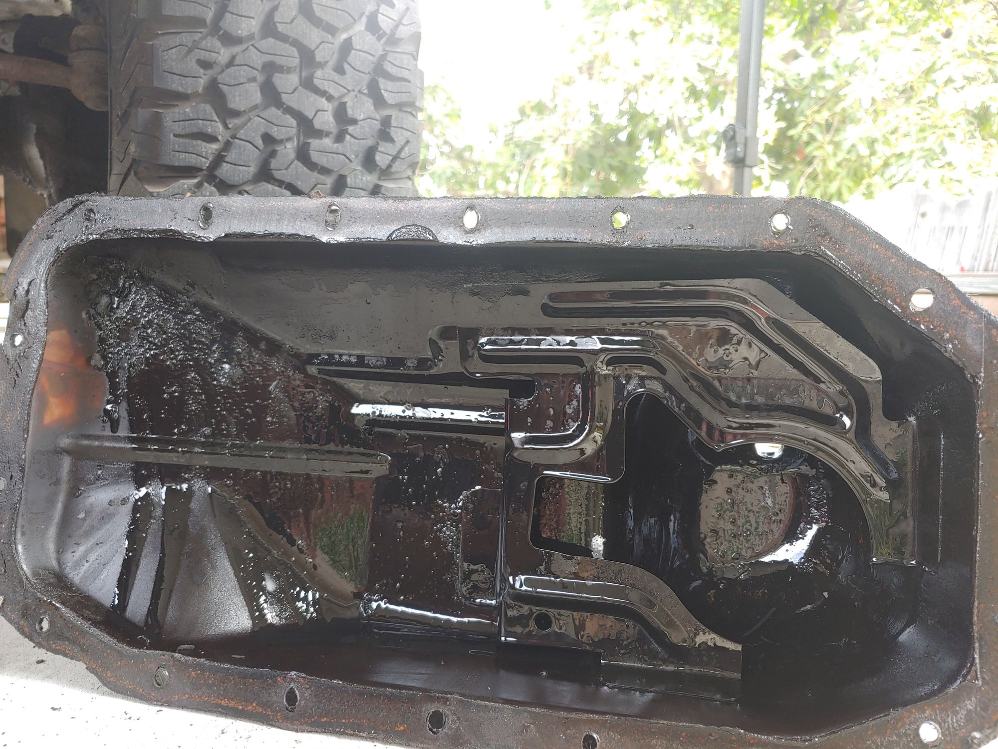

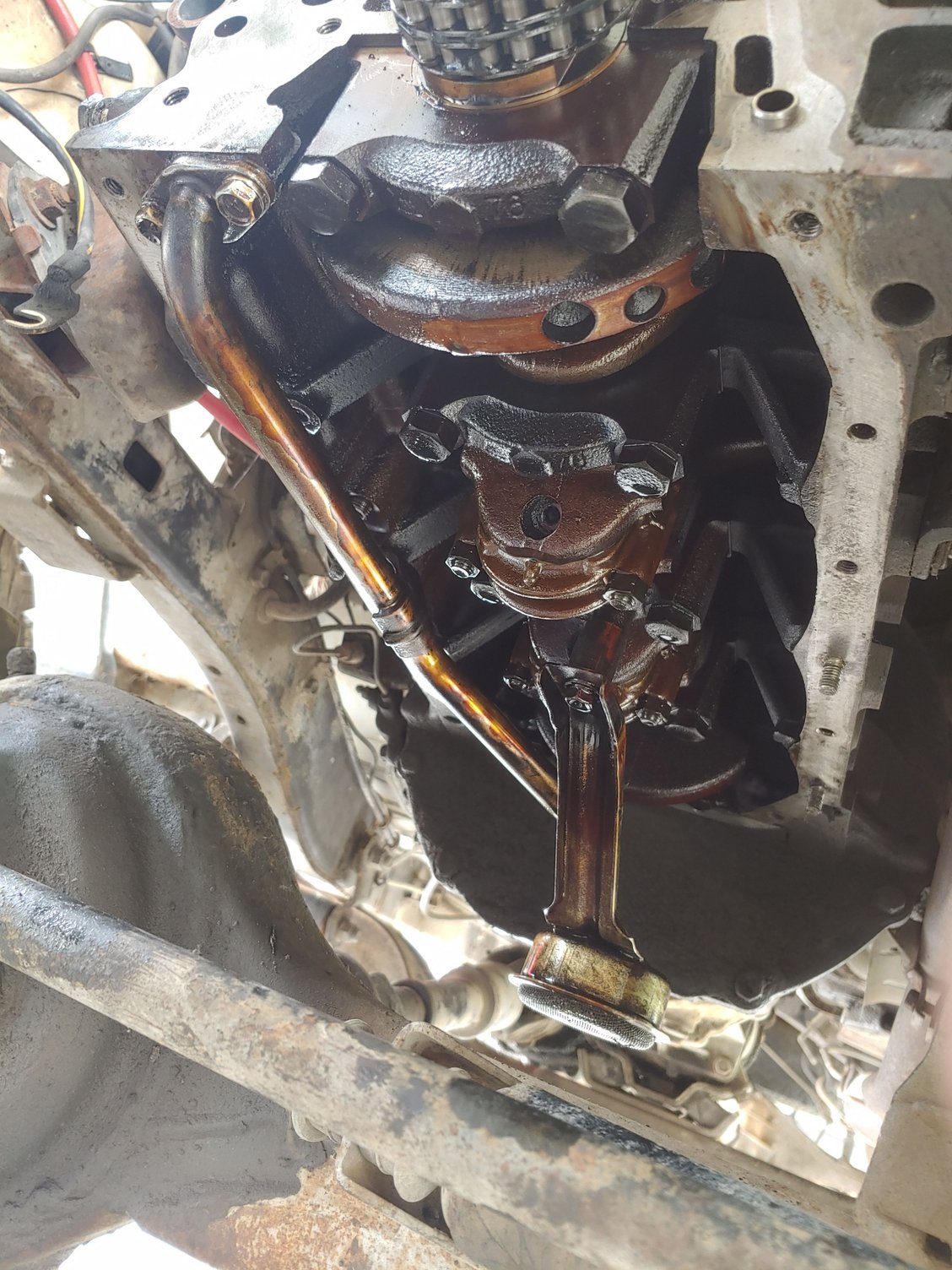

Got the oil pan off. Thanks for my trusty air ratchet. Not all that much debris in it. Only one long sliver of what may have been attached to the timing chain giude. And lots of small pieces of a silicone sealant. I hate that stuff.
A sprayed staring fluid down the oil intake port until it ran clean out of the pickup screen and then sprayed the screen too. Clean now.

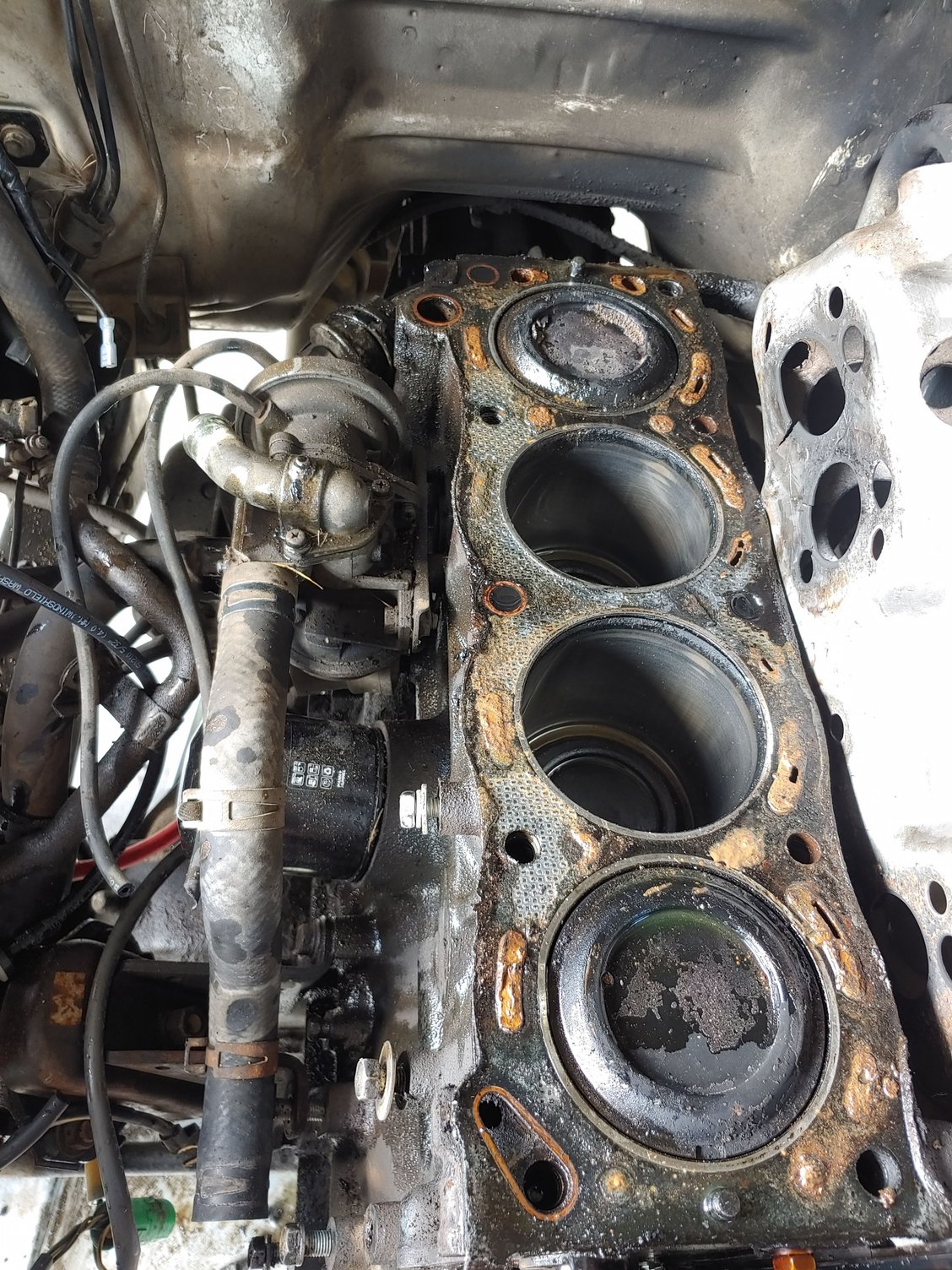

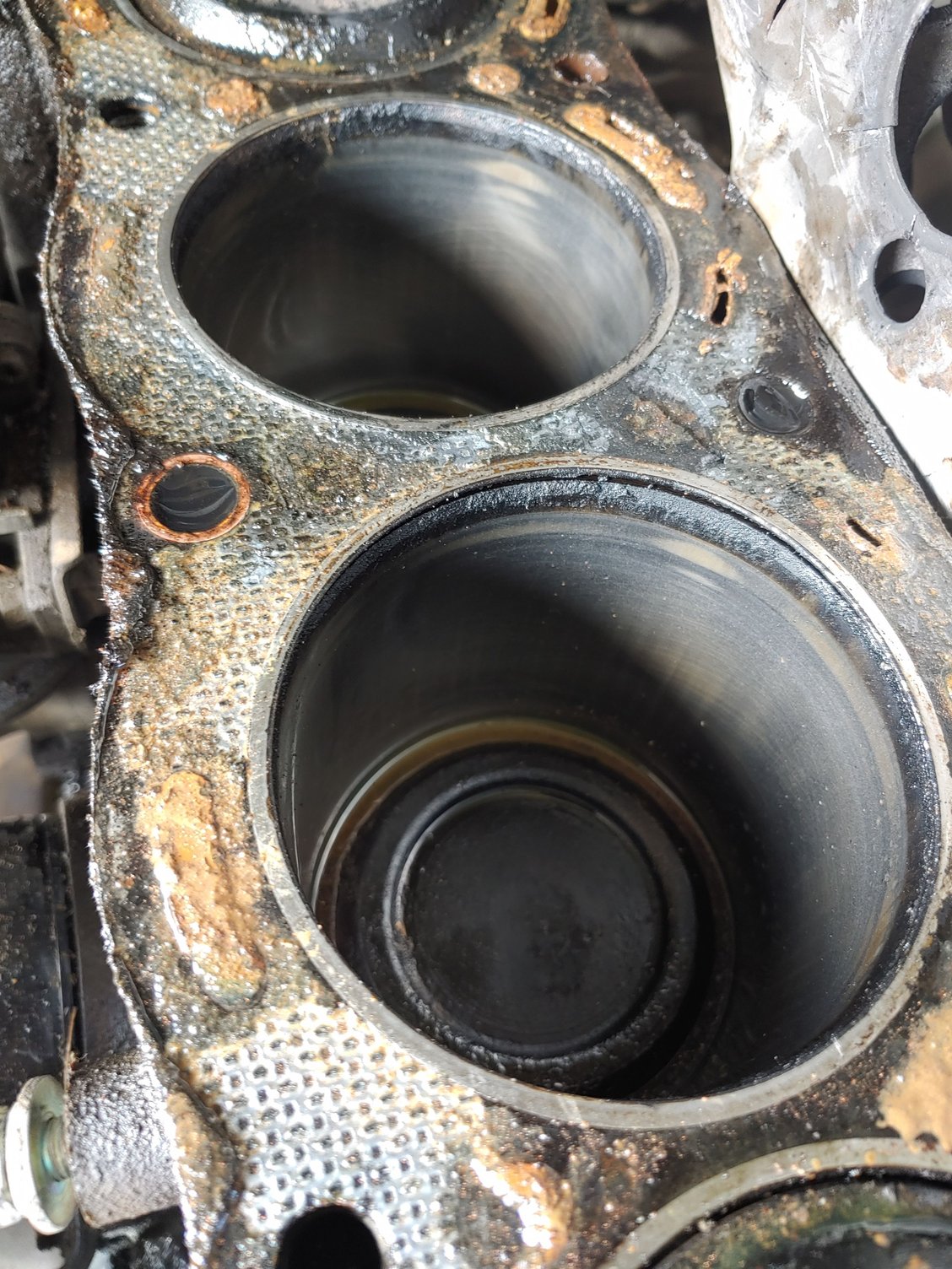

Head is off. All cylinders fail a leakdown test using gas. # 2 and 3 are in the worst condition with barnacles of Antifreeze on the valve heads. All the coolant hoses except radiator upper and lower are original as were most vacuum hoses. You can tell by looking at the coolant pipes that they did not use distilled water. I have them soaking with lime away.
Bores look good and can still see cross hatch. Bores measure OK too. So tomorrow I'll pull the piston. Order rings and a gasket set. I also found an Honest Machine Shop. He does desiel heads too. Or I can order one online.

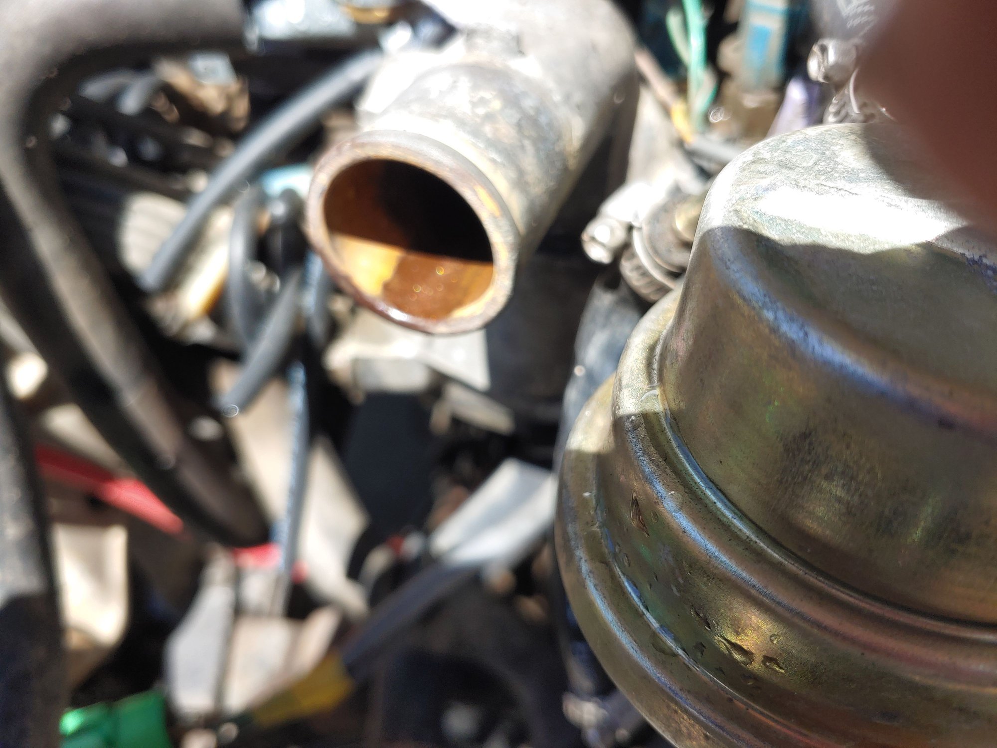

I'm looking at all the blocked coolant passages on the top of the block. EEEPPP!!!
