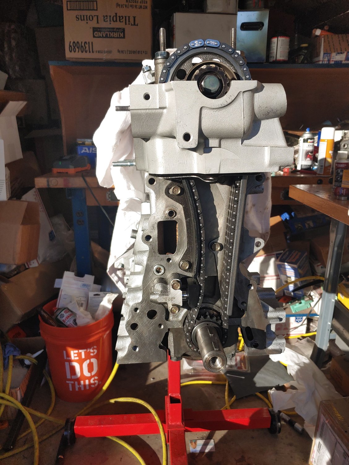

From: Ventura county Calif

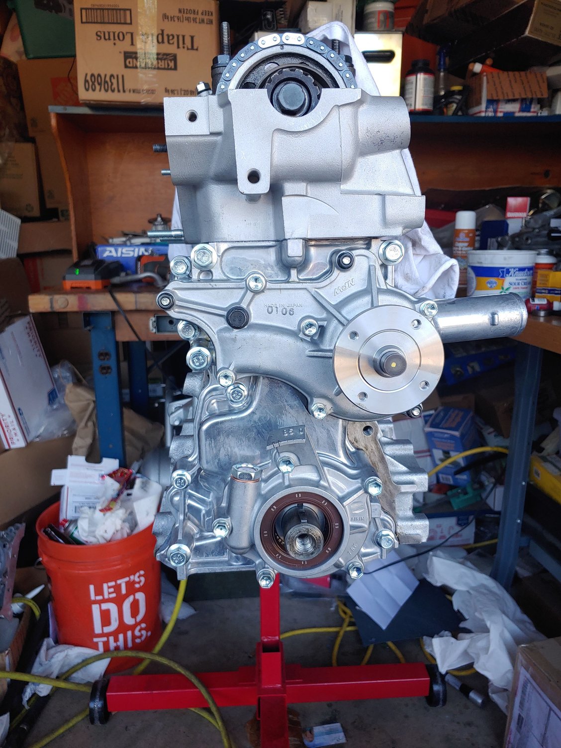

82 engine
Making great progress today. Front cover and oil pump installed. Rear seal installed and next is the oil pickup and pan. If I ever build another one I will change how I assemble it. I will put the block on a bench to do the crank install and then do the rear seal. Then onto the engine stand.

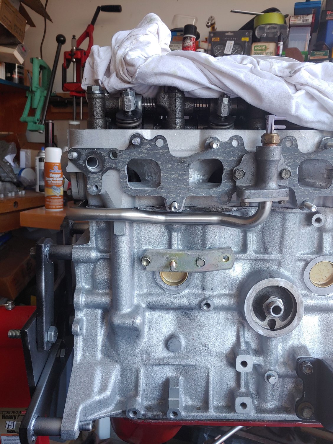

82 engine
I found out that just an O ring is used to seal that pipe. My steel pipes are not worth trying to save. So I have ordered all new stainless pipes from 22re Performance. And these will work on my truck as my heater valve was shot too. So I will re-locate my new heater valve to work with the new pipining. This new piping alone will clean up the engine compartment. Now the U shaped pipe that connects the water pump to the lower radiator hose is just that. No heater outlet. The new heater outlet will run from the water pump right side which was blocked off and go under, or behind the exhaust manifold. I checked and have plenty of room for the ne pipe. This is kinda expensive but will last for years. All post pictures of the set up when I install later this week.

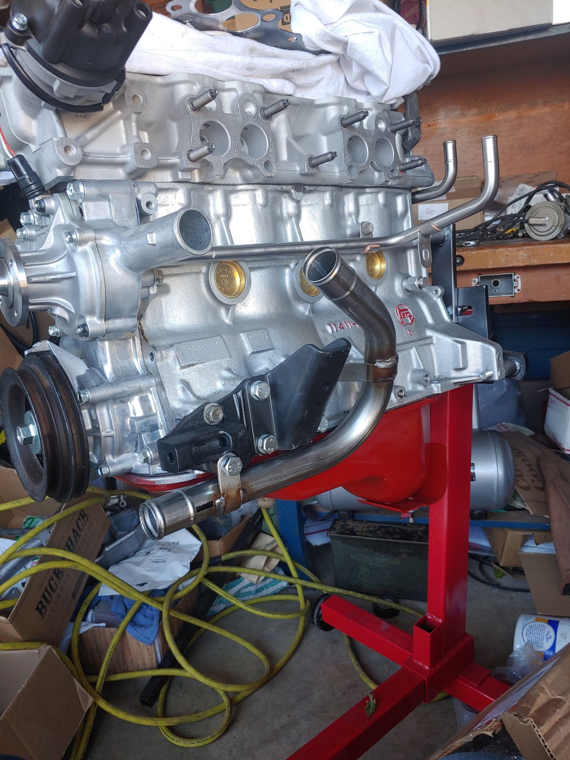

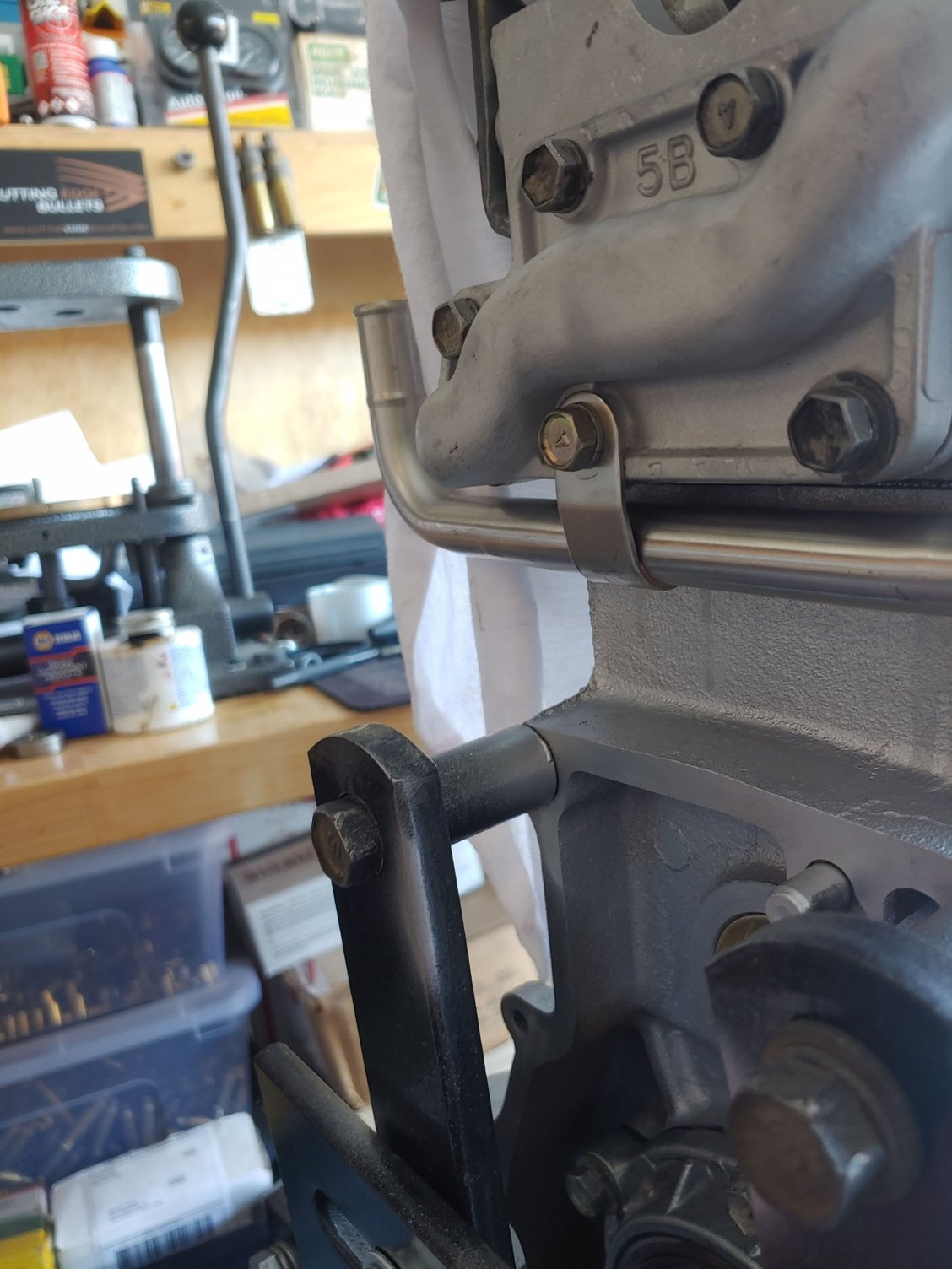

The New stainless steel water piping arrived today and all installed. No more leaks or screwing around trying to repair dead pipes. These bolted up really nice.
I had to go pick u a couple of longer bolts. These new pipes clear the exhaust manifold with no issues.

82 engine
These new pipes will work fine with my new heater valve also. The pipe on the left is the heater supply line, the right rear pipe is the heater return line. It's nice when you can find items that really do work. I purchased these from 22re performance.

And I got a great deal on Thorley CARB legal header for $422 plus 26 shipping. I will install the header one i install the engine. Don't want to chance damage.
As a side not. I did a dry fit with my old cast iron manifold to double check clearances for that pain in the rear Air Injection tube. No issues it clears my new water piping perfect and so it will on the header.

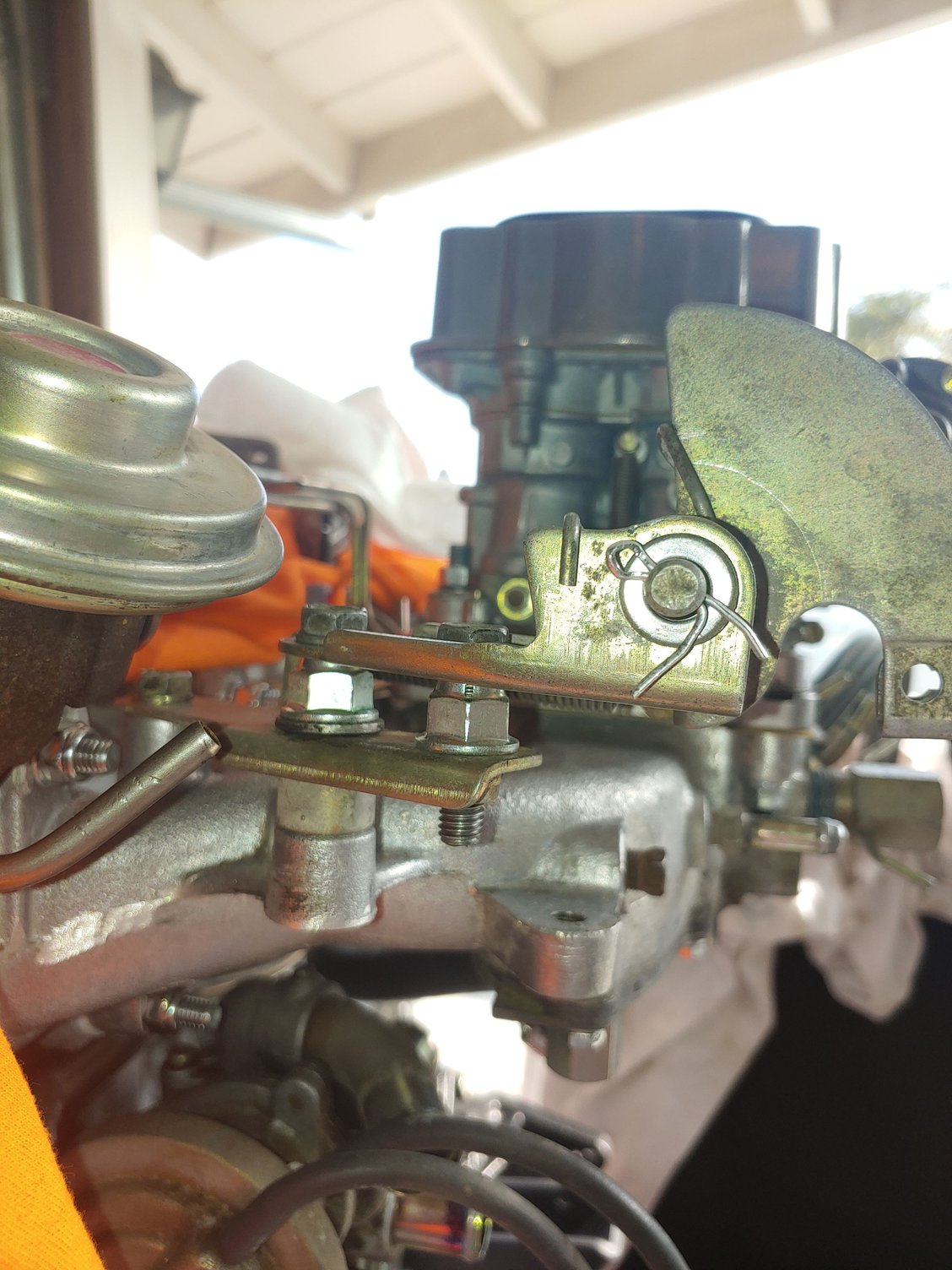

82 4x4 carb and smog
Here is a picture of my linkage mocked up to the correct height. The adapter that came with my carb was about half this high but it was enough to throw the linkage off.

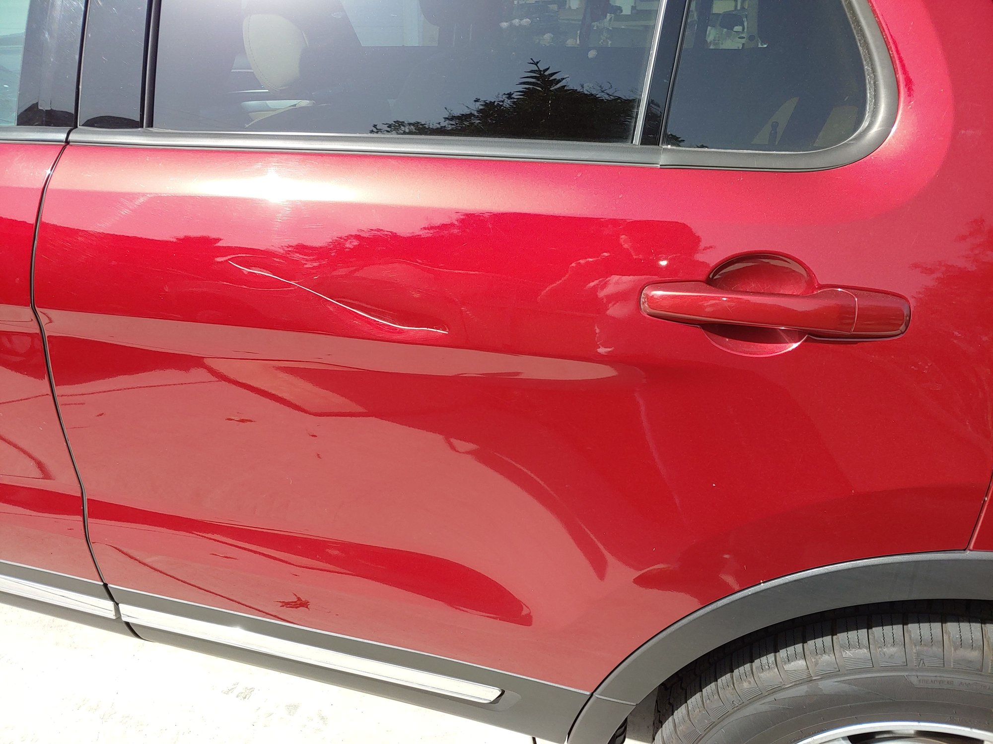

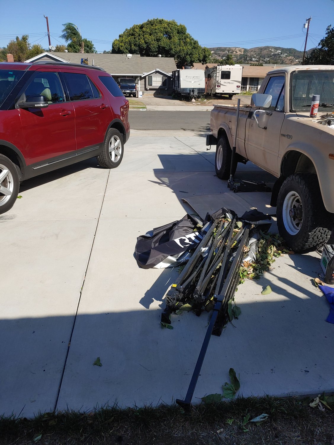

As a side issue for anyone doing work like this if you live in an are that sometimes has high winds be careful. My Toyota hood was resting at a decent angle and on the 10th we had gusts to 60mph. One gust picked the hood up and slammed it into my nice ford explorer. Cost the insurance company $3,500 to install a new door skin and paint it. Thankfully I have a low deductible for comprehensive.
wind also bent a leg on my canopy.

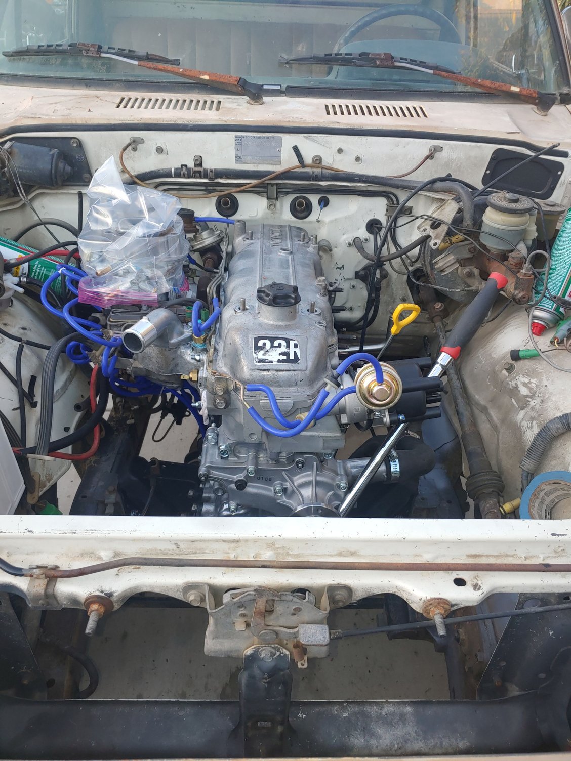

Today finished front Motor mounts. It was all lined up just had to fetch bolts.
the old valve cover is just setting there. I did not want to bigger up my new Red powder coated one. Tomorrow more work. I still have to cut out all or the old exhaust system, install starter, install new clutch slave cylinder and more.
