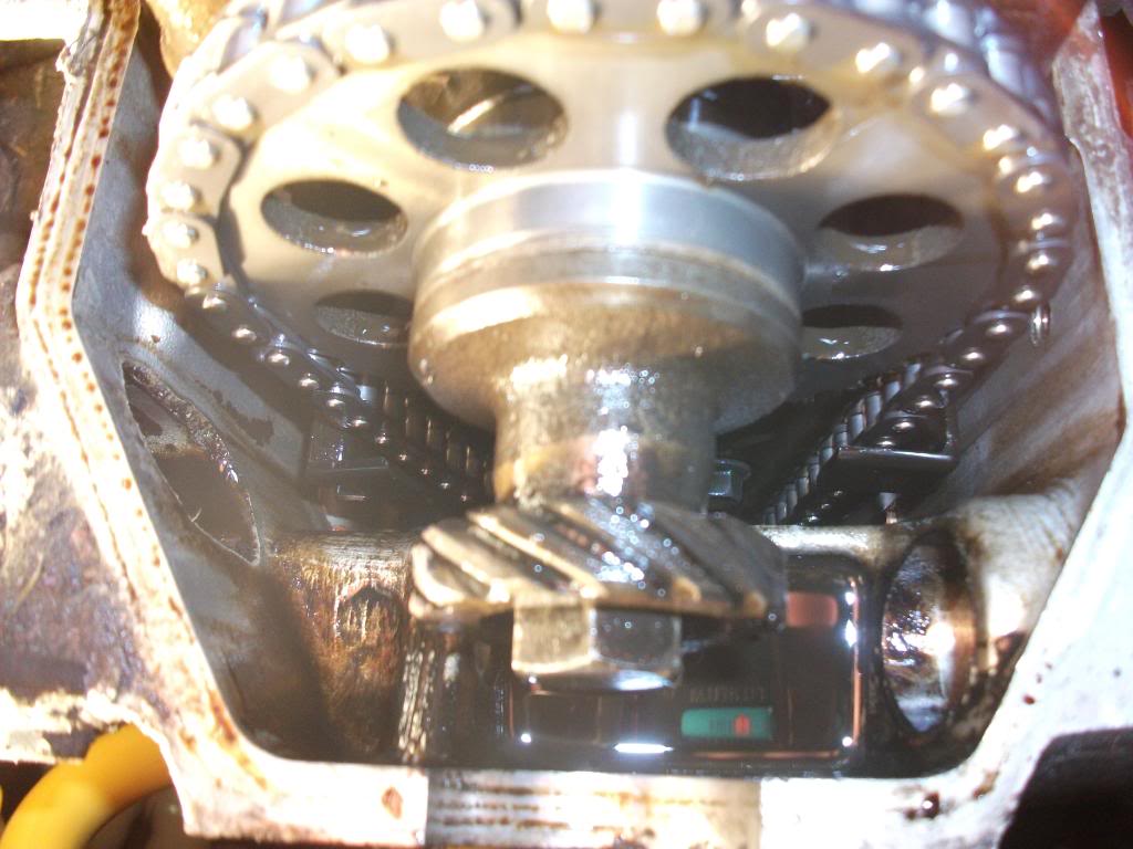

^ This shows that my chain guides are still okay I believe? I read about the known chain problem AFTER i bought the truck with a blown HG.. was scared until I pulled the VC to find them still there, lol..

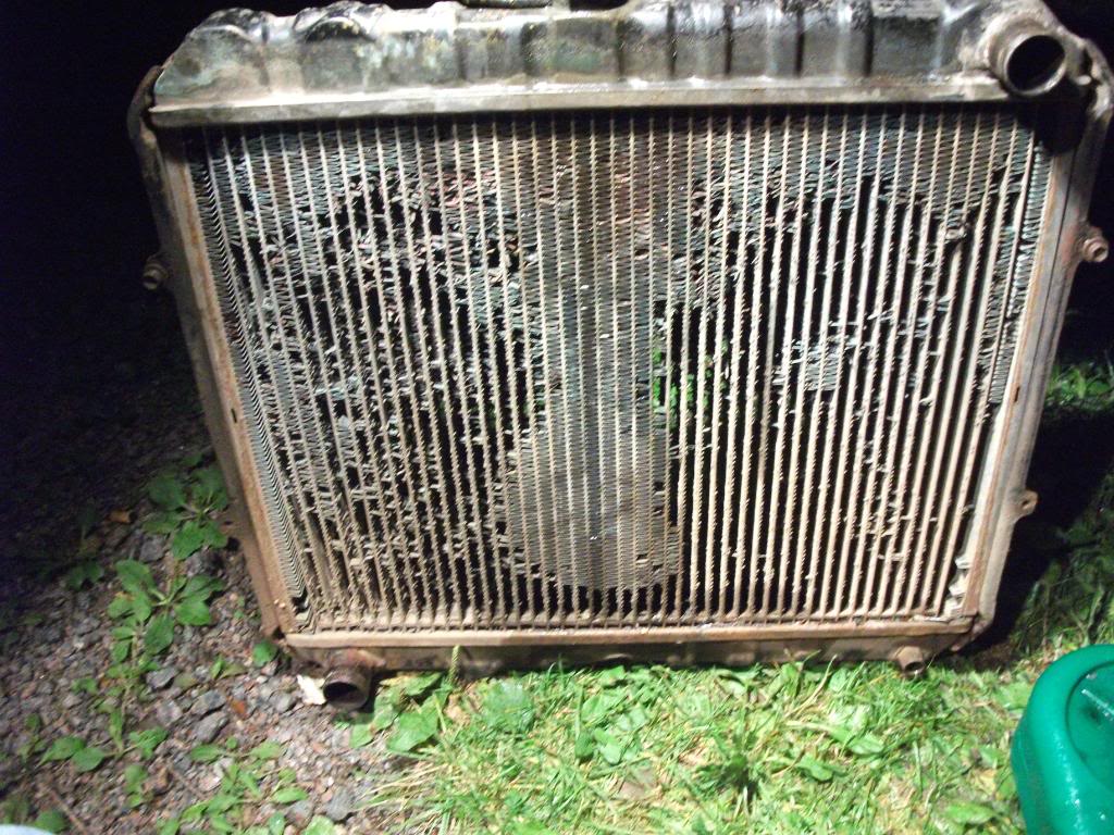

Old rad..

Do you think I should replace the chain guides even if they're fine? Also yeah replacing those things would be good. I'm looking for a couple new rad hoses, a thermostat, and more possibly. Is the water pump just a bolt-off, bolt-on replacement?

great score for $750, I would have gone with OEM head gasket, you can reuse head bolts & go with engnbldr for everything else you might need, yes be sure to undo head bolts it right order and re-torque in the right sequence, be sure distributor is at 11 o'clock position and pointing to number 1 spark plug wire connector on cap and cam gear dowel is at 12 o'clock and crank key-way is at 12 o'clock and that should be intake TDC, if you have a straight edge like a framing square use the checking engine deck and bottom of head using diagram pics in manual and check head surface area flatness with a feeler gauge and if it check out good and after head gasket gets replace and head bolts in a torque in 3-20 lbs. incriments in the re-torquing sequence to 60 lbs's also check and adjust need be the valve lash to factory specks if factory cam, and get new valve cover gasket and half moons seal bottom on the half moon and the round bolt seals and get a new PCV valve and if the grommet is hard or cracked get a new one, good luck, check my thread for info and any questions let me know, just re-did mine, Later!!!!
Ps. Are you going to do anything else but head gasket? engine looks really filthy, not good for a cool running engine.

To advance to TDC on intake so cam dowel is at 12 o'clock and distributer is pointing at the number one spark plug wire goes in on the cap, that is TDC, if it's pointing at number 3 spark plug wire plug in the it's at TDC at the exhaust which you don't want, I would use the crank bolt it has a higher weight mass and will turn the small cam easier, and when the cam dowel is at 12 o'clock the crank keyway will be at 12 o'clock too, in your manual it all should be shown as well as which rocker is loose at TDC on intake and and which ones are loose at TDC on exhaust and what the valve lash should be and you need to pick up a feeler gauge set at Sear or NAPA to check valve rocker gap and deck flatness and it can be used to gap spark plugs, need to be in everyone's tool box!!!!
Get a timing chain set with the straight left side steel guide, Auto Zone sells the steel guide called a damper for 13 bucks if your going to re-use the old set which you shouldn't since your replacing everything anyway. Engnbldr has a set cheaper with the steel guide. Read my thread...

you mentioned i should replace with a steel guide since im replacing everything anyway. but i find myself 3 hours before everything closes, and thinking, i only need this to last the winter. I will have a second vehicle in the spring, and then I will be able to tear down the engine again, and NOT be outside in the freezing cold doing all this.. So i'm thinking I will just get this head gasket in, reaplace all the gaskets that came with my set. Replace T stat, and get a feeler gauge. I'll keep an eye on the T-chain and guides. Next spring/summer i'll make everything sparkly pretty.

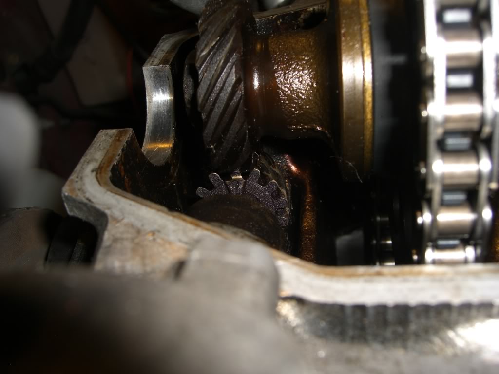

here's the way to line up the distributor:
https://www.yotatech.com/forums/f116...l#post51710590
line the "notch" tooth straight up, and let it turn as you push the dizzy in
wrong:
right:
