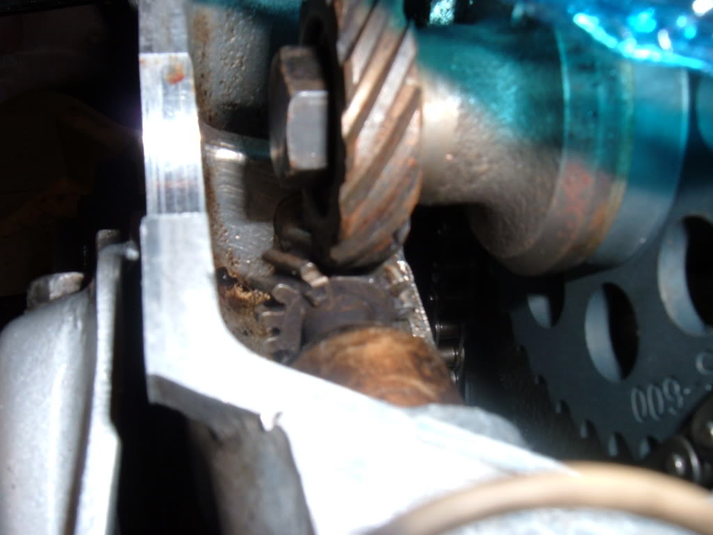

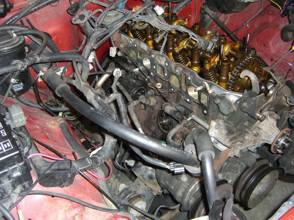

Alright, so I've been reading online for weeks, hours upon hours, about tearing down the 22re engine. I'm only 19 but do have experience working with Hondas.. I'm putting my honda away for the winter this year, and so I picked up a 1989 pickup 4x4 Xtra cab.. 22re, for $750 with a blown HG. I figured they're solid engines, more power than 22r, but fuel efficient for travelling to school and work.
Anyways, I feel like I'm in so deep with this, I've been trying to keep things marked and organized. I've got the exhaust manifold unhooked, resting aside, same with the intake manifold, since the wiring harness is running through it. I set TDC, and removed the distributor after marking the rotor. (I think I did that right) I believe I need to remove the timing "chain" (I've only worked with belts, lol) and then unbolt the head in the correct sequencing..
I'm following a Haynes manual as well, but its not very specific. Also I'm located in Atlantic Canada, so things like Autozone, and most online part sites don't really work for me. I picked up a Headgasket kit at Napa here for about $80, I'm hoping to re-use the head bolts. I don't really have any help besides you guys and the Haynes manual, lol. Should I be removing the timing chain next? I've got a some pics, this is how far along I am. I also picked up a replacement rad (the old brass kind) good condition for $40

^ This shows that my chain guides are still okay I believe? I read about the known chain problem AFTER i bought the truck with a blown HG.. was scared until I pulled the VC to find them still there, lol..

Do you think I should replace the chain guides even if they're fine? Also yeah replacing those things would be good. I'm looking for a couple new rad hoses, a thermostat, and more possibly. Is the water pump just a bolt-off, bolt-on replacement?

great score for $750, I would have gone with OEM head gasket, you can reuse head bolts & go with engnbldr for everything else you might need, yes be sure to undo head bolts it right order and re-torque in the right sequence, be sure distributor is at 11 o'clock position and pointing to number 1 spark plug wire connector on cap and cam gear dowel is at 12 o'clock and crank key-way is at 12 o'clock and that should be intake TDC, if you have a straight edge like a framing square use the checking engine deck and bottom of head using diagram pics in manual and check head surface area flatness with a feeler gauge and if it check out good and after head gasket gets replace and head bolts in a torque in 3-20 lbs. incriments in the re-torquing sequence to 60 lbs's also check and adjust need be the valve lash to factory specks if factory cam, and get new valve cover gasket and half moons seal bottom on the half moon and the round bolt seals and get a new PCV valve and if the grommet is hard or cracked get a new one, good luck, check my thread for info and any questions let me know, just re-did mine, Later!!!!

Get a timing chain set with the straight left side steel guide, Auto Zone sells the steel guide called a damper for 13 bucks if your going to re-use the old set which you shouldn't since your replacing everything anyway. Engnbldr has a set cheaper with the steel guide. Read my thread...

That looks pretty messy in the front. If you're still only using the hayne's manual, then here's some resources for you that I've used in the past and currently. Make sure you look for the 22RE info and don't mix up with the 3.0 stuff.

My cousins coming down for the weekend, we're going to get a lot of work done, is the plan. Right now im trying to buy the parts we'll need, while everythings closed the next 3 days.

you mentioned i should replace with a steel guide since im replacing everything anyway. but i find myself 3 hours before everything closes, and thinking, i only need this to last the winter. I will have a second vehicle in the spring, and then I will be able to tear down the engine again, and NOT be outside in the freezing cold doing all this.. So i'm thinking I will just get this head gasket in, reaplace all the gaskets that came with my set. Replace T stat, and get a feeler gauge. I'll keep an eye on the T-chain and guides. Next spring/summer i'll make everything sparkly pretty.

sounds like a good plan, especially if you don't have a garage to work in.
