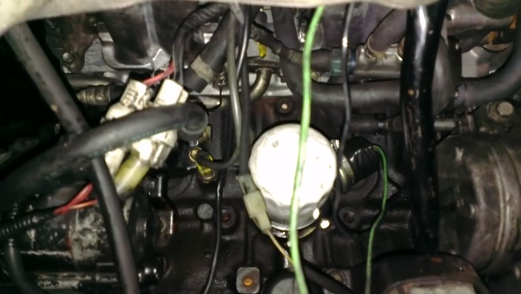

Thanks Ian - it was M6x1.00 - perfect fit.
Pretty bad shot with the oil pressure sender wire in the way, but here it sits with new studs and nuts:

you mean this pic?

Yep! Had some wifi issues when I posted this today - that's it!
I have a leak now though, from that pipe (I think) where it cross behind the head. I filled up with water (no engine start yet) and have a small leak:
