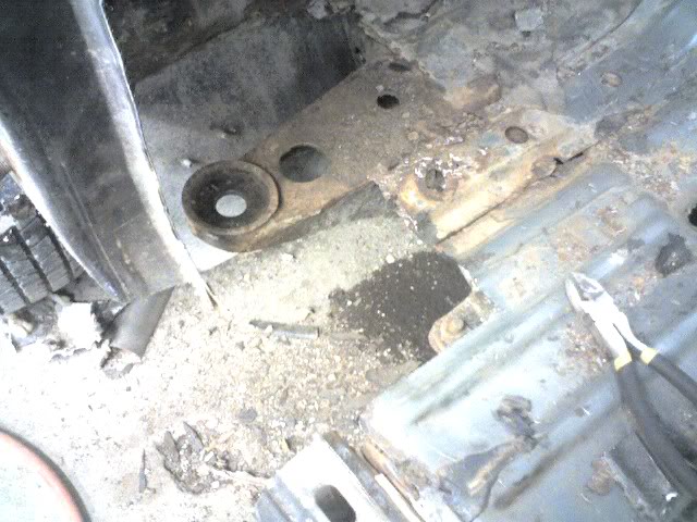

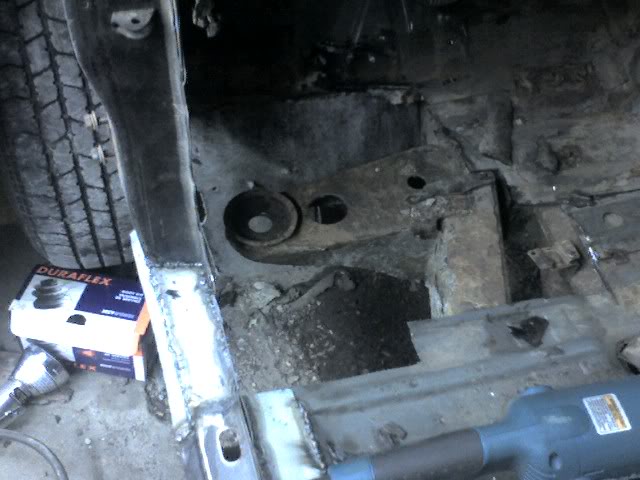

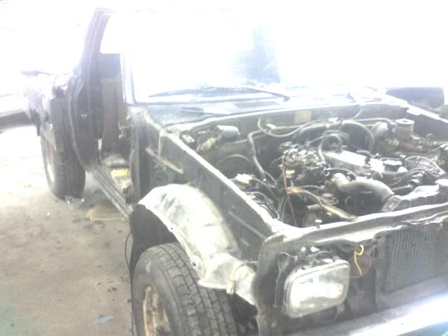

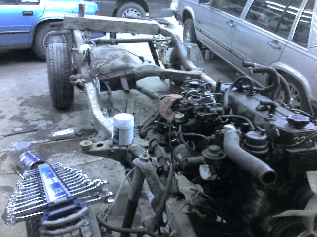

ok so i finally got my truck into the shop and i have started dissasembly, sorry these pics are very crappy but the next ones i hope will be better
ok so got all the fenders off, hood off, the doors and the interior. i pulled up the carpet and found a nice surprise, the rear cab mounts rusted right through the floor and that is why my cab always looked to be leaning back a little the front is good, my rockers are alright and ya, so i picked up a HUGE peice of sheet metal for 60 bucks and on monday i will start fixing floors and stuff

lookin' good and keep going.
better pics are a must !! ..

ya, i only had my phone on hand, but monday i will get more, and better pics with a actuall digital camara lol i just got paid today so monday i will be ordering new fenders, hood and some other things maybe new springs and mine are bowing the opposite direction as they should be

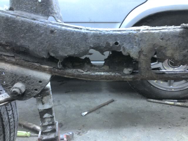

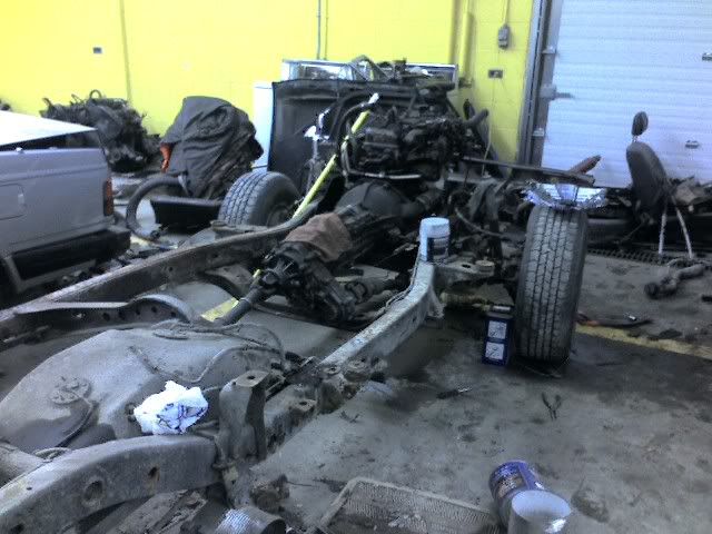

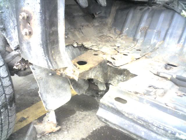

well, i got some more work done on the old girl today, and it all had to do with a swasall and a hamer and a drill
had to cut out ALLLLLOOOOOTTT of cancer today and it consisted of most of my rocker and the body mount and some other stuff

Looks like a newer 22r, or at least the valve cover

Oldgold, yes, the 22r is a newer one, came outta a 84, the origional motor had 409,000 km on it and it was dead so the PO swaped in a newer one from a parts truck only to find out she knocks, so its time to rebuild her,
4banginrunner, yea man 1 gen rust repair is SOOO much fun(that was sarcazim) i what i cut out of there, i have to try and fabricate ALLL new with just your basic hand tools, and a welder, should be fun none the less hehe, at least the other side is good so i can copy from that

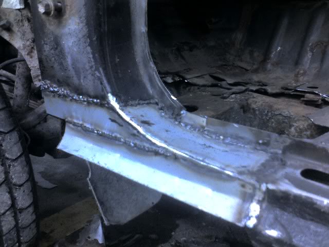

hahah, ya no kidding eh, well i got some more work done today, i am very happy with the way this turned out i just need to grind down the welds

nice job on that rocker repair...looks great..

NICE WORK!!
Thats amazing! I wish I could weld that good. That's going to be a nice truck!
good job.

THANKS EVERYBODY FOR THE COMPLEMENTS, ya, the key to welding sheet metal is to NOT try and make one continuious bead, but MANY tiny spot weld all very close together, it makes it look like a bead, but it has less heat and wont warp your metal
oh and by the way, all metal work i do, is with a ballpeen hamer, diegrinder and a bench vise
