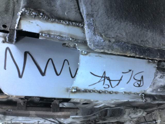

well, i got more work done on the old yoter today, cut out all rot on the outer drivers side frame, and started building inner rockers and outter rockers
the frame is starting to be quite a job, i have a 85 frame here also thats in a little bit better condition, can i just use that one or do i have to keep fixing the one i have
here is pics

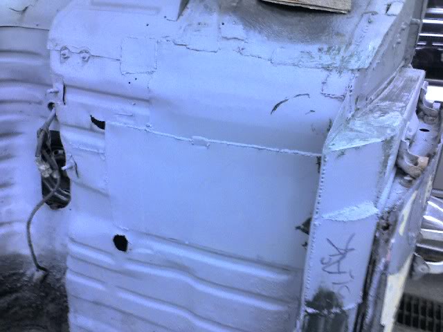

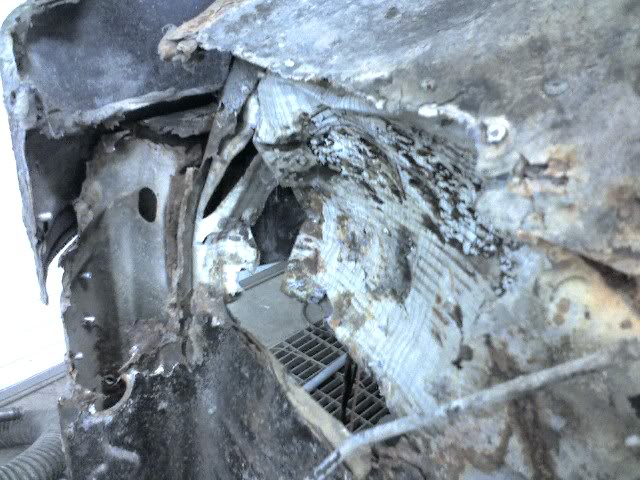

got some more work done today, i finally finnished the drivers side part on the cab, now to do passanger side and rear cabcorners
BEFORE!!!

Old Dec 10, 2008 | 06:23 PM
  #27
scooper's Avatar
Posts: 278
From: Columbus Georgia
For a man with limited tools you are doing a great job, and you welds look pretty good too. I love a good project and seeing it progress from one thing into another.
But.. I have to be honest, with all the rust that I have seen in the pictures and then the frame, i'd scrap that truck or put it to the side as a parts donor and find another one in a bit better shape to start off with.
You are doing good work so far, im going to keep an eye out for this thread. Best of luck and keep the pictures coming!

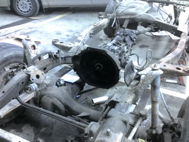

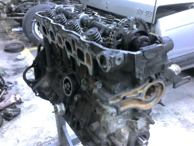

so the brand new frame is a no go, but i got all the peices to fix it cut out and just to try and roll the frame and stuff to the 220 welder so i can do a nice job, i am scared to try fixing it with the 110 gas welder on high power might not be enough, but anyways i got the motor pulled and almost striped
another thing, i pulled the oil pan and check bearings, and 2 of the 4 there is NO bearing left on the rods, so i need a new crank and 2 rods, i drove it like this for about a week hehehehe just after i bought it. so since i am very low on cash, i am ordering a engine rebuild kit off ebay, its like 360 bucks for new pistons, bearings, freeze plugs, oil pump, water pump, ALL gaskets wrist pins, wrist pin clips, and i am gonna try and order a header, webber, and a nice cam for it as well

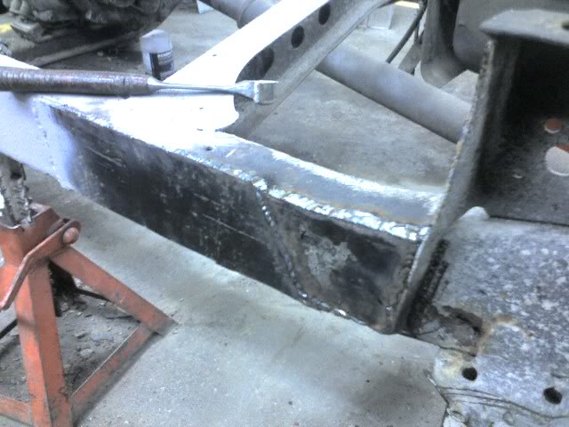

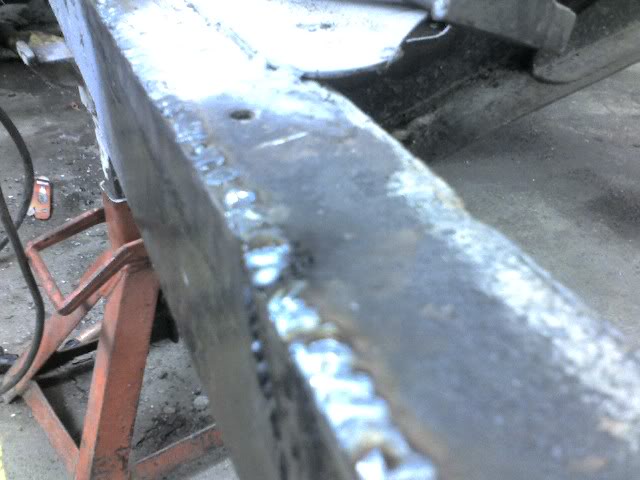

yea i know, it sucks. but i am starting to work on the frame, some of you guys might be like, WHAT!, but its the only welder i had or could use. so i used the 125 gas welder on high heat and a nice slow wire speed. it turned out very nice, but will it hold?, here is some pics
