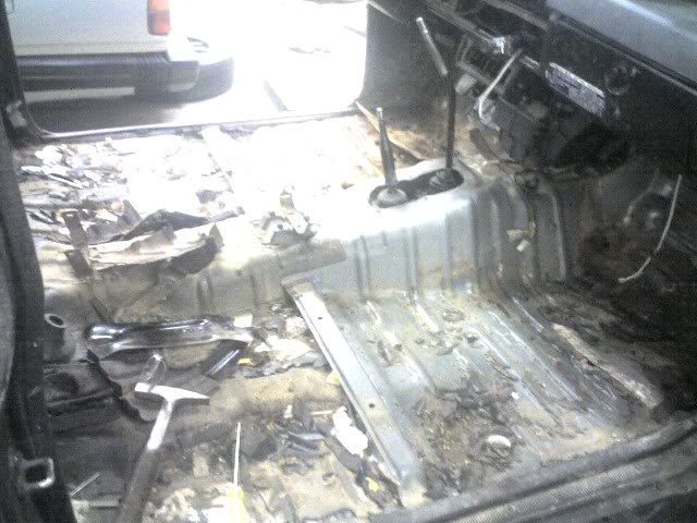

ok so i finally got my truck into the shop and i have started dissasembly, sorry these pics are very crappy but the next ones i hope will be better

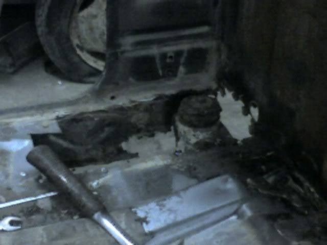

ok so got all the fenders off, hood off, the doors and the interior. i pulled up the carpet and found a nice surprise, the rear cab mounts rusted right through the floor and that is why my cab always looked to be leaning back a little the front is good, my rockers are alright and ya, so i picked up a HUGE peice of sheet metal for 60 bucks and on monday i will start fixing floors and stuff

lookin' good and keep going.
better pics are a must !! ..

well, i got some more work done on the old girl today, and it all had to do with a swasall and a hamer and a drill
had to cut out ALLLLLOOOOOTTT of cancer today and it consisted of most of my rocker and the body mount and some other stuff

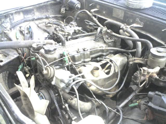

Looks like a newer 22r, or at least the valve cover

Oldgold, yes, the 22r is a newer one, came outta a 84, the origional motor had 409,000 km on it and it was dead so the PO swaped in a newer one from a parts truck only to find out she knocks, so its time to rebuild her,

nice job on that rocker repair...looks great..

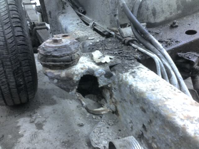

did more work today, got the cab off, and started cutting rotton cab mounts off, and i also started hiting frame with a hammer to find how much rust(rot) there actually is and well, the pics speak for them selves, so if anyone has a GOOOOD frame for a 82 short box for cheap, shoot me a PM we can figure out shipping.

wow, that might just be the worst frame rot ive seen, and i dealt with a lot of it. i guess that the prairie road salt for you. good luck with the search

yea, it wasent that bad when i bought it, till i started hitting it with a hammer. i am going to keep on cutting out the rust and fixing it until i can find a new frame i would also consider a long box frame, but it would have to come with a longer drive shaft, what would be the best welder to use to fix the frame, a 220 volt miller gas welder, or a miller stick welder OR a miller tig welder?
