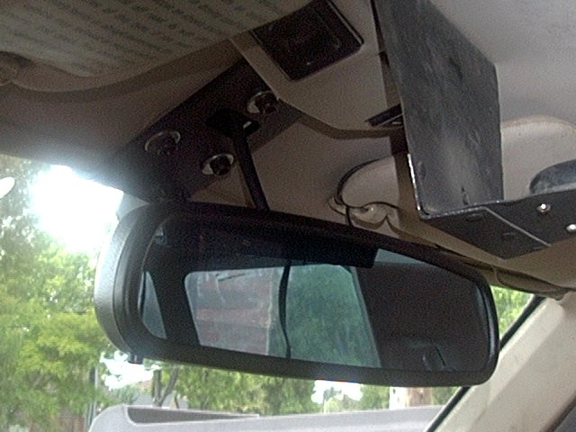

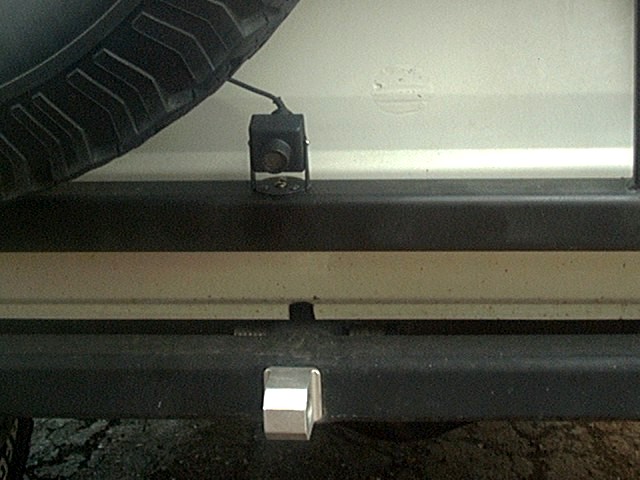

I put one on my 1st gen a month or so ago. Works great, camera on the tire carrier:
Video screen in the rear view mirror:
