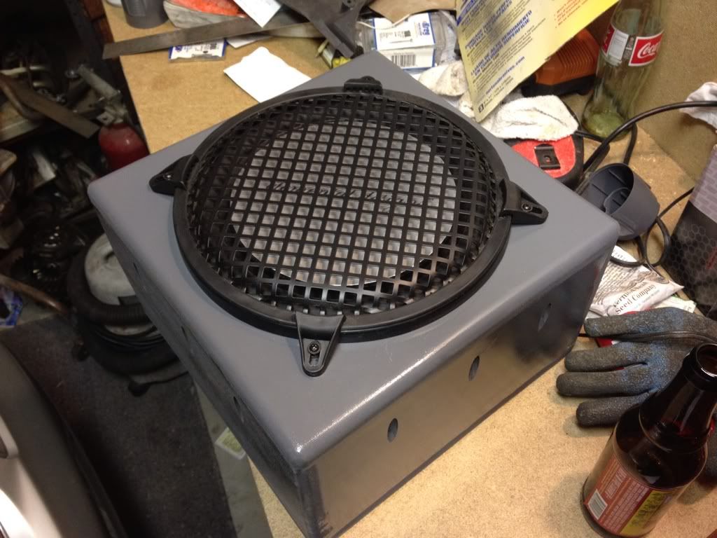

I wasn't able to find enough room... I am using an Elemental Designs slim 10" I built a sealed box for

fancy schmancy! pocket holes, bull nose edges....nice touch.
