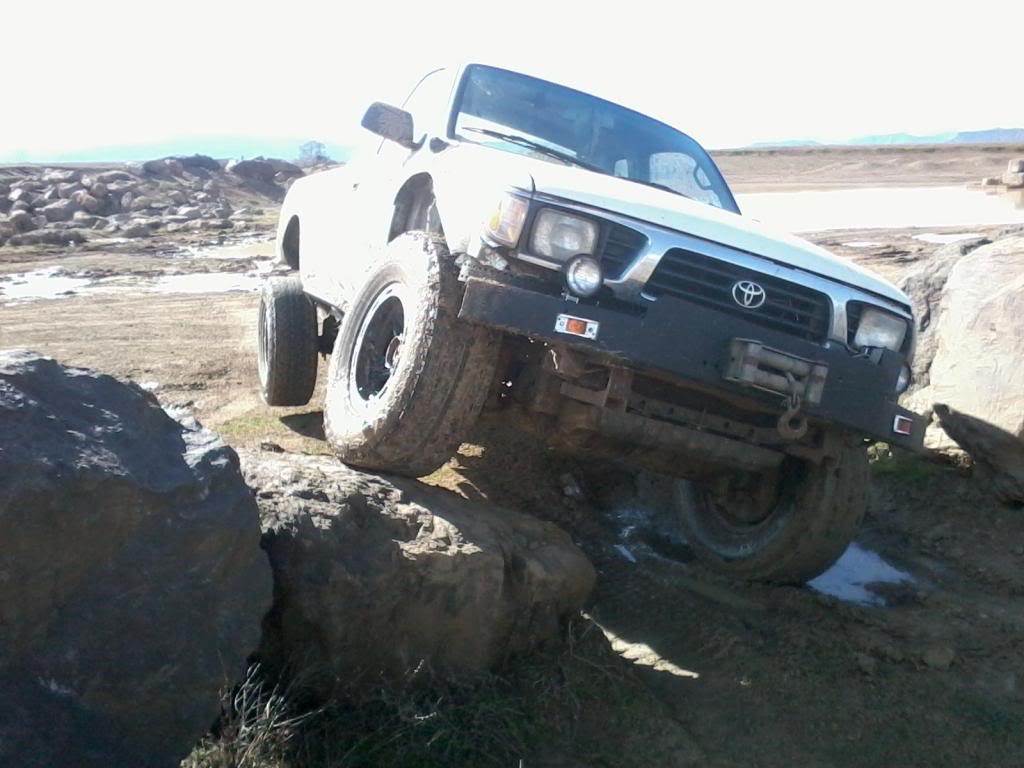

ok so i went out yesterday and tried to rip the rockers off on some boulders after hearing all of the thoughts of them not working i figured if i succeeded in tearing breaking or bending them ide add at least one more leg. but they held up just as i had thought i actually tried to inflict damage and slammed down with force directly on the slider on a couple different boulders and they just slid me right off. on one rock i actually high centered myself on my slider and got stuck for a couple minutes since i dont have lockers yet the 2 tires on that side were just spinning but i managed to eventually work my way off. so after withstanding the beating with only scratches im sure theyll be fine. and i was wrong about the thickness i checked a scrap peice i had and it is 3/16 and its hard to tell from the pictures but the support bars are plated and braced along the top to prevent any bending upwards with 4 bolts off each leg attaching it to the frame. and ya i guess i never really noticed the u-bolts ill have to hack those down thanks. unfortunantly i didnt get any pictures of my rockers when they were slammed onto the rocks but this is one of the rocks i drove forward off of and let the slider smash down hard instead of tryin to ease it. ill try and get some pictures of the sliders up on a boulder soon but thanks for the tips some of it has been helpful
