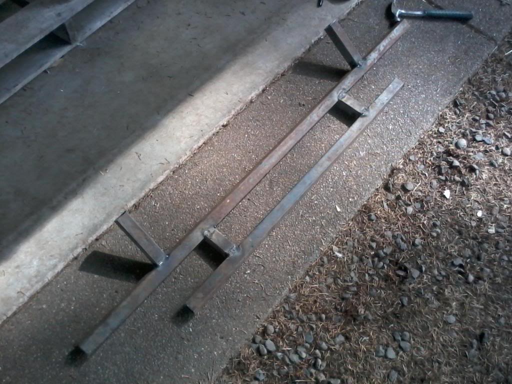

just finished fabricating and installing my rock sliders. i used 1.5in. square tubing, wasnt sure at first how it was going to turn out but i like the end result what do you guys think?

anything is better than no rocker protection - especially on an x-cab. personally i would add one more leg to the frame - but i'm of of those who put 4 legs on sliders that only came with 3

Thanks guys... and ya i was thinking about adding a third it seems like there plenty stout without it but i still might do it later... better to go overboard than not enough

This. Little late now but plating the frame would have been a good idea too.
Whats the thickness on that box tube?

Look good... personally I'd have gone bigger like 2" sq. and set them flat to use as steps to get to the roof but that's just me lol... I'd have gone for the extra leg too.

Plus one on the extra leg. They look good though

You might wanna add 2-3 more out riggers per side.....

They look good man. For future reference (or anyone else thinking about using the square stuff) if you turn the longest piece going along your truck so the corner is down rather than the flat side down it is stronger, can take more impact, and less surface area dragging across things.
A lot of people build hybrid sliders (what I have) with the legs and base slider being square and the guard that sticks out being round tube.
Square steel taking a hit on it's corner is stronger than round tube and lighter. Win, win.

How are they mounted to the frame? What size of tubing did you use?
They look mighty close to your door, if you ever feel they've been bumped, you better open your door slowly so you don't damage it.

haha wow... the legs are welded to a 1/4in plate with an angle brace on top of the foot going to the top of the 7in. tall 1/4in. thick plate for support then bolted to my frame thanks for the complements those of you who had good things to say and for those who think they wont work they are stirdy i tested em with a high-lift and they have already been tested offroad as well tall waterbars mostly some rocks but steel is stout wheather its round or square as long as its a resonable size and your welds are strong. they do have a slight flex in them so i might still add one more leg for support just in case i dont think thats a bad idea at all but they serve there purpose still not just looks

o and thickness of tube is 1.5in. square and i believe 1/8 thick steel

then DEFINITELY add at least one more leg to each side. usually when people choose square tube to make the legs of their sliders - they use 2" x 0.25" wall for strength, as 0.125" wall isn't very strong for structural items such as sliders or bumpers. as for your testing method with a hi-lift jack - that's not really going to tell you much other than you can dead-lift your rig from them. most likely in the event of an impact with momentum behind it (like when your rig slips off a rock, drops several inches and lands on the slider), it will most likely bend. if you're lucky, they will not become damage multipliers which may turn your truck into the General Lee (enter/exit through the windows).
they'll probably be fine until you decide to venture into more hardcore stuff - but then again with an x-cab they'll be more likely to be used than sliders on a shorter wheelbase rig. having them be bolt-on like you've described was probably smart if you decide to upgrade later.
