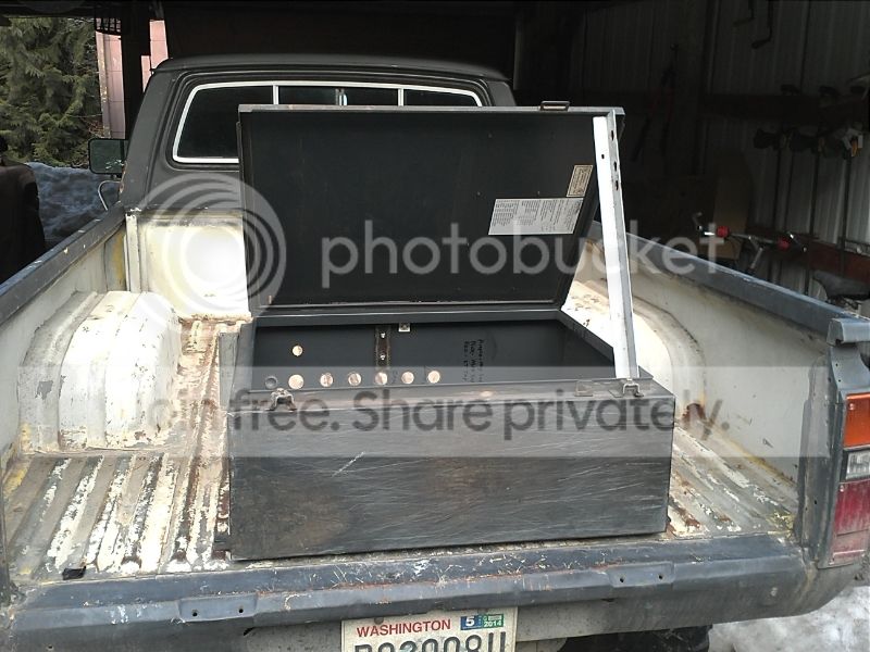

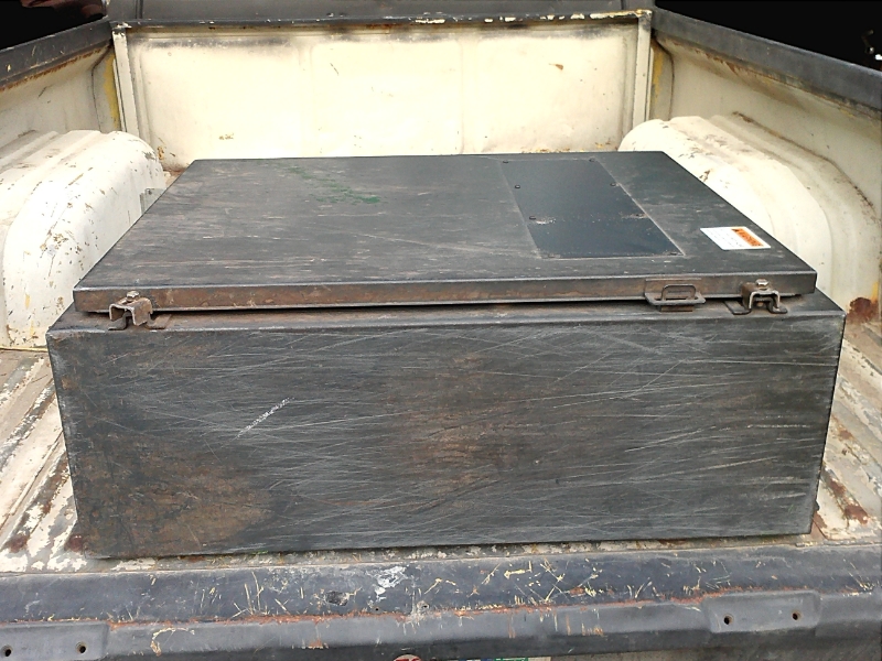

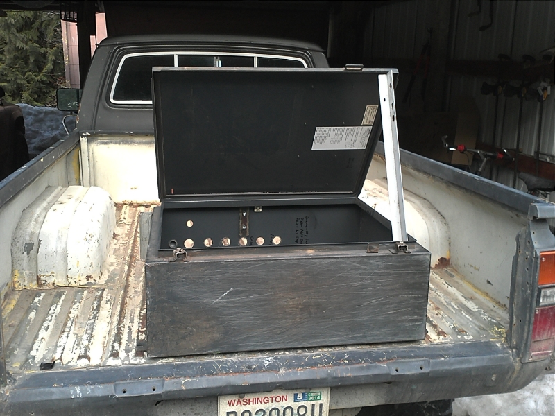

Small update. I scored this electrical control panel the other day from work. They had upgraded a bunch of equipment a couple months ago and were going to throw it in the scrap bin, my boss let me take it. I think after plugging the holes were the conduit came into it, I'll mount it to the trailer tongue and use it for lockable storage. It's got a pretty durable finish, I'll probably respray over it, just to pretty it up a bit. The way its sitting on my truck it measures 30' wide by 24" tall by 10" deep.

That's a fantastic idea! Mite be a good idea to put some weatherstrip under the lid to make it waterproof.

Thanks, I love scoring free stuff, lol. Its hard to tell in the pic, but the lid does have weather stripping in the small channel, its in perfect condition too! I lucked out the way the holes are placed, when I mount the box to the trailer tongue, that side will be up against the front body panel, so the holes won't even show.

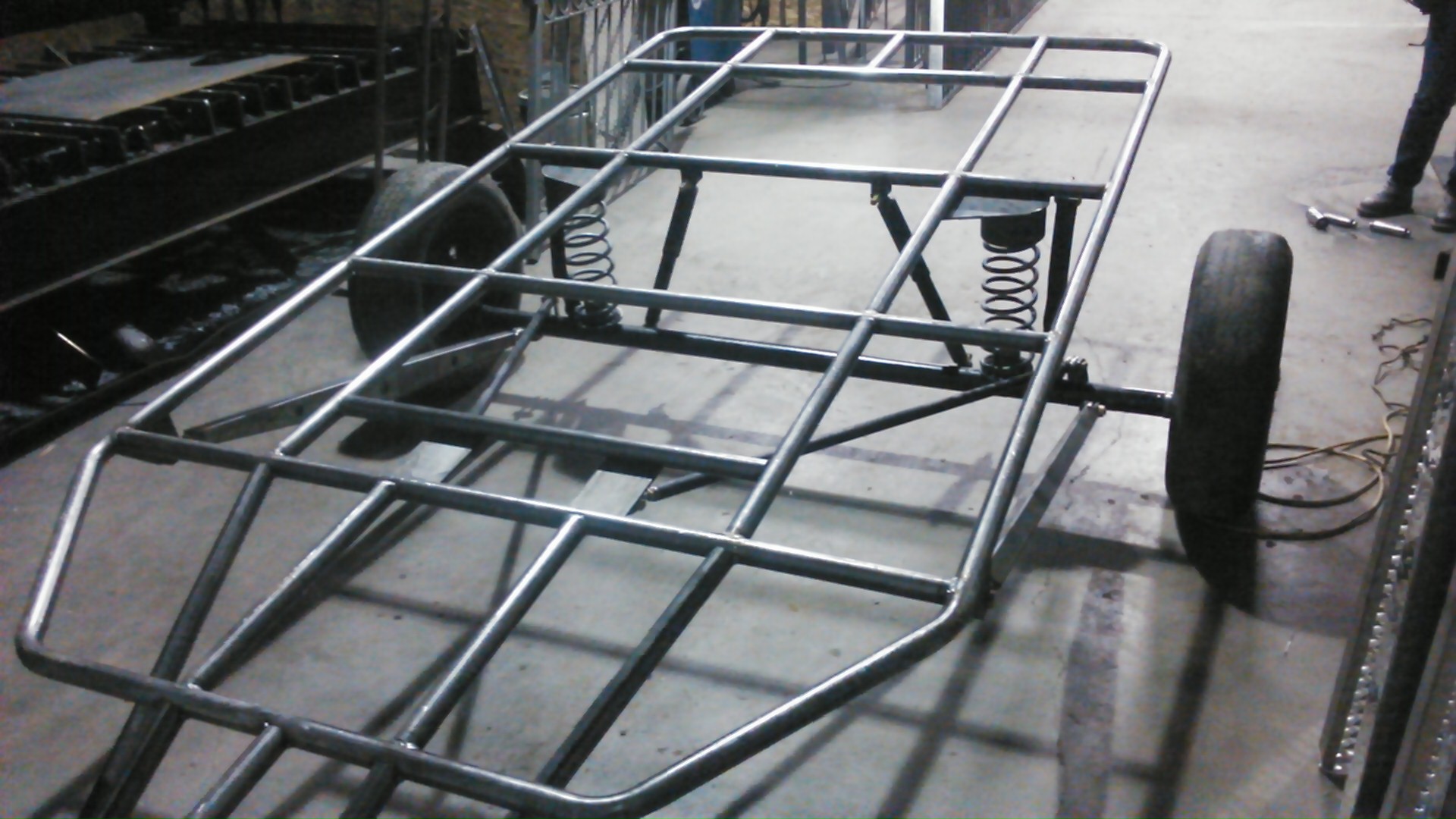

Looks great! I'm currently in the middle of building one very similar to yours! Mine's a 4 link with jeep lift coils. I'm moving to the "camper" part of the trailer now! Also, it's gonna have 33's eventually.. Has pizza cutters on it right now for mock up.. Lol. Check out the pics and tell me what you think or if you have any suggestions!!

Wow that's a cool trailer right there! Nice tube work! I'm jealous, I wish I had a tube bender, and tubing notcher.
Are those stock height TJ springs, or did you cut them down some? Looks like you should have a lot of suspension travel! I was going to use TJ coils, but then switch to firestone air bags, I still have to build one more link. I like your outer links, did you use dimple dies to get the holes like that?
Half my problem is my budget, either I use funds to buy tools to make the job easier, and have no money for steel, or I buy the steel and use the tools I have and do it the hard way, lol. I guess that's why it's taking me 2+ years to get this far, lol.
So when you say your moving on to the "camper" part of the build, does that mean your building a totally enclosed custom camp trailer? You should start a build thread on yours, that thing is sweet!

Thanks! I work in a fab shop for a living every day so I get the privilege to use all the equipment and get the materials for a cheaper cost. I'm kind of spoiled.. Lol. I'm not sure exactly what kind of springs they are.. I found them on the riverbar one day while wheelin!!lol the outer links are just 1 1/2" x3" tube cut to a taper and capped. Then I cut holes in them and welded pieces of pipe in the holes. And ya its going to be an enclosed trailer when it's all done. Thanks for the reply by the way!! I'm new to YT and not a whole lot of people respond to me.. Lol

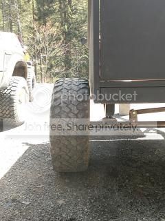

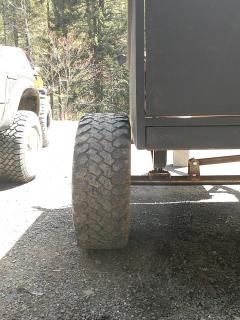

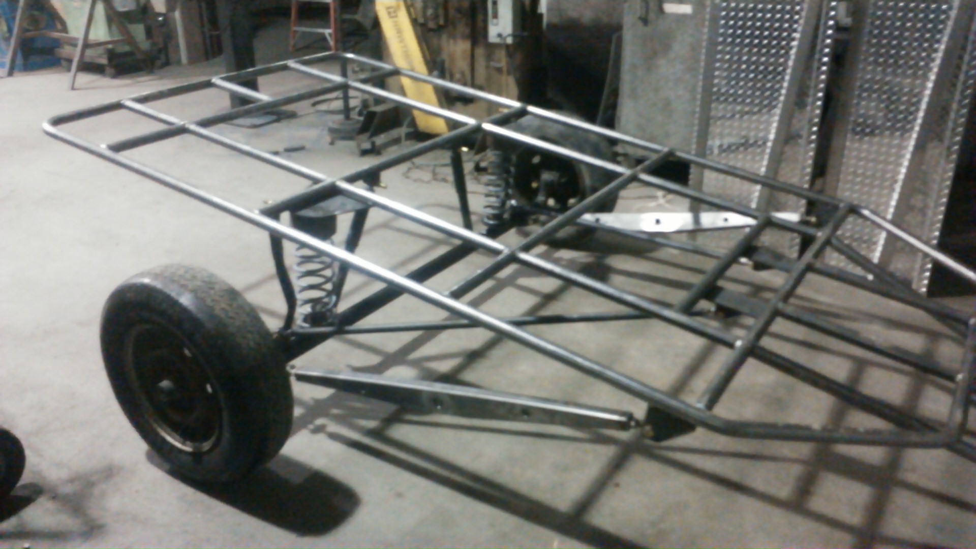

I'm going to be selling my 83' Toyota in the next week or so to my uncle, so I should have some money to put into the trailer project. I pulled the 33's off my 83' Toyota to put on the trailer, and as I thought, not enough clearance between the tire and the trailer bedside... this is what happens when you change your plans half way through a build.

So the options I'm considering.
1. buy some wheel spacers and call it a day- (problem: the axel is already 63" flange to flange, if I went with 3" wheel spacers that would put me at 69" ...11" wider than my 4 runner ifs axel, this thing would look wider than it is long!
2. for the cost of wheel spacers I could buy square spindles and some square tubing (reuse my existing wheel hubs on my current axle) and build a custom width axel- (problems: more fabwork, I'd have to make new airbag and link mounts, more time consuming and again the width would be way wider than I originally wanted like mentioned above)
3. mini tub the box bedsides and make wheel wells and keep the existing width axel as is- (problems: more time and labor, I'd have to notch and plate the trailer frame, cut out the bedsides and some of the floor support crossmembers and build a mini tub, but my suspension wouldn't change.
my original thought was wheel spacers, because it would be quick and easy, but I don't really like the idea of running them, that's when I started thinking of building another axel, but with all the fab work and time involved and id have to buy or build new mounts, plus im not liking the extra width of the axels, im now leaning towards option #3. It would cut into my space a little, but if I wanted to haul a sheet of plywood I could slide it above the wheel tubs, not that big of a deal. What do you guys think, Id really appreciate some opinions or maybe a complete fresh idea from someone elses prospective!

Why not just get wheels with a different offset and sell the wheels u have now? It would be an easy enuf fix and wouldn't break the bank. That is of course if that would allow u the clearance necessary for the axle to articulate adequately. Not sure how much ur axle articulates bur surely it's not that much.

Lol, yeah that's what I was thinking on my way to work today. The wheels and tires currently on my trailer were going to be temporary, I eventually want to match the trailer to my 4 runner's Black steel rims and 35's . But my 4 runner has 15x10's with 3-1/2" backspacing the same as the wheels currently on the trailer, so I'm thinking I probably need to go to a 15x8 with 2" backspacing.

I say you get matching rims and just tub it.

I'm just spitballing but if whether you're using spacers, or a longer axle, or wheels with less backspacing isn't the distance from the outside of one tire to the outside of the other tire the same, with all the stresses, strains, and difficulties that come with it? I think it would be better to get spacers and then get the same tires as on your rig, then you've got good spares.
Tubbing it I think would look the best but storing gear and dealing with wheel wells sucks. I know you mentioned getting plywood. If you do that a lot it might be easier to have a wider trailer, but each decision has it's pro's and con's.
