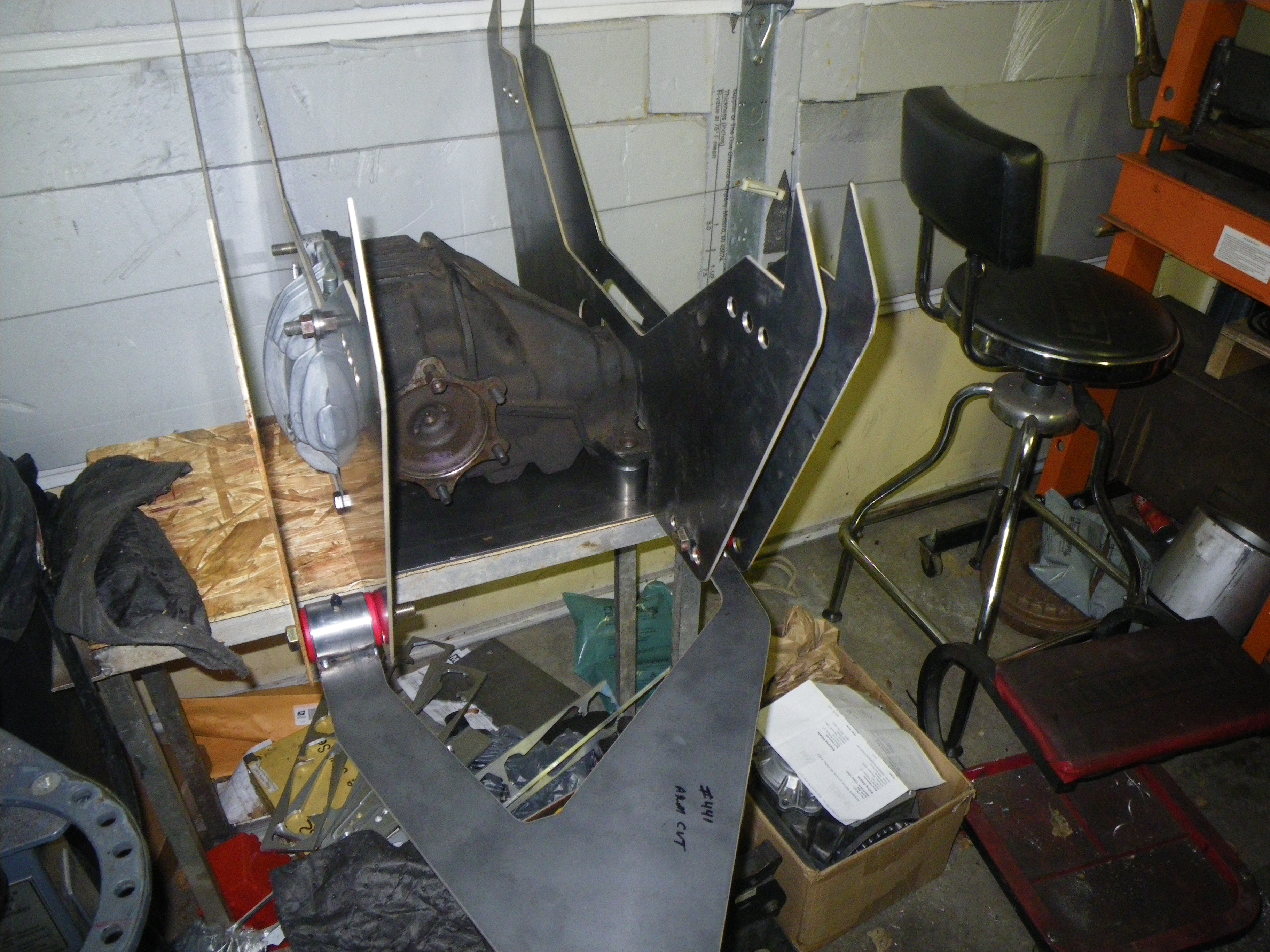

Prototype parts cut for the basic layout, started mocking stuff up a little. Still waiting on some purchased items to roll in and I need to machine a couple key parts. But the point is I am working on it. Material is 10ga steel as this will be what the most of the assembly will be made from, Yes it will have bracing/gussets! Come on man look at my bumpers nothing weak about that design. Right now I leaning to full hydro for steering using a double rod ram and a slider setup.

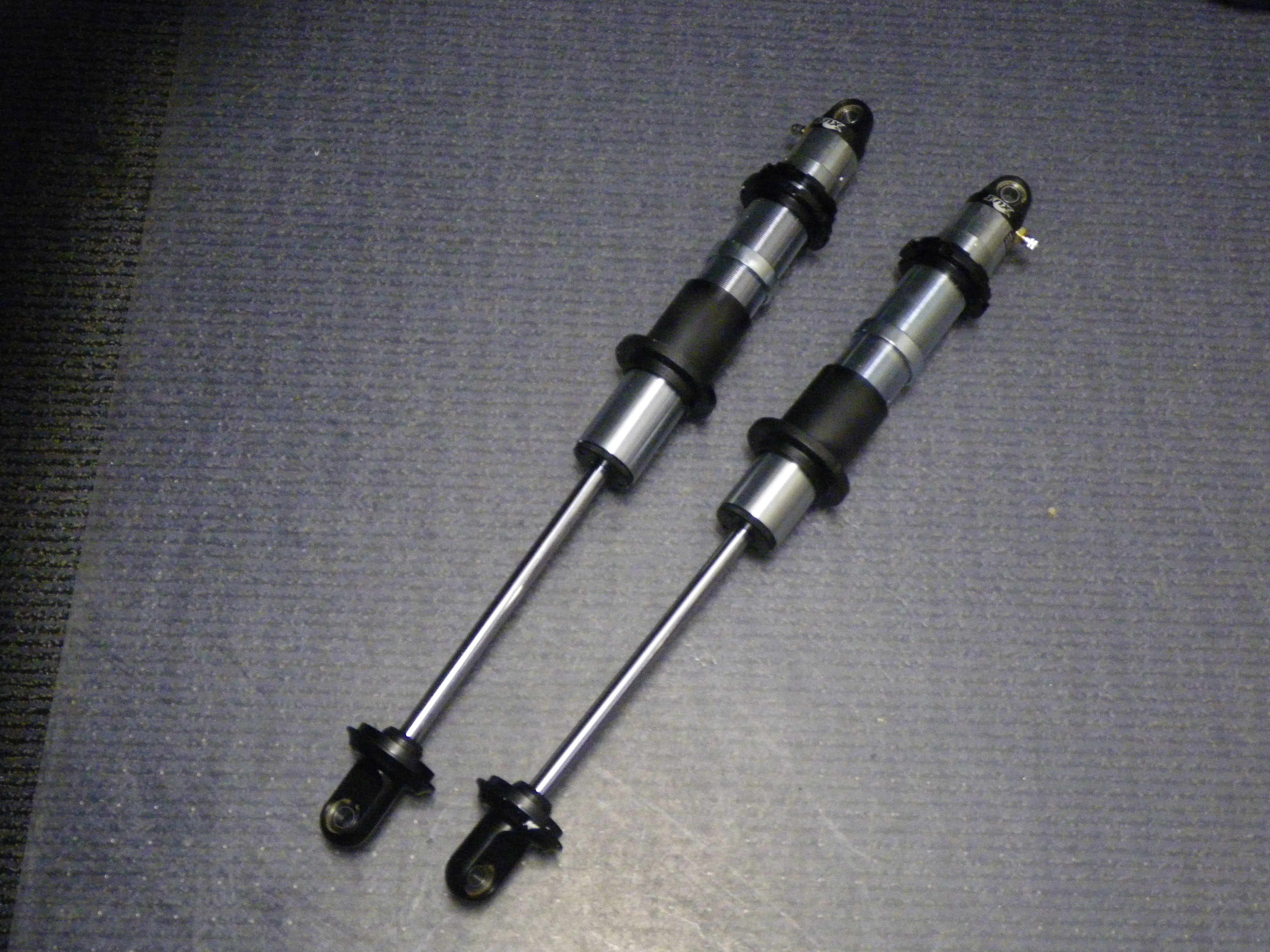

Well I picked up more parts from the waterjet supplier and then these came today.
This theory is getting serious fast.

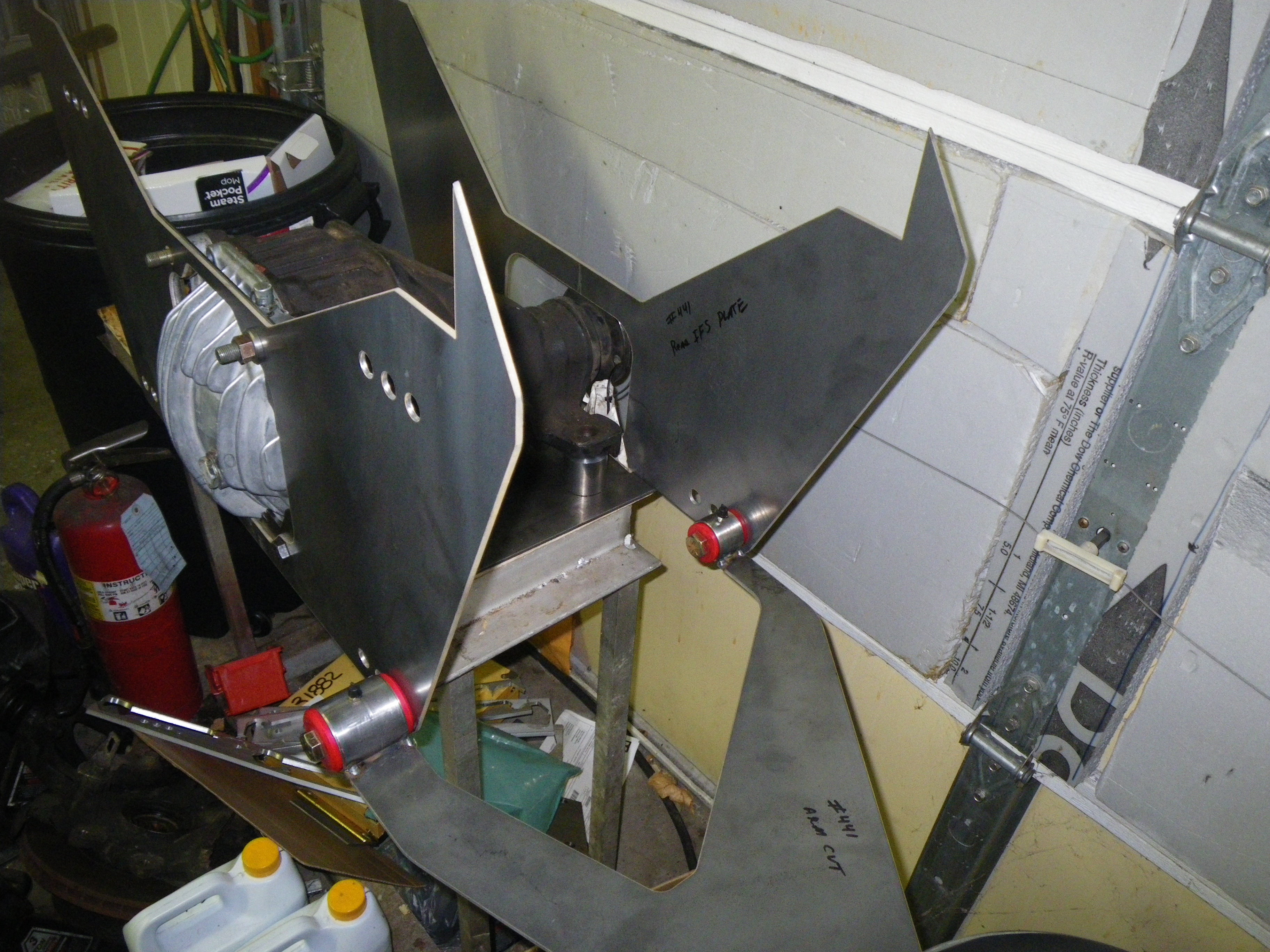

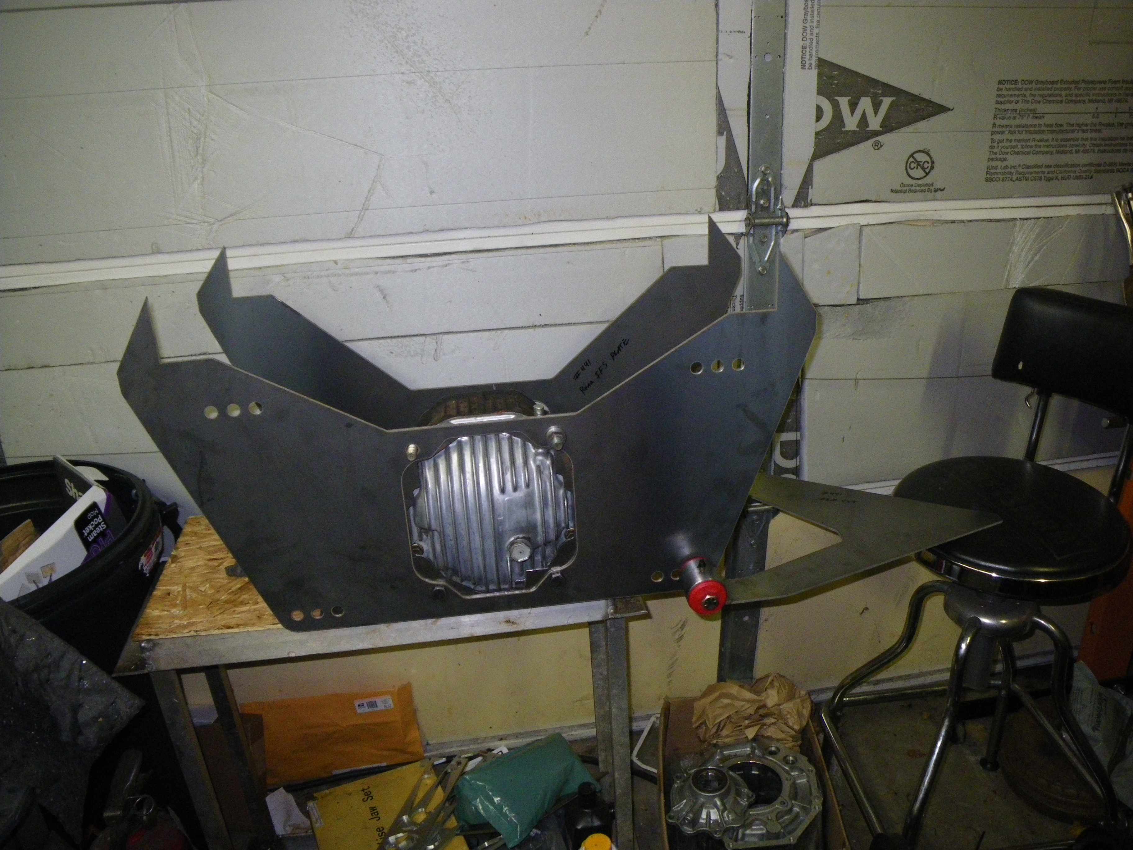

Well here you go. Mock up, but can't say if this is the final layout.

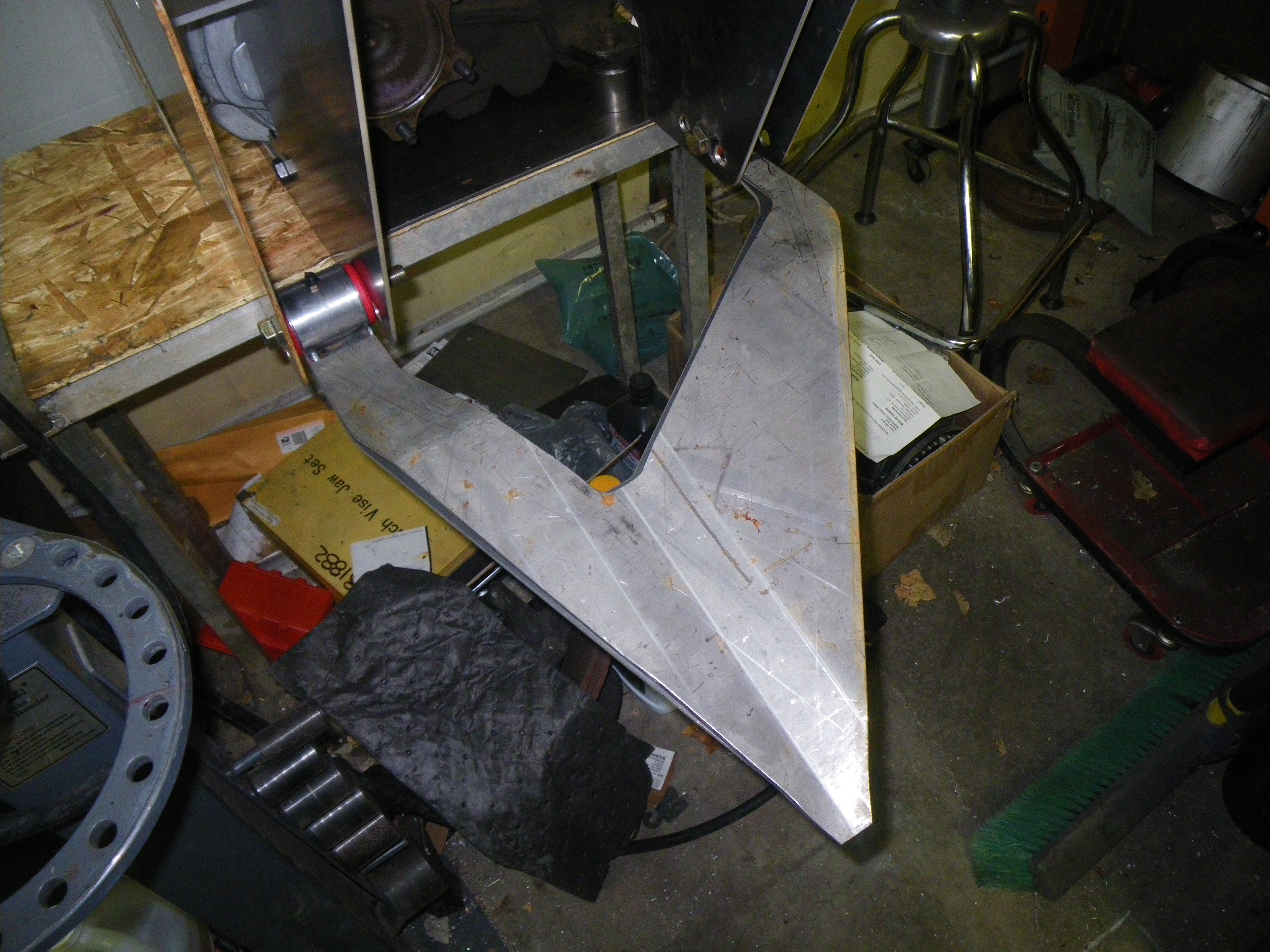

Trying to get more A arm clearance with some crazy bends..........just trying stuff out.
Its just laying on top of the flat pattern for comparison.

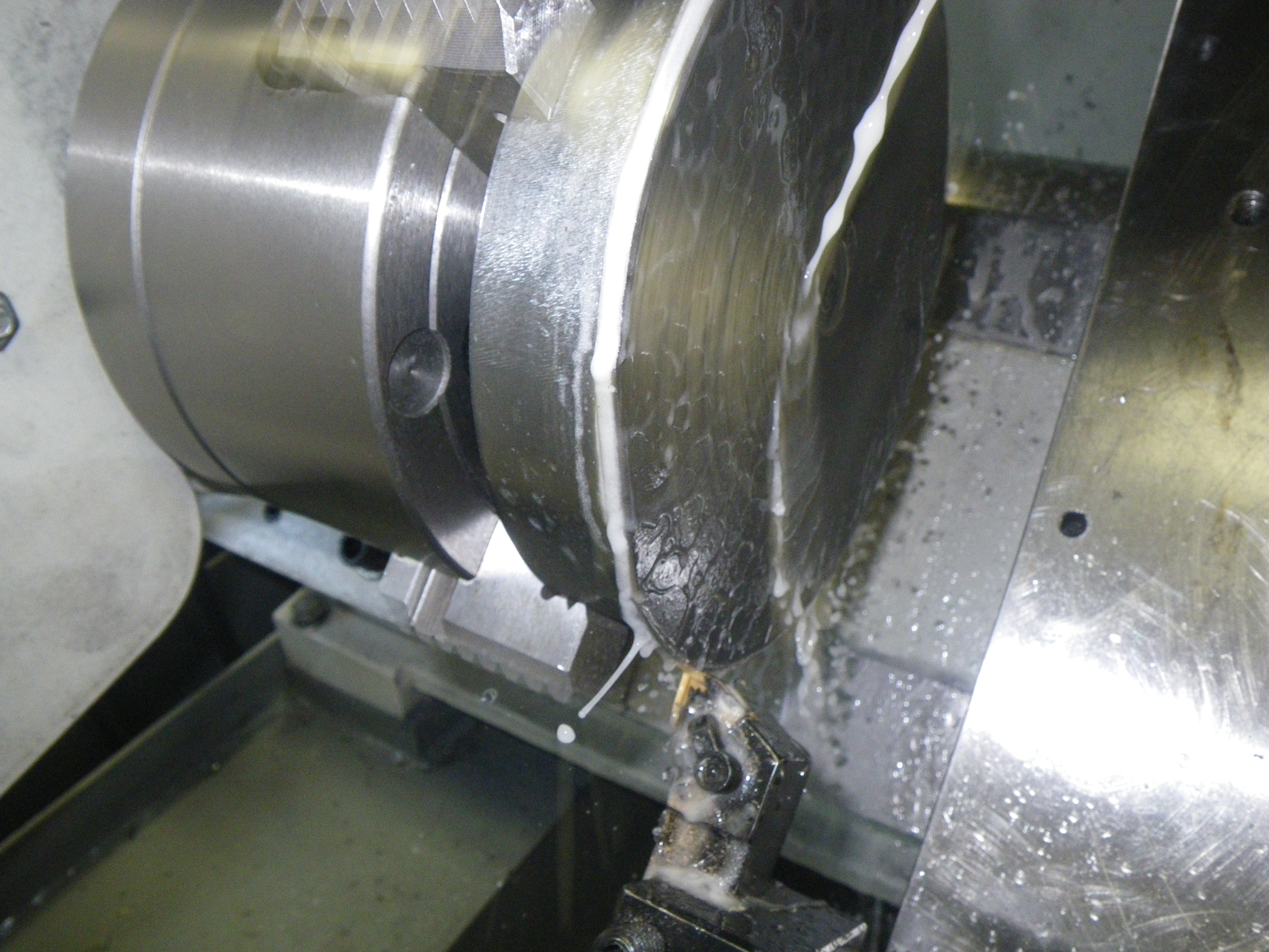

Been building misc parts. Here's pics of a new Tormach 15L SlantPRO CNC lathe making some adapters I need for this. (This part is still top secret)
I'm really needing to make a custom press brake die set for my hyd. press so I can make better bends in my a-arm plates. In the long term I am designing my own small 20ton press brake, I think? I will probably make it just to see if my design works. It will be a bench top type unit since it's just for bending plates with a 18" open width and a 6" throat depth opening.
