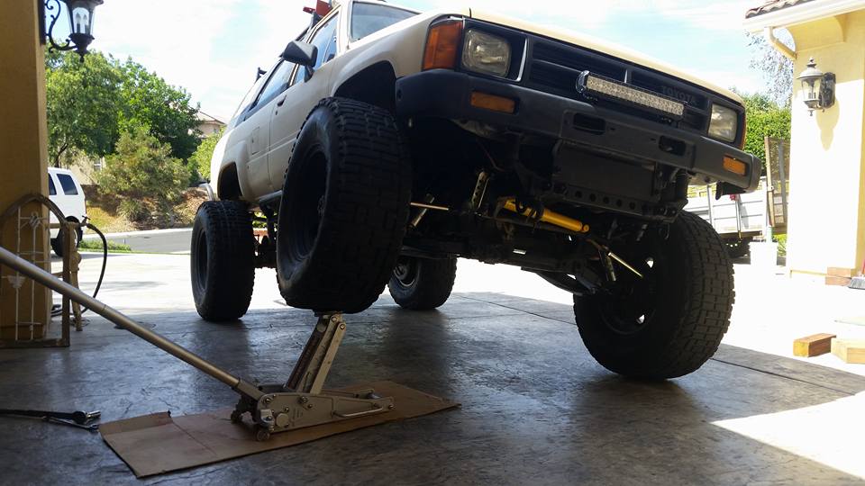

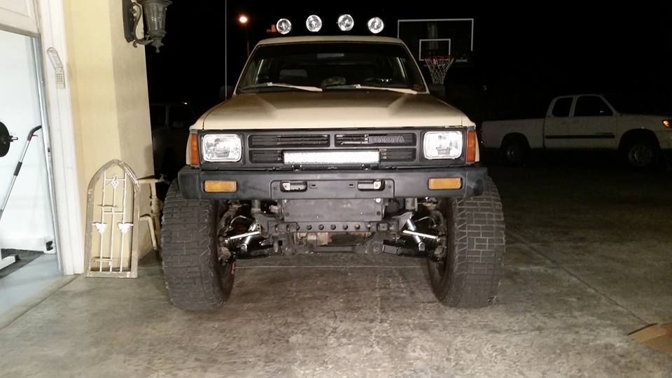

Order a BLAZELAND LT kit and put in in over last week. Nate has been super helpful. Took me and my buddy about a week after work to put everything in. It could be done way faster but we are slow and BS too much.
Little about the rig. 87 4RUNNER "Bueller" 3" BL 4.88 on 35s.
Originally had the 3" BL to clear 33s. With the Blazeland Set up can clear 35s. (Save your BL comments. Been running it for years and ZERO Problems and love how it makes working on it so easy.

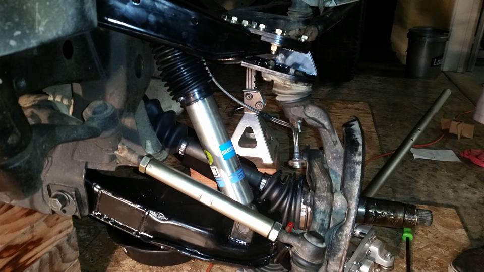

Bought Sway A Way Tbars and Bilstein 5100s and some reman CV 100 from Oreilly's. I bought remans cause I heard somewhere that the remans would be Toyota that were ramanned , BAD IDEA more on that later.
The Blazeland kit feels great and I have all the stuff to do 63" Chevy swap but in the meantime we just added an add a leaf from Low range. It worked really well. No more bottoming out over big dips and bumps and flexes pretty good. Was worried cause they seemed so stiff when putting them in. Also put in some 3" TG spacers to widen the back for now.

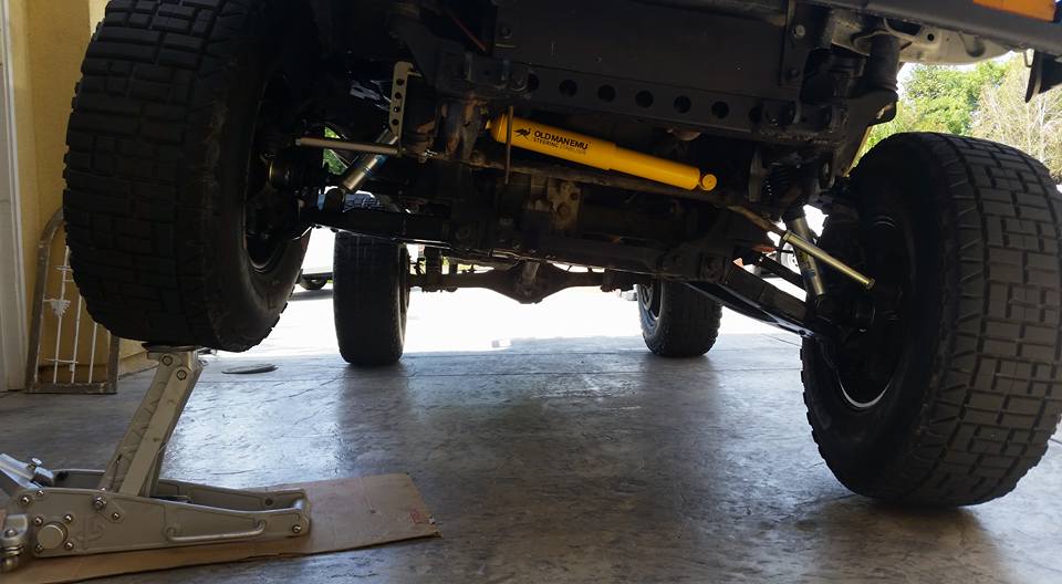

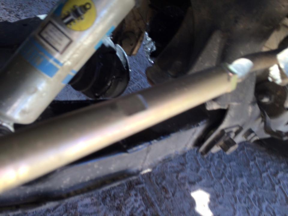

I just read through this thread and have a couple of comments and questions that may help with the CVs. In the early photos, in the garage, it looks like you are running low profile bump stops. Later photos I cannot tell if its low profile or you went back to factory? Anyway low profile bump stops will allow too much up travel. Adversely, low profile "droop" stops will allow too much down travel. Either up or down, too much travel will exceed the operation angles of the CV. Too much wheel travel will also effect the plunge in the tripod barrel as it too has operational limits that can be exceeded. Either will cause the CV assembly to damage itself. Use factory bump and droop stops to limit travel as needed to protect CVs, BJs and Tie Rod Ends. These are items that can fluctuate between aftermarket brands as well as original equipment. It is always a good idea to include these checks when tuning the suspension.

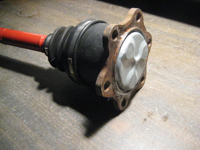

As for aftermarket vs. Original Equipment Manufacturer when it comes to CVs there is a lot of variables. One item that can be easily checked is the appearance of the barrel lid or cap. The type of cap the OME uses looks like this.
The flat lid design uses a taller barrel and will bind earlier.

Yeah still running the low pro stops and will change that out. The remans did have the look of a "flower" instead of just round...
