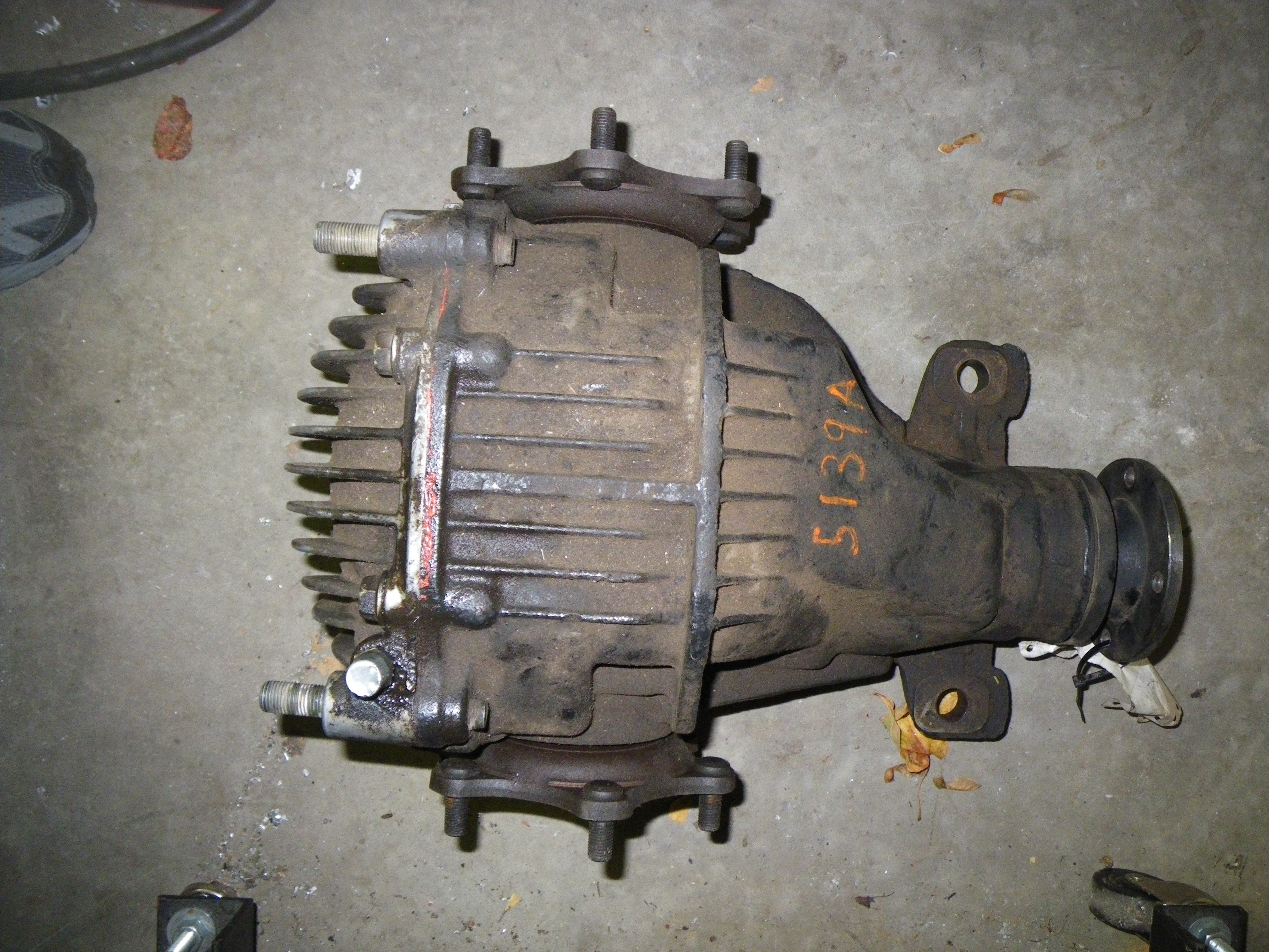

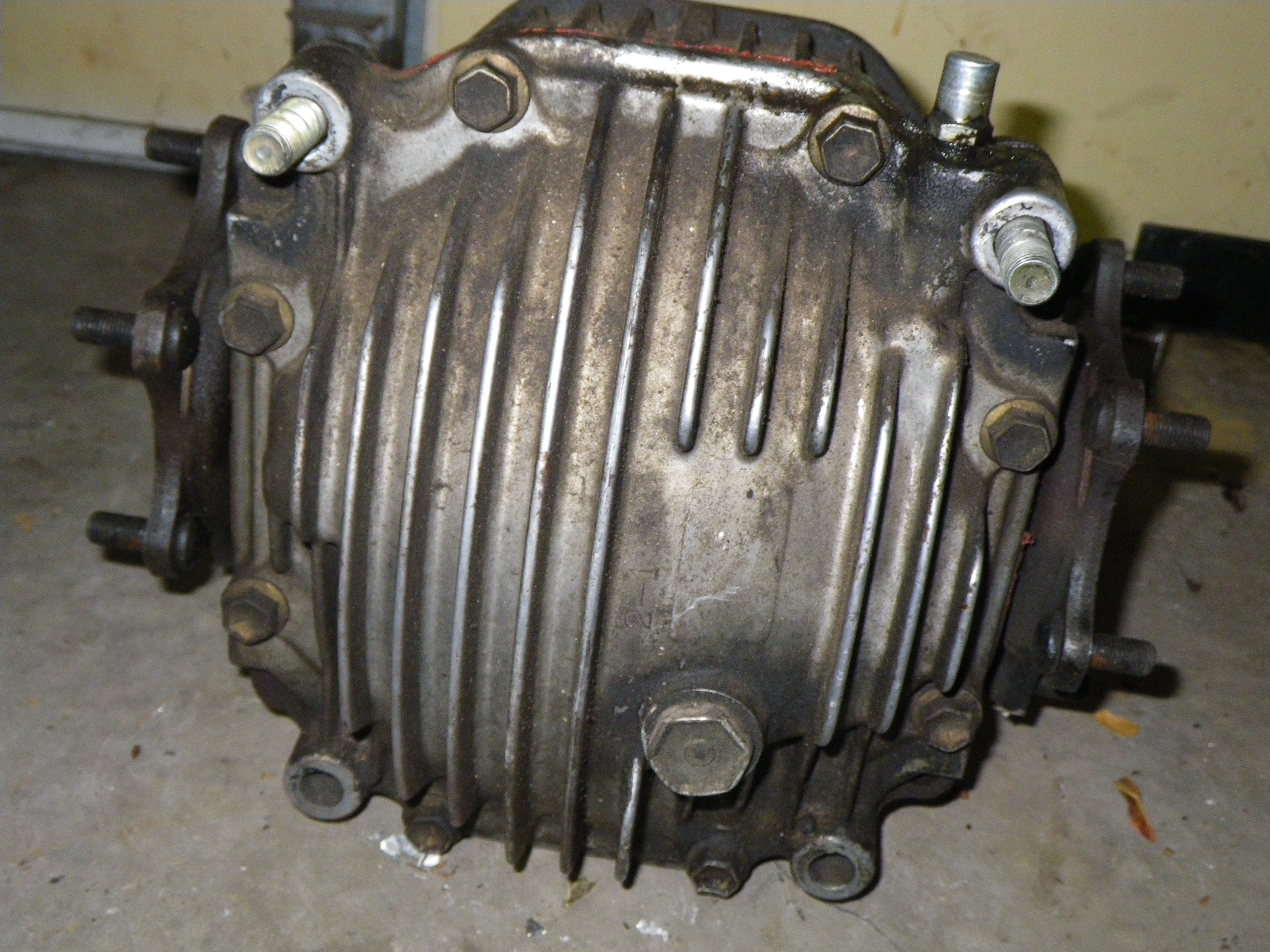

Anyone every put an IFS setup in their first gens. I just picked up a Supra diff and axles and am eyeing the whole IFS thing and liking it. Always been a little off, but the IFS would be cool with a trailing arm linked rear.

I doubt if any one has ever done that. Like putting a prop engine in a f16 fighter.

Well I knew this would bring out the naysayers, but I still think the flex forklift ravings are hype in 90% of wheelin. Beside I'm looking more toward better control on the rough stuff that I've seen around here and more clearance in the PNW snow. Don't forget I run an A340 dual cases and a 2RZ all the parts no one likes. Silly people.
Besides I wanna be like Shannon!

I've read up a bunch on this setup using the Supra diff I have. Shouldn't have issues. The Aussies do stuff like this all the time.

The aussies do some pretty weird stuff dont they? Obviously you could fab this up...your confidence tells me that. I understand wanting to be unique and push the boundries....what I dont see is the benefit.
scribble me a picture of what this would look like. Like a long travel ifs front set up in rear? offset or centered?
Old Oct 18, 2013 | 03:19 PM
R.DesJardin's Avatar
Joined: Nov 2006
Posts: 363
From: Clarkston,WA
Thanks and OK benefits/my opinions:
I think I can get more overall ground clearance with IFS, definitely more to the diff at ride height for sure. This will help with any wheelin I've done.
IFS handles better at most speeds over a crawl.
Big Flex especially overflex is a fad and 90% of us don't need it. I think the Ultra4 cars have this figured out. But this is an opinion and can't be argued so let's leave it alone. I drive Toyotas, Dodges and I like guns, can't argue any of this it's who I am.
Flexy rigs are tippy, I like hills and bumps.
Not looking for more travel that the solid axle setup I have has, I'm running RUFs and have plenty of travel.
Centered diff.
CAD images will follow as I continue.

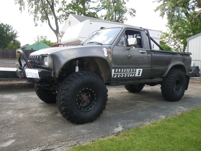

Ok here is the truck as we know it, 2RZ, A340, Duels, lockers, 63's, RUF's, plate bumpers front and rear, I 've got a build thread here and on Pirate. This isn't a pretty truck or a DD that I need to worry about getting be back and forth to work. It's built to wheel, it needs to be built different to suit what I do. It's all been done by me a crazy old grey haired grandfather but not quite as old as Marlin.
Blazeland does not make a kit that will do what I want out of this setup nor does anyone else, I have the Supra Diff and Supra axles for the inners and centers and will swap out the outers from an IFS truck. Only time will tell.
