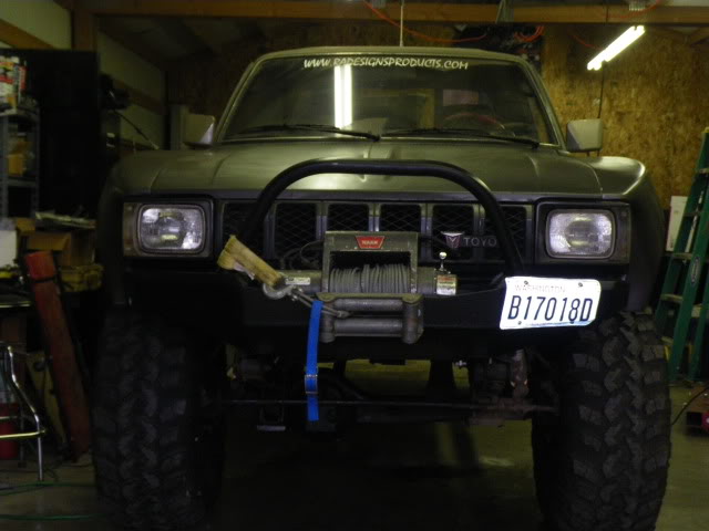

Originally Posted by SCToy
Would be much easier to put a first gen cab on an ifs frame.
It's worth noting that the first gen cab is very narrow compared the track width of a decent long travel setup. Be prepared to stretch your fenders if you local police are concerned with tire coverage.
Fender width not an issue already:

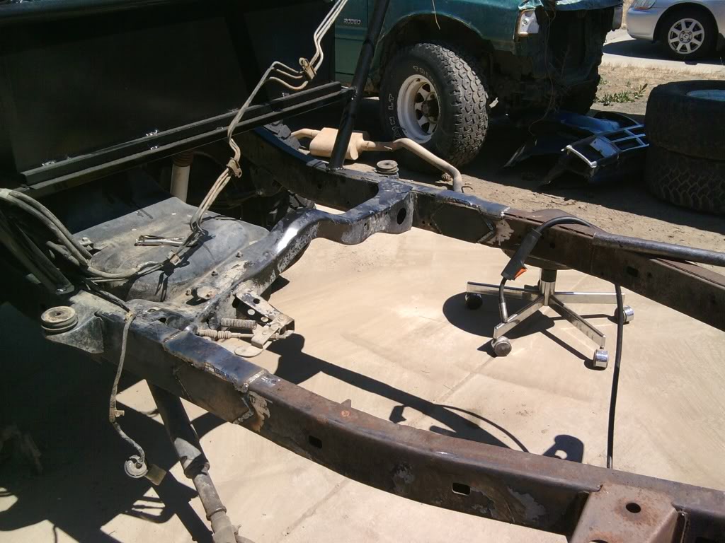

you could buy up an IFS frame/roller, chop off the front end , do the same on your SFA frame, then swap them on there with some extra reinforcement. That'd probably be route with minimal transfer of items. I'd think the IFS frame is slightly stronger due to taller box frame vs earlier gen.
here's what I'm referring to (but opposite, as this is putting SA front frame onto an 86 IFS rear frame I believe):
