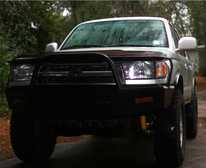

Nice bumper. I have a similar front bumper. The pic is a little weak because I took it on a rainy and cloudy day. Two things I noticed were that rocks get kicked up and chip the paint and I can't run with the D-ring clevices on because they bounce around and chip the paint off the bumper.

Nice bumper, but need better pics. I used POR-15 paint and haven't had any issues with rock chips yet. I also used some rubber washers I made, when I mounted the D-rings. They keep them nice and snug, so no movement or rattling.

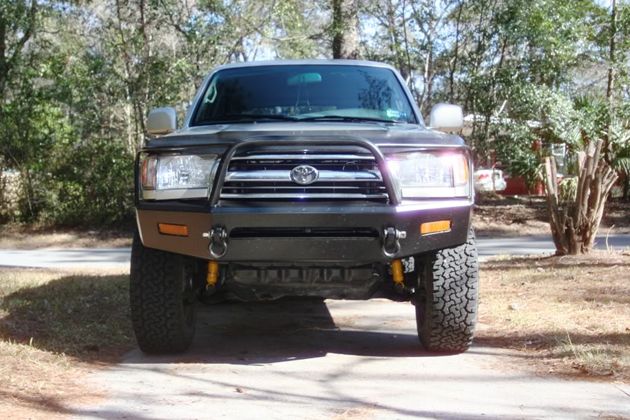

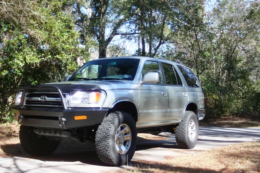

Here are some better pics. I designed this bumper and it is very similar to yours. Good design Bandit Runner. Tell me about these rubber washers? How did you make them, etc.? I'd like to make some so I can run with my D-rings as well.

Looks good, very unique. For the rubber washers, you just want something that is going to make everything nice and snug, so it doesn't rattle or move. I took some 3/8" thick rubber, used a 1-1/2" hole saw to cut out some round pieces. Then drilled a hole in the center with a spade bit for the shackle pin. I used two washers per shackle. One on each side of the shackle mount.
