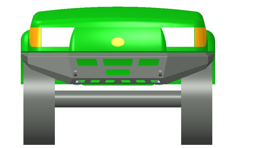

Well, I've been wanting to start this thread for a while now, to document my bumper build. I really like the looks of the aftermarket plate bumpers: TJM, ARB, and Shrockworks. But, I want something unique, and thought it would be a great learning opportunity to build one myself, since I've never done anything like this before. After reading several build threads, doing a ton of research, and listing all of my design constraints, I was ready to start designing.
Design constraints:
- keep it simple, easy to build, and keep cost down.
- bumper must accomidate my 1.5" body lift.
- bumper must house a 9000 lb winch.
- bumper must look good, and follow the lines of the truck.
- bumper must house a set of fog lights.
- bumper must be strong enough for winching and tugging.
- bumper must not weigh more than 100 pounds. Less is better!
- bumper must mount in stock mounting locations.
- bumper must have hoops over grille and headlights.
So here is what I came up with. Now keep in mind I started designing over a year ago, and the design has gone through numerous iterations and changes over that time.
The mounting portion with winch plate and shackle hangers:
And some pics of the end result (I hope) of what it will look like on the truck:
More to come.
Hey man. If I were you I would have the blueprints to this thing drawn up and I would have them manufactured in Indonesia or China. It's not hard to get a warehouse set up over there and get them manufacturing products. I have a killer idea for another part which could be manufactured....I guarantee it would sell....I might sell the idea for a very reasonable price. But as far as your plans go, look into it. It's not hard at all to do.

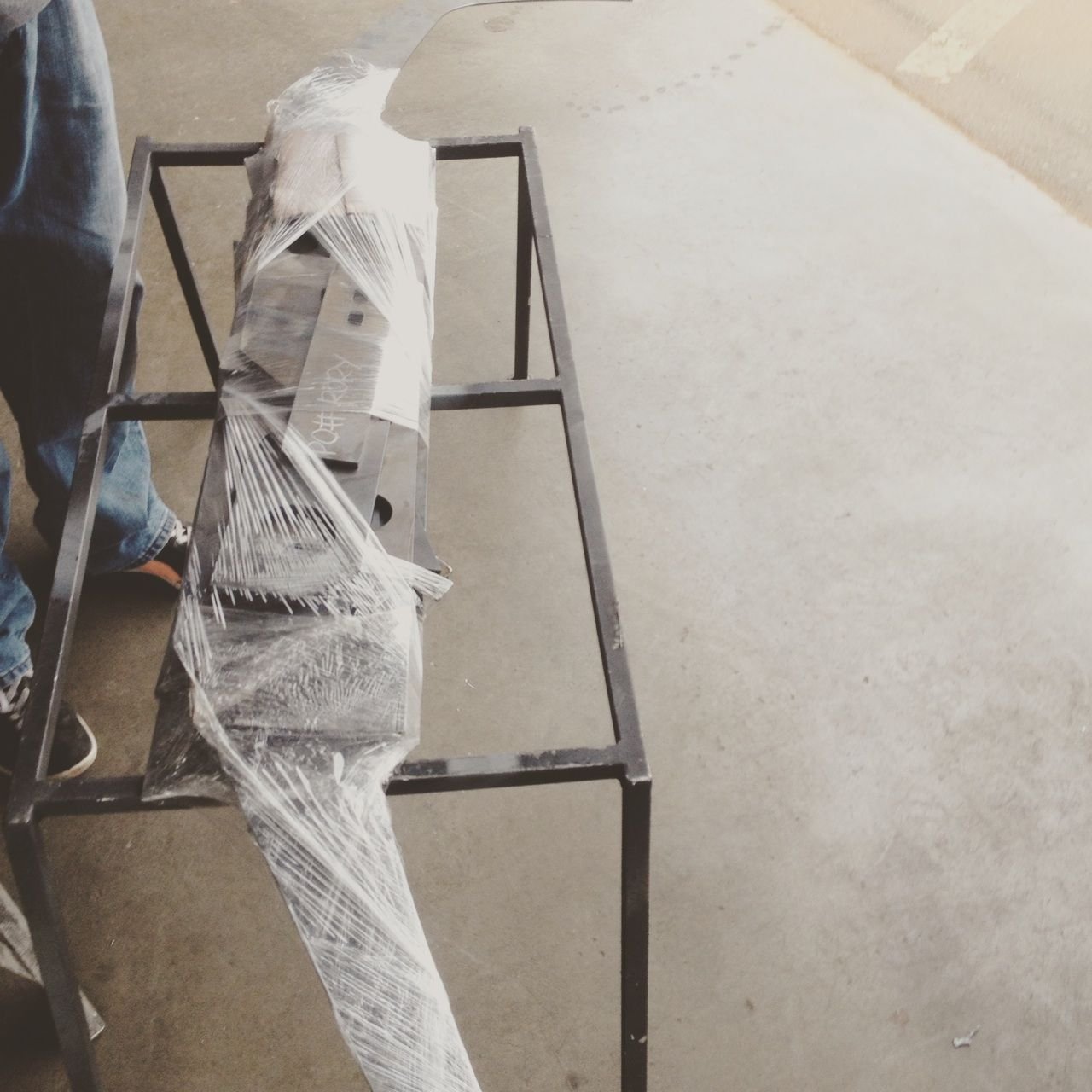

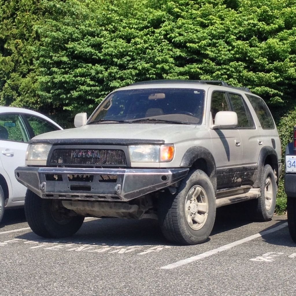

Not to Hijack this thread. But I read it a few months ago and decided to take the plunge and buy his drawings and wanted to show you my personal experience (which was smooth as butter)
(the bumper final design created was due to my requests for modification from his original bumper, he designed it with his expertise, but if you dislike it vs his original bumper, that is why its different)
my rig is stock minus his bumper and snorkel currently, will edit this post when the 33's and lift go on.
tl;dr any ˟˟˟˟ you dont like vs his original bumper is due to me
Step 1: I emailed him via this thread, we had a back and forth discussion and he sent me this cad mockup, which we further tuned (this might have been the final drawing, either way, i annoyed him to make a few tweaks)
Step 2: He emailed me an amazingly detailed set of drawings and cad files along with very details instructions that even a novice could follow
Step 3: I called various plasma and watercutting places in my area farming for the best price.... watercutting is pricey, they quoted around 700, plasma is probably the way to go. I got this set of metal (including materials) cut for 200 dollars Canadian (around 160 usd right now)
Step 4: I live in an apartment, otherwise i would have welded myself and learned. I took it to a local fab shop who build it for me. I then followed bandit's paint regimen mentioned in this thread. So Far VERY happy

Your bumper turned out great. Thanks for posting your experience.
