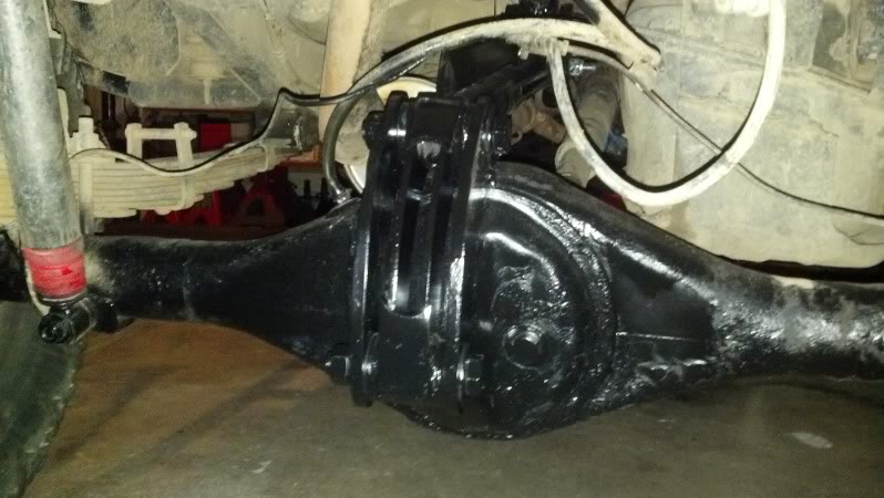

The 4runner is still kicking, doing great actually. Ive been tweaking and redoing some of the things I did back when I had less abilty/knowhow. It cruises down the highway quite nicely.
I put a hole in one of the trxus at Black Hills, and instead of replacing it I sold them and snagged a good deal on 4 37" Radial Rockers.
I lowered the truck another inch or so and added caster to the front. Its finally where I want it.

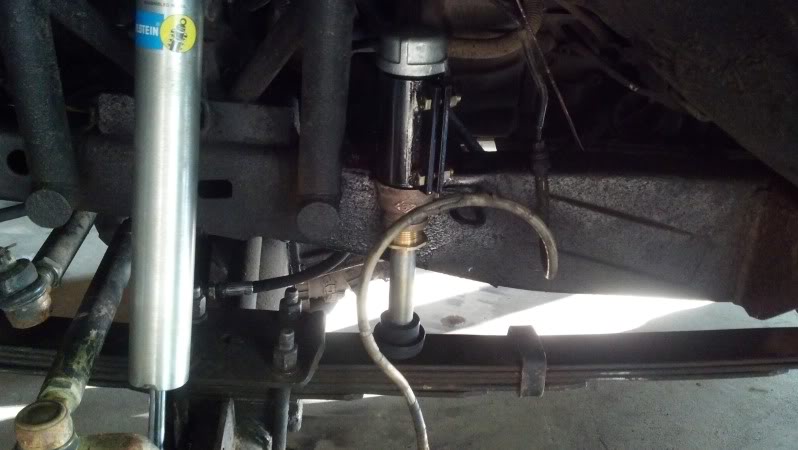

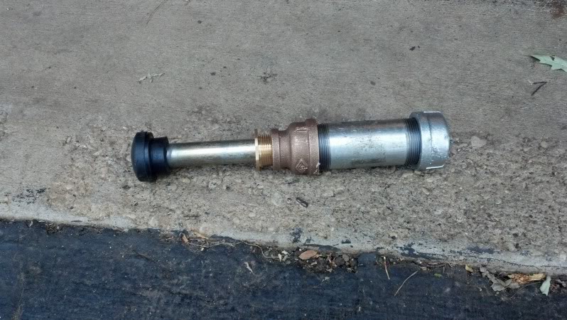

I also started to tinker around with making a poor mans air bump. Ive wanted to try this for a while, then I saw that Stinger actually came out with them, but they want way too much $ IMO, too close to air bump prices.
So I started to walk the isles in Menards and came up with this for about $25/ bump. And requires about 20 minutes of work to put it all together. Keep in mind it was just for fun. I welded them up in the front and they worked so well that I made a set for the rear. The truck hasnt bottomed out yet and I cant feel when the bump hits the axle. They also added a little spring rate that I needed with these leafs on a 5300lb wagon (I mounted them about 1" off the alxe). With bouncy bally from Target....
.... They compress 1"/100lbs.
