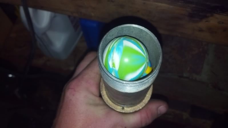

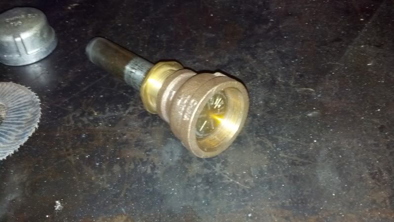

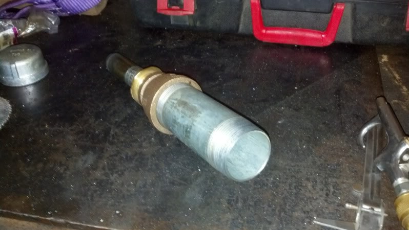

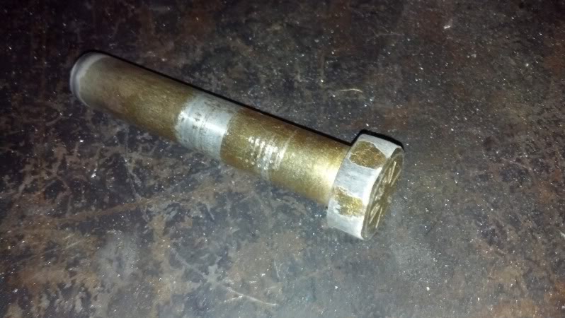

Originally Posted by bump530
Nice build. Whats the details on that bump stop?

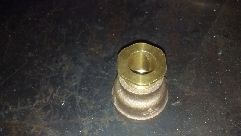

About $25 in menards parts.
The piston is a 1" bolt with the hex filed down so it will slide inside the body, which is a piece of pipe. Pipe cap on top, reducer on the bottom, brass bushing threaded into the reducer. Fill the pipe with whatever you want... I tried a few different bouncy balls, and some foam golf balls. The golf balls could not rebound fast enough. The other bouncy balls were getting destroyed in the can. The ones that work are the ones I found at Target, in the party section. On the end of the bolt I fiddled with a threaded bumpstop, but it took soooo long the first time and I have found that a chair leg cap works just fine. Then simply weld the pipe to the frame (er wherever) and assemble.... I made a can for the fronts, but again, it was more work and in the back I made tabs and simply buzzed them to the frame...
Ive thought about making a build thread with part numbers.....but I guess its just a little to hillbilly. But they do work!
After using them for a year, I have broken 2 bounce balls in the back (easy to replace, the caps are only hand tightened). And the fronts either have a broken ball or are kinda compressed up in the can....So I simply added another bounce ball to those...meh. I only noticed the broken/compressed balls when I reached down and found slack in the piston...I didnt feel any difference in ride.

That's a pretty cool idea. I may steal that idea from ya when I build do my SAS on my 4runner. Then again, mine will prolly see some mud in its life, not sure how well that will work once it gets packed full of mud.
But I do like the idea.
Nothing on a vehicle agrees with mud.
But they should be ok. The piston is in a tight tolerance with the bushing... Worst case the bushing gets whooped out.... couple minutes and a few bucks from menards and your good to go.

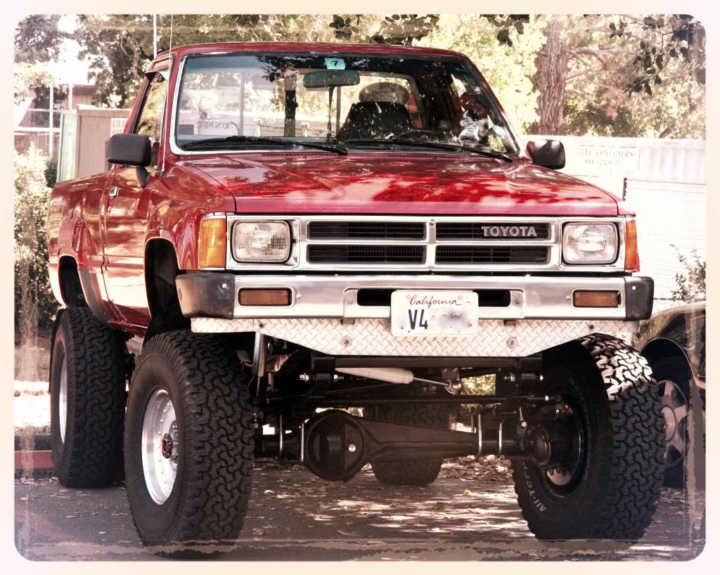

I ran a 220 flux core on my SAS, good pen and no gas to blow away, it was windy the 5 days it took to complete.

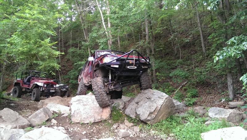

Love that this thread is still going! Lets see some more action shots!
Hmmm Action shots eh?

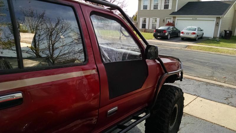

Originally Posted by RoBatt
Absolutely love the half doors. Any other pictures of them?
I know you bumped up to 37s a while ago, but i was curious if you had to sacrifice any up-travel to fit the 37s with only the 4 inch springs. How difficult was that?
I suppose I did... but I just keep remove and hammering body out of the way to accommodate up travel, also the bump stops help to limit the up travel to little more than the axle pivoting on the stuff side bump...using it as a fulcrum. But IMO tire diameter>body.

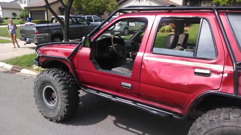

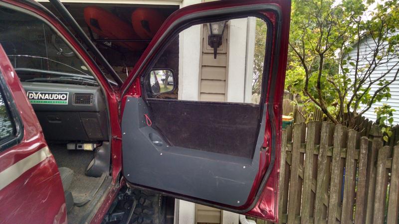

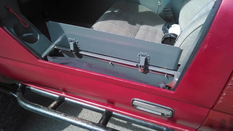

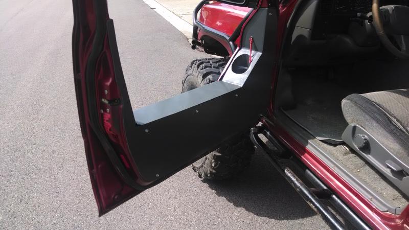

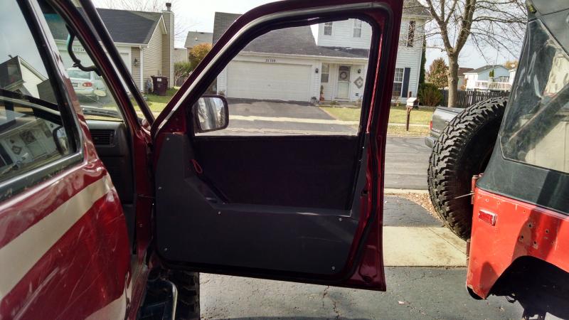

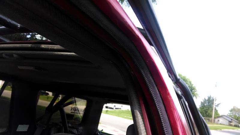

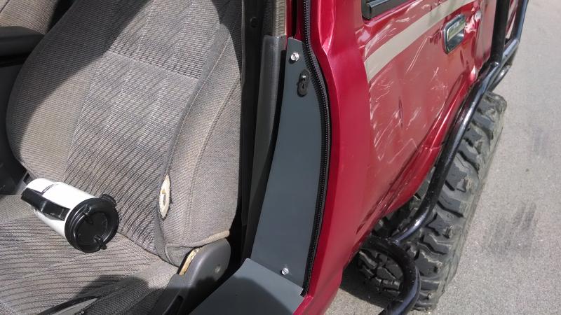

Here is a copied post on the half doors. Let me know if you have any specific questions. a lot went into them (more than I care to admit) and the pictures don't dive too deep.
I made these last spring.
My goal was to retain the functions of the original doors. Locking/unlocking/opening from inside and out. I also wanted a soft door and wanted to do something different from the buttons. So I used a #10 coil zipper and sewed a piece if piping to one side and made a channel around the door for it to ride in. then used 30 ga. clear vinyl and cordura for the door.
Ive never sewn a stitch in my life and after I got a quote for $600 and 8 to 10 weeks from a local canvas shop, I found a 1942 singer 201 for 60$ on CL, and figured it out.
The soft door rolls down and stores inside the door under a hinged door.
They don't rattle and surprisingly, they don't flap at highway speed.
