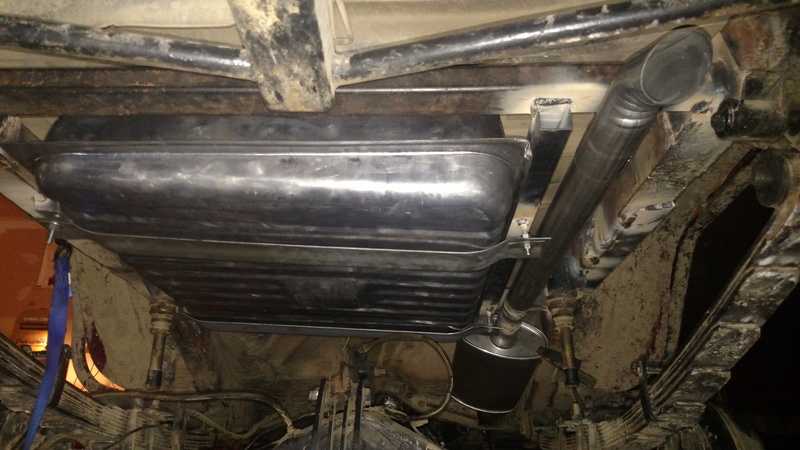

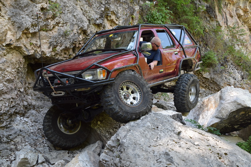

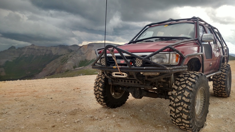

Since this got bumped again, I can only assume you are all dying to hear more about my ol' lady....
Crazy year. In the spring, while at Rocks and Valleys in MI, I slid off of an obstacle and landed on my old bud built x-member hard enough to slightly bend it. I figured, cool, i now have a flatter belly... But as the year went on, it kept bending so I eventually replaced it.
While at Flat Nasty ORP in MO in June, I broke my 5th ring and pinion in 10 years. I have broke 3 4cyl 3rds, and now 2 v6 factory 4.88 3rds. My truck weighs over 5,000 lbs and has a 3.4. To be honest, I am not really disappointed in the v6 3rds, I got about 3 years out of each rear before they died. So rather than simply spend a couple hours and throw another one in, I decided I would be an idiot and do the following.... in only the 3 weeks I had before leaving for a giant West trip. Oh and during a nice Chicago heat wave....
Fj62 front housing and 3rd with 5.29 and a spartan.
FZJ80 rear with 5.29 and a spartan.
Ford F150 fuel tank behind the axle, but mounted long ways so I could run exhaust beside it.
Outboard the rear shocks and notch the frame for clearance
Throw 14" Fox shocks at all 4 corners.
Manifold back new exhaust
All new brake and fuel lines.
Removed several factory xmembers and added a couple.
Undid a lot of ghetto stuff that I have done in the past.
Lots of other little things that go along with this (mounting the anti wrap, new mounts for hydro assist, cutting off all factory brackets on the axle and grinding them clean (worst part), etc.).
It was a crazy 3 weeks and lots of late nights and lots of favors from friends! But it loaded up on the trailer with hot welds, bare metal, and a can of rustoleum in the tool box. It wheeled pretty flawlessly over the next 3 weeks in Black Hills, Moab, and Colorado! I was shocked! I did manage to break my first quarter glass ever, a branch got wedged between the glass and cage and I didnt see it until I heard it.
Actually, I spent more time working on my tow rig (2006 Tundra DC 4.7 with 200,000+, and loaded with 8000 lbs). Usually its flawless, but it was struggling to pull and getting hot really fast. After throwing a radiator, cap, shroud, and some other stuff at it throughout the trip, I finally took some advice that I got on day one from a friend which I dismissed.... I cleaned the MAF... Runs better than ever... live and learn I guess. The K&N is on the shelf and will be given away!
In September, while in Harlan KY, I broke my first 30 spline Longfield in ten years. Trail Gear replaced it no problem. The break caused slight damage to the Spartan (chipped a pin and dented a couple teeth. After consulting with Spartan, we agreed that it was ok to run and it has been fine ever since.

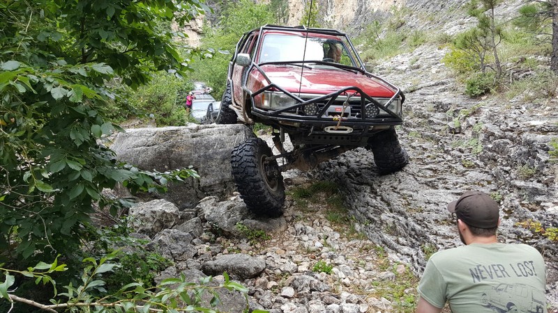

I like this one
