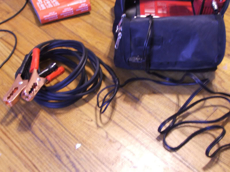

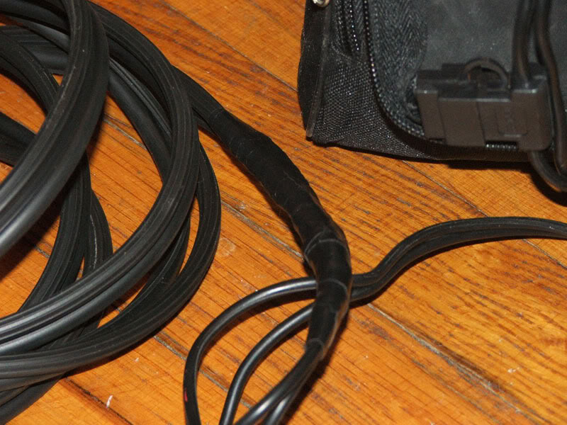

I figured I'd post an update about my compressor with pics for the rest of you with the same thing and same problem. I finally found what I needed to fix my 1 main problem with this: the cord is too short to reach the rear wheels. I could barely reach the driver side one, but needed to borrow a set of jumper cables to reach the passenger side. I actually partially welded the original clamps when they bumped together doing that tire. Needless to say that won't happen again!
I've been looking for new/heavier clamps to hold it to the battery better and heavy enough cable to use. All I could find for clamps were identical to the ones I already had. Never made it to lowes to check on wire since I couldn't find good clamps. I ended up getting a set of el-cheapo jumper cables from Autozone ($10). Granted, I would probably not USE them as jumper cables as they're half the thickness and 1/3 the price of others, but they're good enough for this. In fact, the thickness is overkill but where else could I get the clamps and wire for less? (As a side note, I now have 2 spare clamps to replace the grounding clamp on my welder!)
I cut the clamps off one end, spliced into the compressor's cord, and viola! These cables being thinner works out well as they are very flexible and can be coiled up to fit in the bag (and zip it closed no less!). So now I have 18 feet of cord to reach just about anywhere on the truck.
Cables used:

Cables spliced together, solder, shrink tubed, and wrapped twice in electrical tape to help avoid getting pulled apart.
