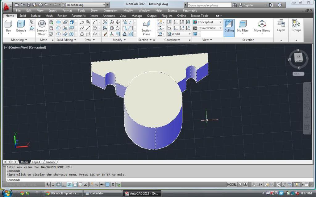

Ok so I was doing some research on fj80 axle swaps on the Ih8mud forums and there is a guy on there that took some square ubolts, notched the bottom of the top spring pad, made a plate to go across the springs and put it all together.
Now if I was going to do this I would plate the entire spring pad and cut a tube in half and weld it in there to make a good solid mount.
I thought it was a great idea and a good was to save some money. just wanted to here your opinions on it

i think this would be a cool setup will get some pics up to help people understand what im talking about because im not real good at explaining stuff

here they are i couldnt get the ubolts to be completly solid all the way around due to teaching myself 3d autocad but you guys get the idea

Why not just buy some round u-bolts at the auto parts store that fit your axle and drill out a plate? Can easily make your own the conventional way.

-Because I can
-Everywhere locally charges 20 per set
-I know they are bent up on the ends so they don't flex and bow I wasn't focused on that to much when I drew that up
- why not
- mine are square and I have extra square ones laying around

Seems like it would put way more load on your spring mounts. Also if a u bolt works its way loose your axle will fall off

I don't really have any arguments against the ubolt working loose point but I've personally never heard of a spring perch folding in on itself while under a load and highly doubt the weight of the axle could rip the perch off the housing so I don't aero the more stress on the perches as a valid point in the discussion ( not being a dick just explaining)

Besides axle weight there is also the torque of axle wrap. Probably not gonna break but still another factor. $20 isn't bad for the security of new bolts that go around the axle. is that a model of your actual axle? My perches look quite a bit shorter and wouldn't work for this anyway

Where are you getting prices from aroun here $20 if ubolt is one side of the axle I got 6 new ubolts but they are square
That was a estimation I realized after looking under there to see they were quite a bit shorter than expected might make new ones

I bought the u bolts off rock auto and it cost like $6 a bolt.your method would work I was just pointing out a few downsides to this way. If it works for the fj80 guys it should work for you, just not the best way imo
