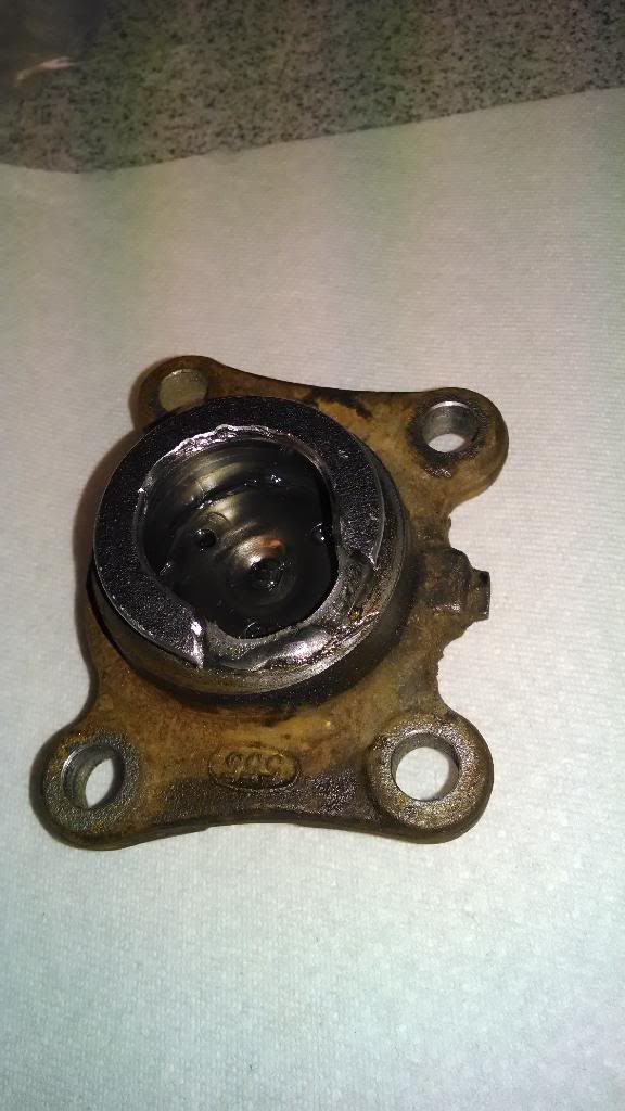

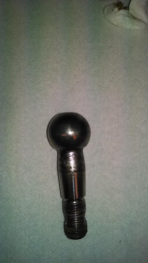

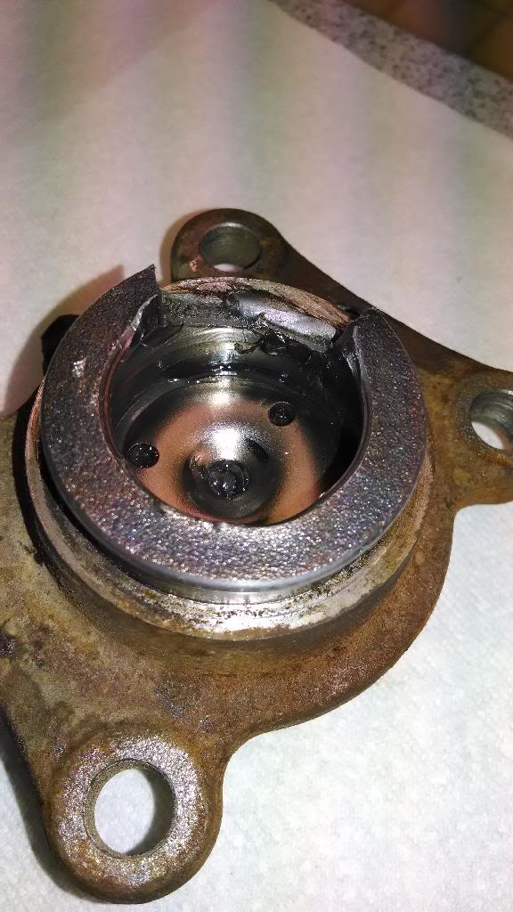

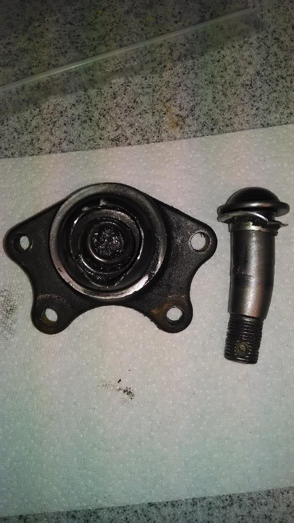

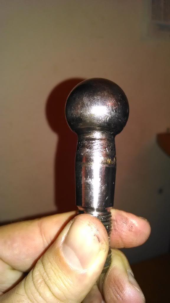

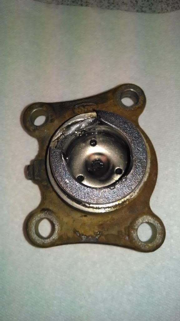

Thanks, Ive heard that someone used to make a bolt in Uniball... Looks like they are gone and im on my own though.
Interesting update!! I though I had some crap chinese ball joints... BUT 555!
Old Jan 6, 2014 | 04:23 PM
  #85
Zpd426's Avatar
Joined: Mar 2011
Posts: 505
From: Socal
Heres the Lower. NOT a 555 but any balljoint would have failed at that point...

Oh I almost forgot. John the thing on my Diff is a skid plate/driveshaft disconnect for when we used to tow the t100 behind the motorhome.
And if you mean the other thing, its just a axle truss for reinforcement.
Anyways it looks like the Joint had been maxing out and I think the metal was defective as well.
Maybe I need a different upper ball joint? Does it matter what year I get? Maybe I need a 4Runner or Truck joint? Maybe I Just had my Suspension set too high? Oh well... Uniballs coming anyway.. And with a 4" lift will solve both issues.

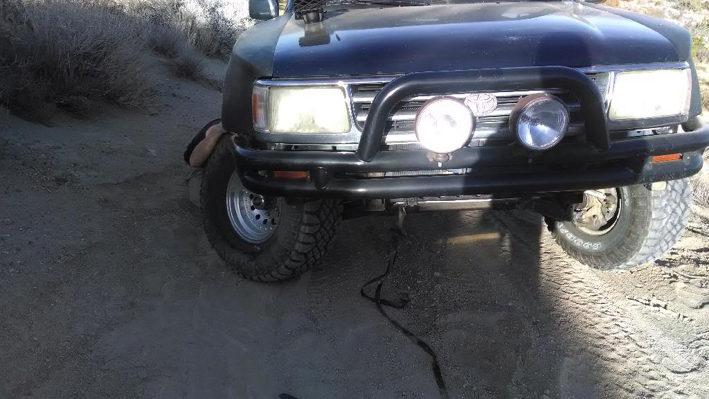

The only pic I took. Steep hill. I slid pretty far down. Didnt get a pick of the second break when my A arm made a nice gouge in the ground.Name:  IMG_20140104_135325981_zpsbvm5yqkg.jpg

Old Jan 6, 2014 | 07:13 PM
  #89
BlazeN8's Avatar
Posts: 977
From: Southern California
Zack,

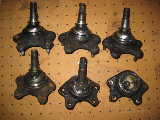

Thanks for posting pictures of your Upper and Lower Ball Joints. I don't believe there are different upper ball joints pertaining to year or model. Maybe someone can cross reference part number to verify. I vaguely remember someone did this on Pirate? I did want to point out a few observations:
Photos 1-3: Three Five 555 Lower BJ "cup" (4) bolt holes.
Photo 4-5: Upper BJ "ball stud", yes upper!
Photo 6: Lower BJ "ball stud" along with Upper BJ "cup" (4) stud flange, studs removed.
I believe you miss matched the ball and socket in photo #6. It is important to get the relation correct when trying to identify the failure. When matched it up correctly, and by following the sequence of events, we might figure some things out.
Your T-100 beast was in the process of climbing a hill in 4WD and the upper BJ popped out of the socket? This could happened because the UCA hammers down on the droop stop and the hanging weight of the wheel, spindle, LCA, etc, is pulling down on the upper BJ as the droop stops bottom out. To compound matters you have a coil over conversion that causes an additional force in form of a spring load on the LCA (a 600 lb spring). I think those two forces are hammering down on the upper BJ so that one last repetative hit just popped it out.
With a dislocated upper ball joint you backed the vehicle back down the hill where the Lower BJ broke. You can see the cup is split to the side, indicating a side load to the cup. As the wheel was flopping around and being drug its understandable the Lower BJ would fail. This also could bend the ball stud as pictured. Like a tow strap looped around a tow ball on a trailer hitch.
I think one could prevent the upper Ball Joint from being pulled apart in he first place by adding a limit strap that connects the LCA to an anchor point on the frame. This moves the spring load directly to the strap. It also moves the hanging weight off the upper ball joint. Lastly it flips the hanging weight to the Lower BJ- as a compression force. The Lower BJ is designed to handle compressive loads.
I think the factory droop stop design is fine with torsion bars- as the spring load is terminated directly on the droop stops. With a coil over conversion, the additional spring load is added to the upper BJ hanging loads. These combined tension forces over time or with a hard enough tug pull the ball out of the socket.
Not saying I am correctly diagnosing this failure but just trying to think it through. Could just be a fluke event? If you patched it all up its possible it would never happen again!
I have observed many ball joints in my searching for UCA and LCA cores in the salvage yards. I see lots of front end acccidents involving front suspension failure and damage. Here are a few samples. The BJ on the bottom right of the group had the ball stud ripped out of the cup like yours. The opening should be a slot not a circle.

Nate.... After closer inspection you are right!
Ive been doing this all during study breaks....
Haha I just drew up a print for the Lower ball joint.... At least the upper one is easier to do!
So the joint that failed was a Chinese joint after all. And it is incorrect that it has a round slot?
I think you are right on about the bump stop forces and the design of the ball joints.
I am feeling slightly more confident going back to ball joints... BUT I REFUSE!

Hmmmm, yeah too bad the MT isn't in production. I could send you a UCA Extension Bracket as just the laser cut patterns. Then you could fit them together around a uni-ball cup.
What I was saying about the slot being round was it started out as a slot but as the ball stud worked on it it became round and the ball stud popped out?
