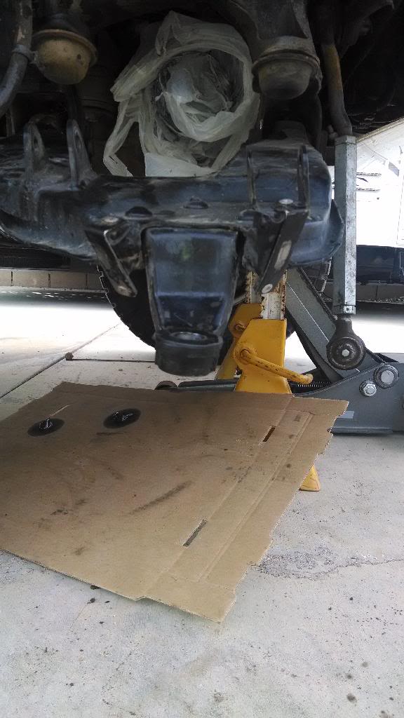

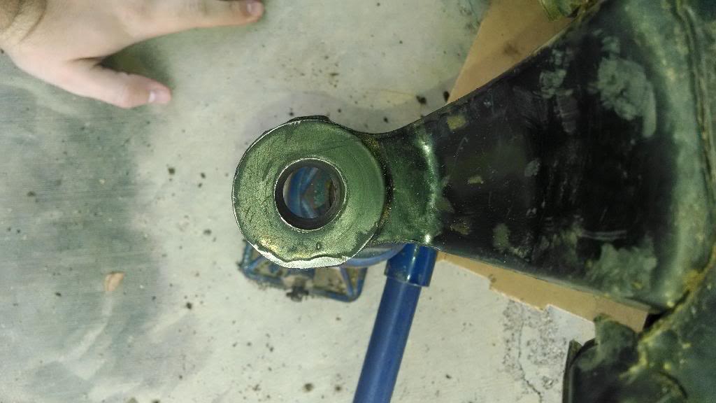

Think its unsafe?...Due to the massive twisting force put on it from that upper ball joint failing while I was on the gas in 4 Low, that spindle was free to go and it got slammed forward really hard. its kinda twisted,, it makes nervous

So I will have to get my hands on another LCA before the hammers maybe?.... I was planning on taking a trailer pulled by another truck but I just found out another family member is going to use it for a last minute trip...

Hmmmm? Unsafe? I do see the twist on the LCA BJ Drop and the tapered hole does look a little out of round. I also see the rear bump stop bracket looks a little off? Could just be the camera angle. You might want to ream out the taper. As for the twist in the BJ drop I'm not sure what to do. I could get you another LCA, but probably not with the rivoted wheel stop pads. I don't see many LCAs with that feature.

Damn I didn't even see that with the bump stop. I'll have to check it out. I ordered my limit straps. Should be here Wed. Wish I had the cash for the hydro bumps so I wouldn't have to worry about bending up those stock ones..

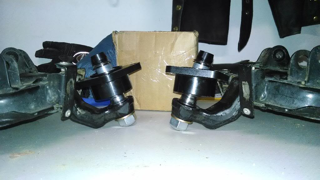

Total Chaos lower uniball conversion

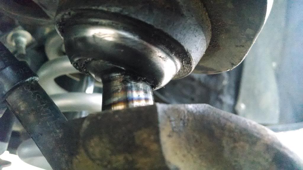

This is at full droop, factory bumps.....So I have been maxing out my Ball joints... My compression bump stops are bent... but still... May be because of the joint being Chinese... I really want to open up a toyota OEM joint to compare... which i WILL do when I figure out the upper uniball conversion...

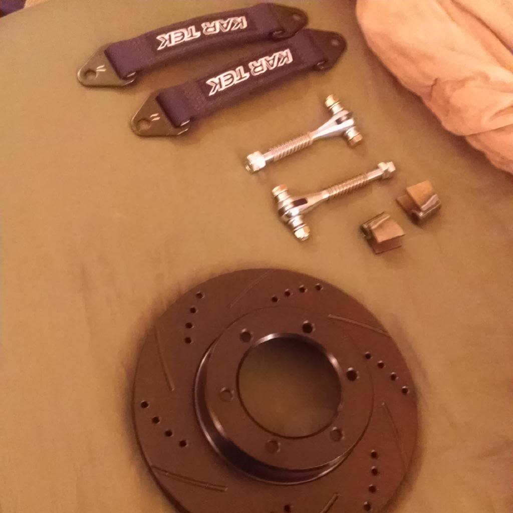

Straps and Rotors.

Rotors look nice

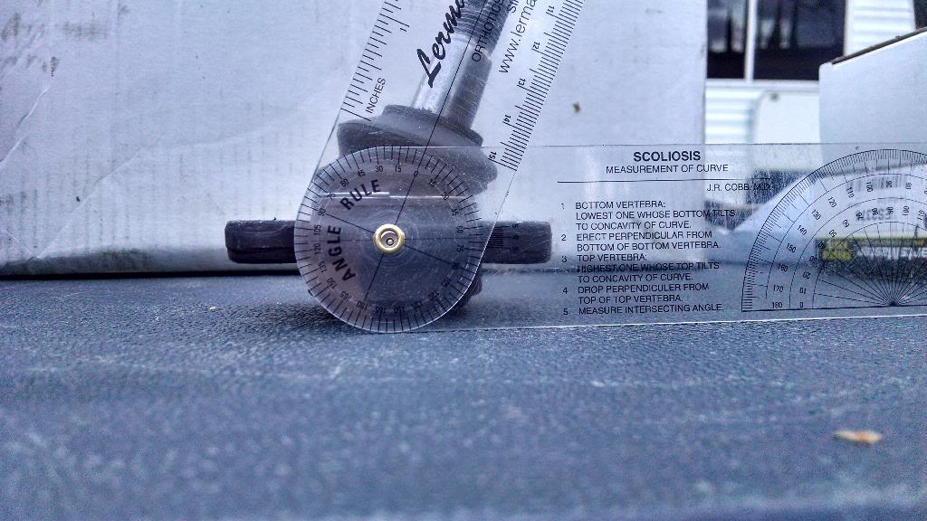

It looks like the stock BJs swing 65* from center.
How much did the TC's gain over stock?

The stock Ball joint has around 24-27 degrees of movement.
The total chaos uniball (or any uniball) had about 32-34 degrees.
Its hard to tell in the picture

Drilled out my LCAs today which was actually very easy. We used a Bridgeport (Manual mill) basically used it like a drill press while one of us held the Control arm steady and the other operated the machine. Because of the tapered hole the drill self locates making a straight hole no problem. And there is not very much material that needs to be cut through anyway. Everything went smooth.

Oh and an update about the upper ball Joints OEM vs chinese,
I havnt opened up a toyota BJ but just by moving it around i can tell the opening for the stud is NOT round, it is oval. The toyota joint has more motion Y than X, which means there is more material holding that stud in place and preventing a pull out failure like I had.
The chinese joint being round is much easier to pop out.
BUT I still have not opened up the toyota joint to look at it.. I will as soon as i get the upper uniball finished and then ill post some pictures

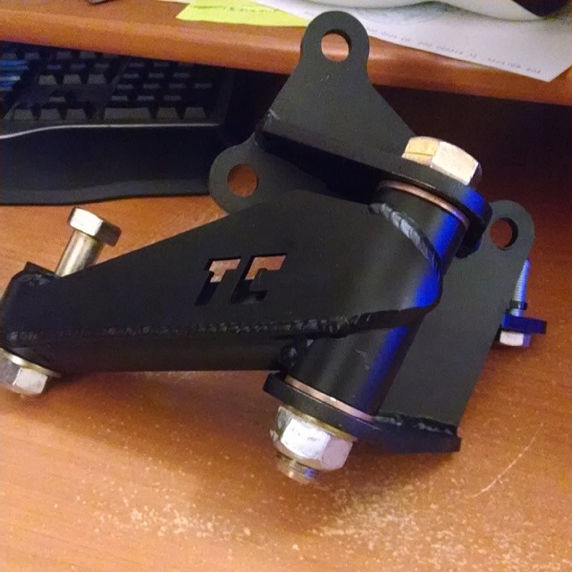

Just got the Total Chaos Idler Arm, Mine was toast. Ive been wandering back and forth on the highway for a few months.

Were you running a stock style idler arm before? Did you have a brace or brass bushings or anything? I'm sure the TC arm will be a great improvement one way or another.
