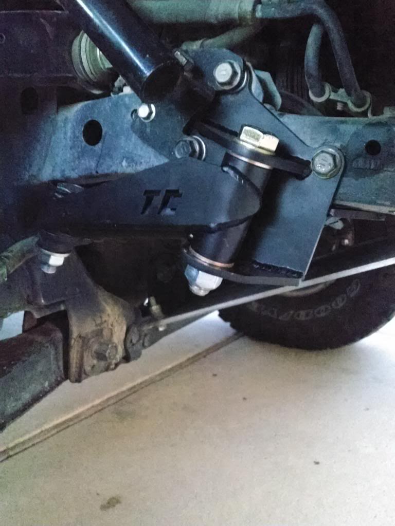

TC Idler arm Installed! Big Thanks to Doug, a fellow t100 owner for the help!
I can already tell the steering is way tighter.

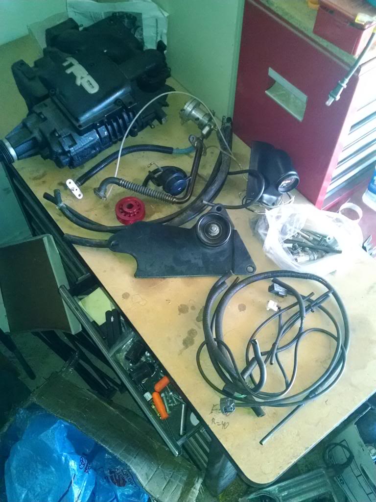

Sooo i got my hands on a supercharger, its a first gen painted black for some reason.... The guy i bought it from bought it from a guy who bought it from a dealership.. Neither of them ever used it. I have to figure out whats been done to it and if I should just get it rebuilt before i install it.

Congrats on finding one!
One thing you'll want to consider is getting rid of that older style tensioner. Hit up trdparts4u and get one of the new dynamic tensioners. The older tensioner puts too much load on the bearings in the charger and alternator.
Also, don't bother with the older FMU unit. It doesn't help nearly enough, because it simply tries to open the factory fuel pressure regulator open further, but it just doesn't compensate enough.

Thanks, ya ive heard that from my buddy also. I gotta get the new tensioner and ditch the FMU. Magnason is only half hour north of me so I may head up there and get it rebuilt just in case. So do I need the URD 7th injector kit? How about a fuel pump?

I would do the 7th just based on how much better my truck runs. I ran for almost a year with a stock pulley and no fuel mods, and looking back now I realize how much Bette the truck runs. Also, if your going to run the smaller pulley in the picture, I would definitely say its a must have.

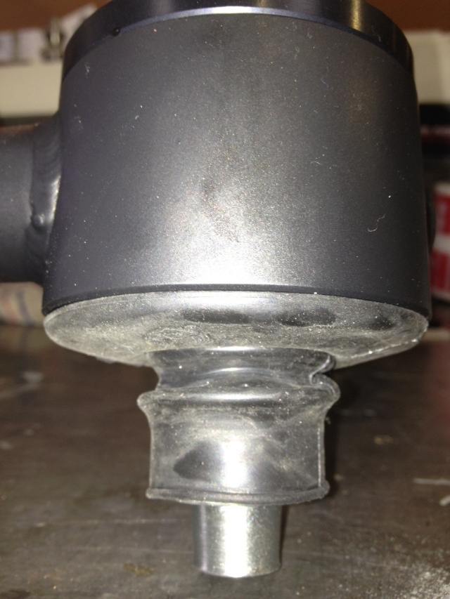

Uni-Ball dust covers!
A lot of people forget these are out there. Just do a search. Use the boot and grease it. Also as far as replacing them it is a matter of $30 each if you do your own work. These are the guys I use, cheap but last well. Had them on a jeep for 4 years (with the dust covers)!

Pic of the seals!
Here is an example of one of the seals.
