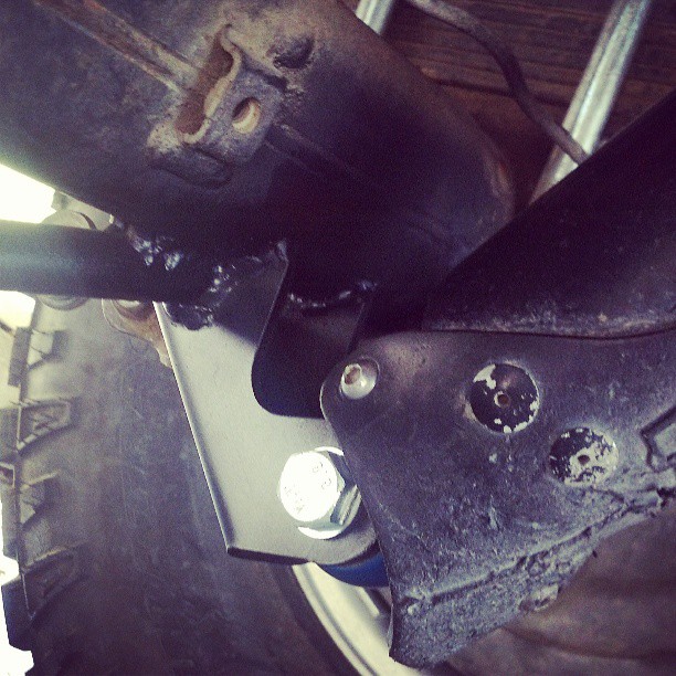

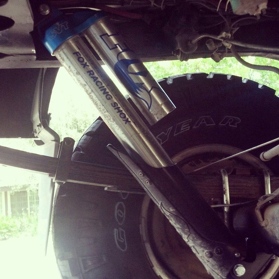

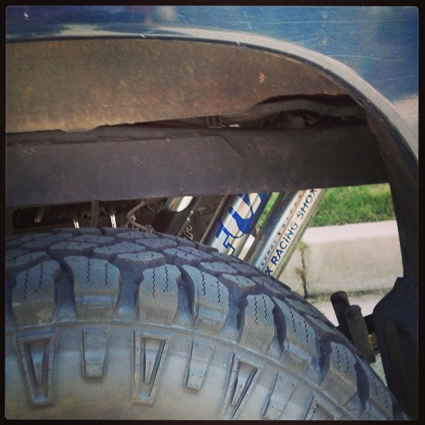

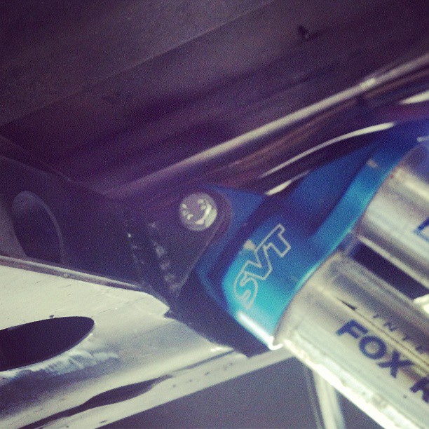

OK I finally got my internal bypass shocks installed! I have only run them on the street but so far they are softer over the small stuff and more controlled on the big stuff. I cant wait to get them out to a real trail!Name:  942537_575165299170921_414987815_n_zpsc97d02ae.jpg

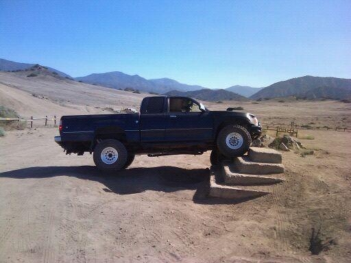

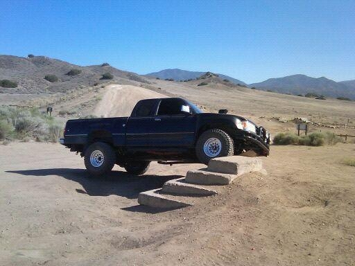

Sooooo I just picked up what I THINK is a Superlift 4" bracket lift from a guy doing a SAS. I also got upper and lower arms, rotors, spindles, torsion bars, steering, and shocks, he wanted it all gone. Lucky me! I get some spare parts
The front and rear drop brackets are one piece which means i will have to cut and extend them which should be really easy.
I think I will also weld a reinforcement bar from the rear drop bracket to the frame or somewhere, Like the procomp stage II kit. Best of both worlds as far as strength after im done with it.
This means 35s could be in my future in a couple years... But that also means I need to Regear and get a supercharger
I still need to make my rock sliders.
Am planning on using the stock shock bucket with some reinforcements for my coilover.... But now I have a shock hoop with no shock. What to do? triple bypass? Maybe just some hydraulic bumps and be done with it?
so much to figure out before I do anything.
