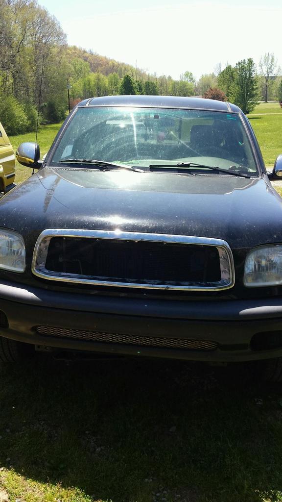

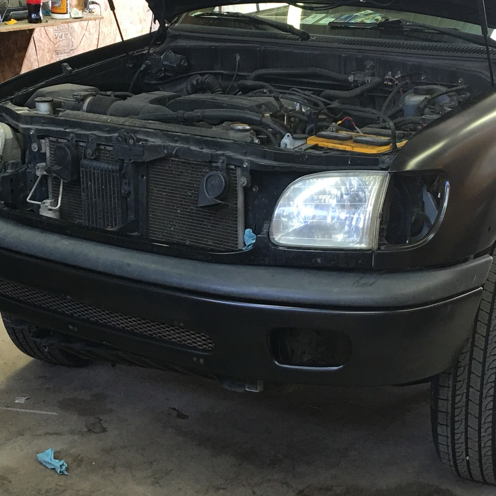

A few more
Old Mar 8, 2016 | 10:07 PM
  #783
Terrys87's Avatar
Posts: 11,787
Likes: 28
From: Anderson Missouri
It looks a lot better then it did sitting on your car hauler. Glad to see you getting it back together. Tires and bed cover look great on it.

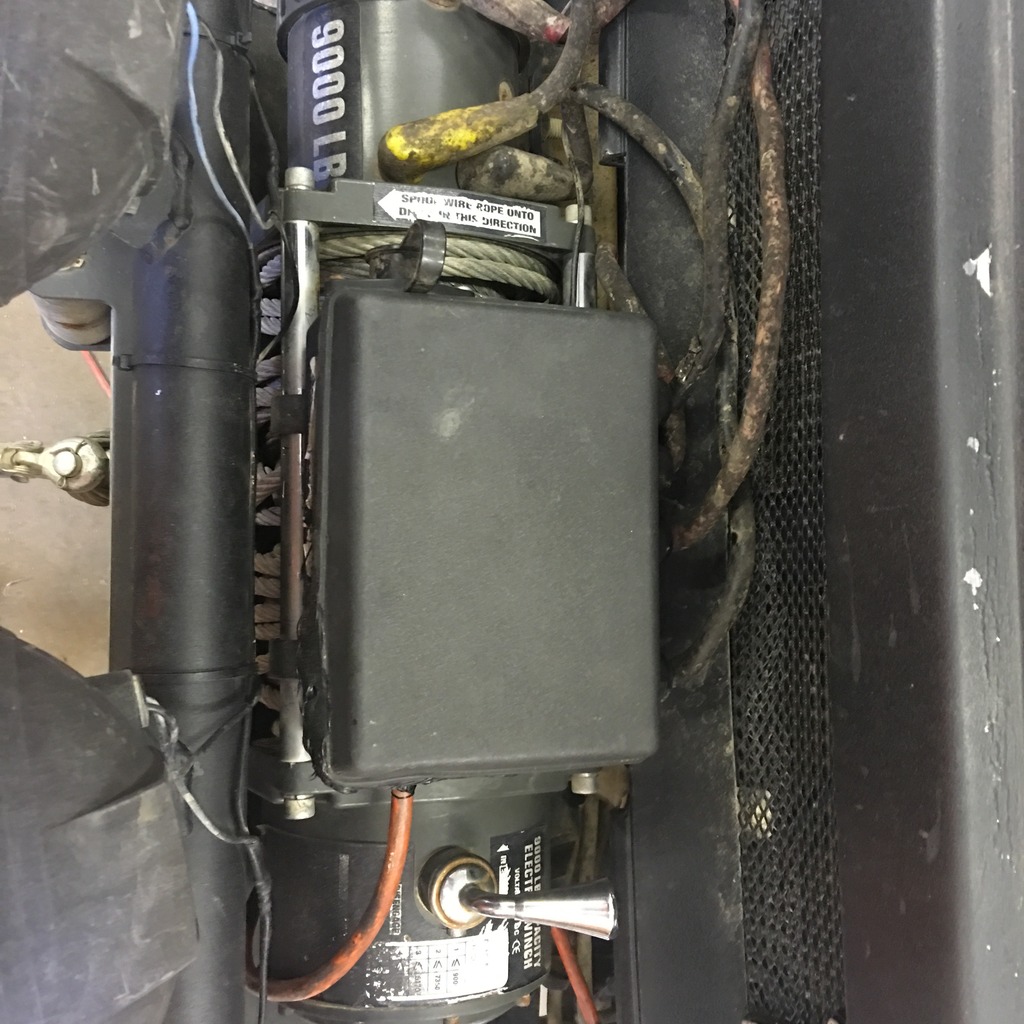

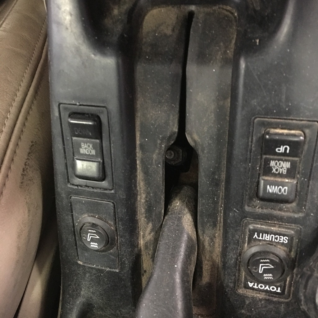

So because all winches are different I didn't take any pics of the wiring inside the solenoid box. I used an old extension cord I had laying around for the wiring, I pulled power for the switch from the battery lug on the solenoid, you could just as well pull from the fuse box but the thread I followed did it this way so it's what I did.
I used a safety switch to break the power wire, the switch on the right is for the winch, the one on the right is for an upcoming project.

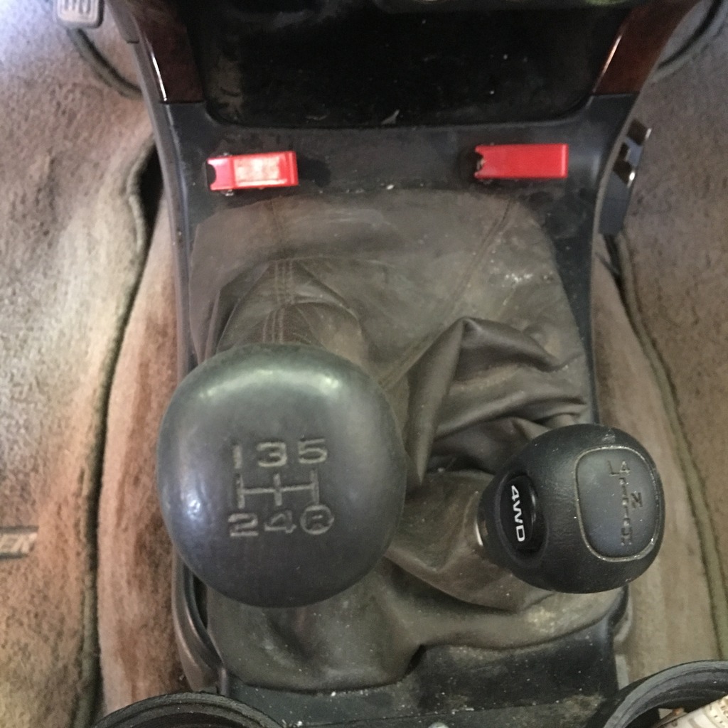

The hardest part for me was figuring out what wires do what on the window switch but with some guidance from a buddy that didn't take long. The switch on the left is the new winch control.
All pretty simple and I think it will be handy.

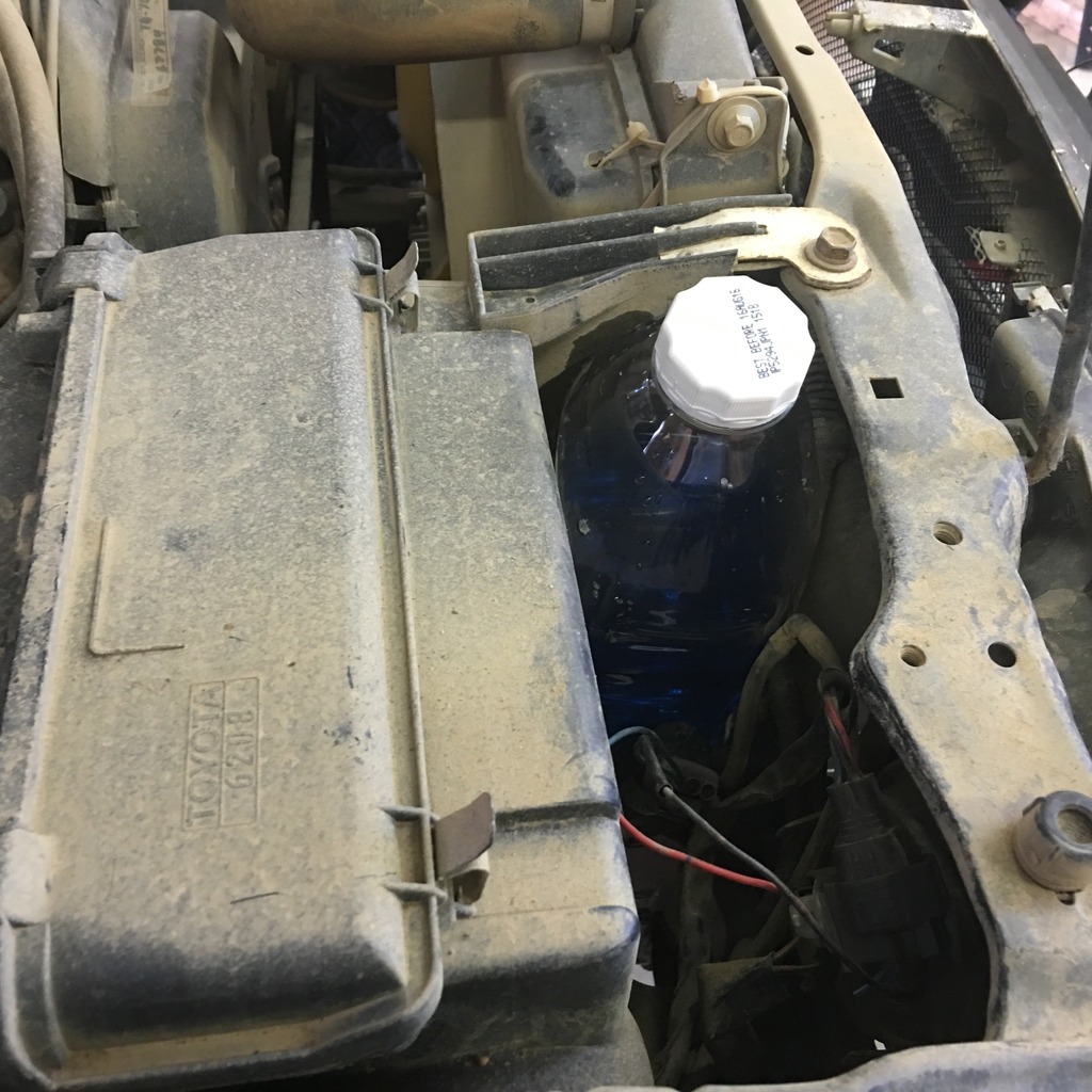

I also took a few minutes and finally put together a windshield washer set up, the original tank had to go when I went to 35s and it wasn't hooked up any way so I got the pump wired and working and used a 2 quart juice jug for a tank.
Seems to be working okay, I hope the bottle holds up. Anyway that's all, thanks for checking in.

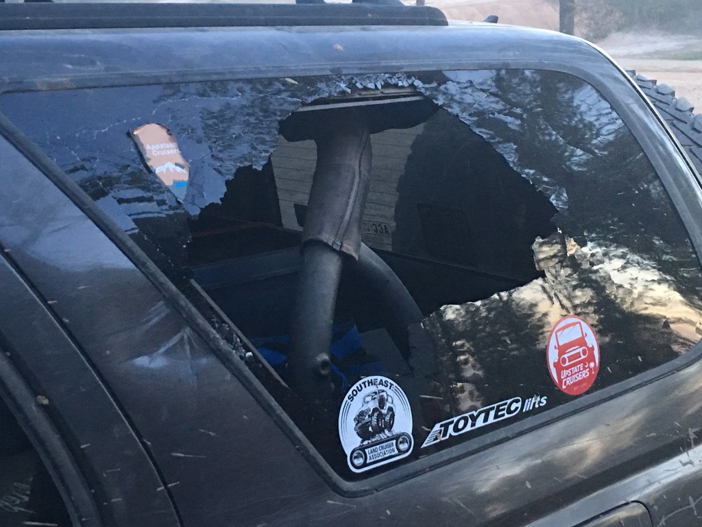

So over the weekend I attended an event called Mardi Krawl, this is my second time attending the event, overall it was a good time, I'm learning that off roading in a park probably isn't my thing, it seems that either the trails are hard core buggy trails or dirt roads but it is what it is. Nothing to exciting to report, oh wait how could I forget
Already have a replacement on the way but, €£¥*> I hate that it happened

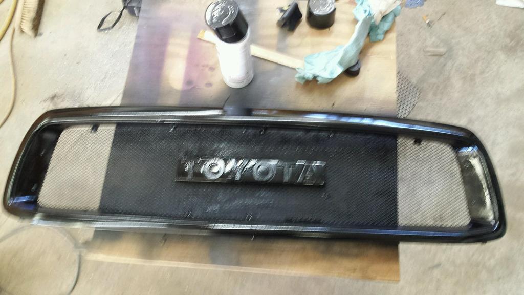

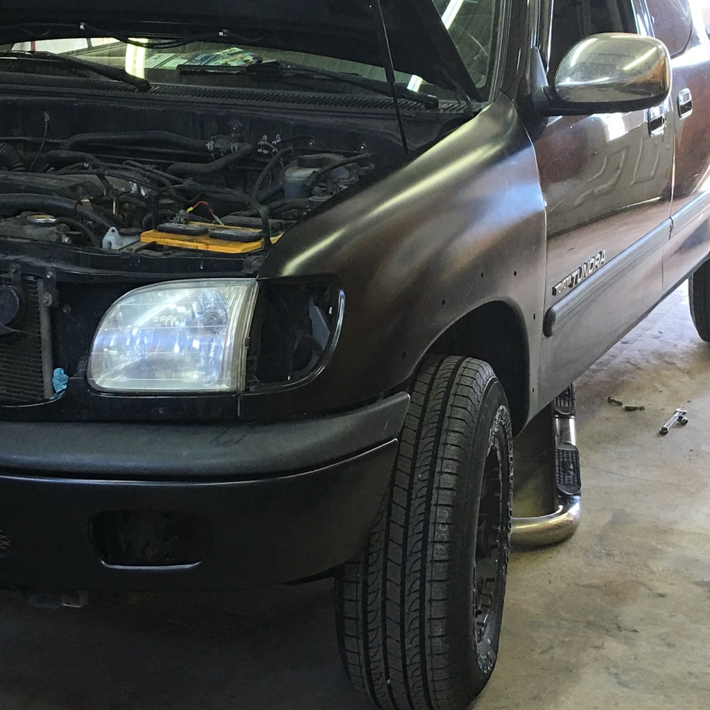

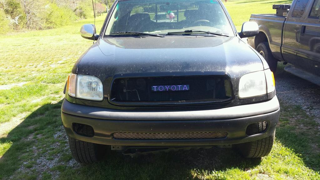

Little more work on the Tundra
The wife wanted some girlie colors so I'm going to do all the badges in purple, I think it looks pretty good against the the black.
