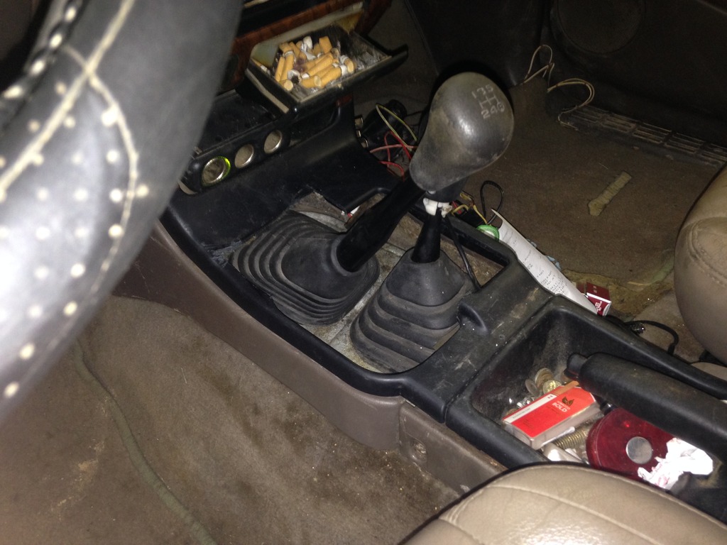

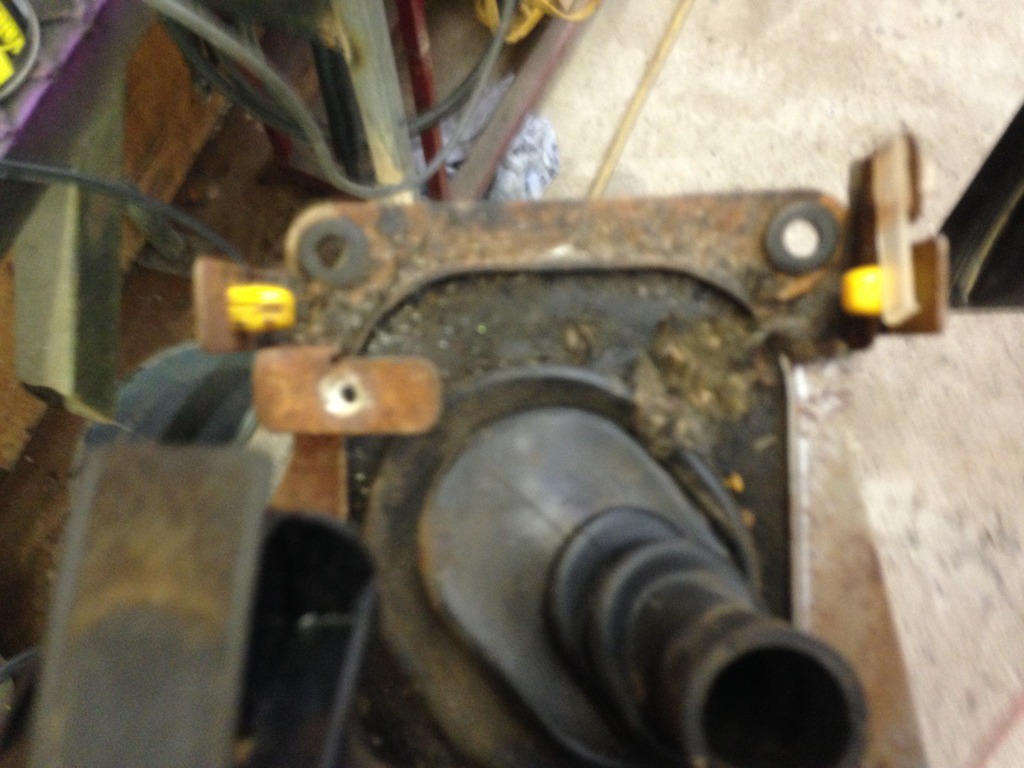

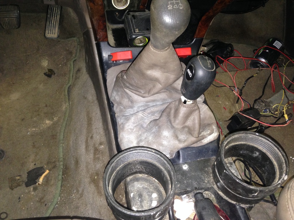

So now it was time to finish up the interior pieces and make this thing look like it belonged there.
I had grabbed a taco console and shifter boot, the boot fit the hole fine but the console was just to different with the curves in the runner dash, sooo I decided I would try and make the runner console work.
To start the console actually mounted to the auto shifter base.
So I cut off the bit I needed rather than try to fab something up
Cut roughly what I thought I needed to out of the shifter area and started test fitting.
Once I had it opened up enough I carefully removed the fake leather boot out of the taco console and started fitting it in the new opening, this did not come out perfectly because the opening in the taco console was much longer and narrower but I did the best I could with it.
The Tcase knob was not threaded it was designed to have a screw that went through the shift lever, I simply tapped that hole in the knob and put a set screw in it to keep it from moving. I'm sure I've missed explaining something and I know I don't have a lot of pics but if anybody wants to know more about this just ask and I'll be glad to explain more if I can.
Bottom line I'm really glad I went ahead with this swap, I'm excited to get it out on the trails and see how I do with it there.

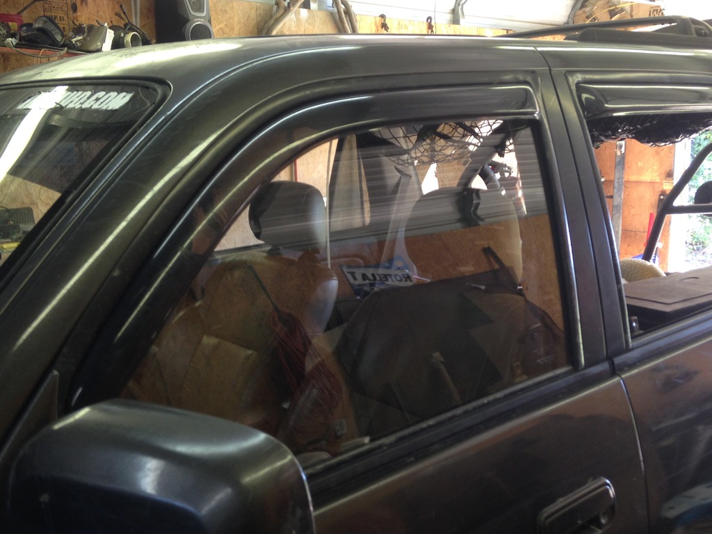

the tint on the front windows has been wrinkling with age, and its always made it diffacult to see out in the dark and in the rain etc, I like the looks of tinted windows but decided with the wear and tear and the other issues to just do away with it

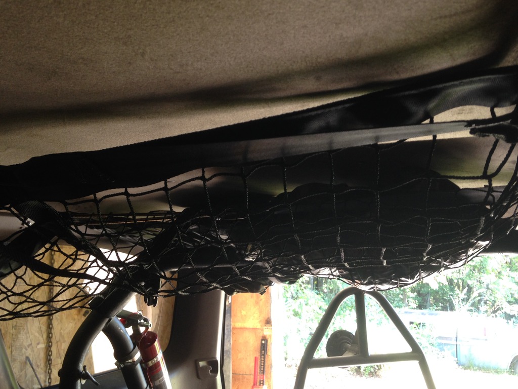

Ive also been trying to figure out some additional storage, just for lite stuff, I stumbled accross this cargo net and decided to figure out a way to use it, the pics n ot great but I think it will work ok for a freebie just my time to figure out how to get it mounted up.

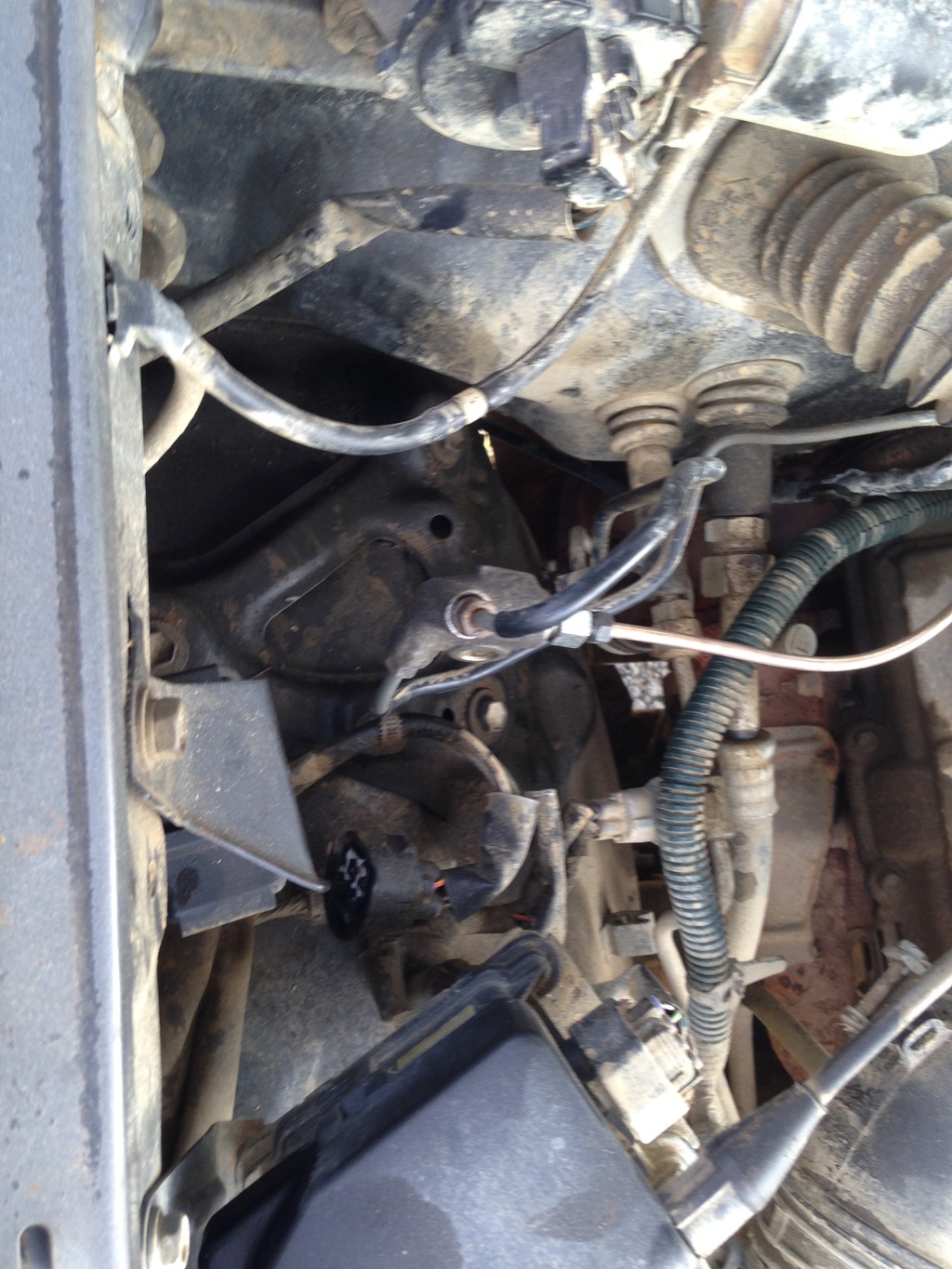

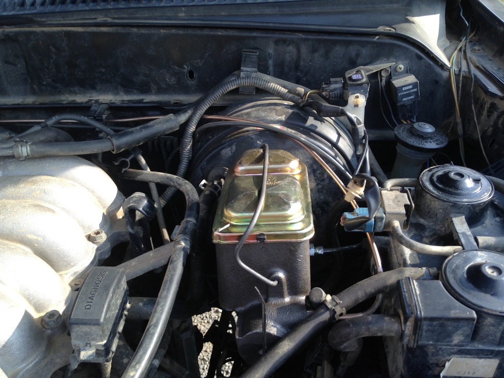

and the big project was for the umteanth time Ive tried to figure out my spoongy brake isuues, I spent some time doing reaserch on the issue and discovered Im not the only to have dealt with this issue, and found and unexspected master cylinder upgraded.
this master is off a mid 70s 1/2 ton chevy pickup, I was surprised at how easy it was to install, some slight modification yo the mounting holes, and removing the adjustment pin on the push rod and it slid right in place.
this empty spot is where the ABS control box used to sit, I decided after my reaserch to go ahead and remove it as well. getting the new master plumbed was the biggest issue and even that wasnt bad. Im happy to say that the brakes feel better now than they ever have, very solid peddle but not grabby, if they hold up I think I may finally have the issue solved.
I hope I have everything done up and ready to go because this is the last time I have to work on anything, the runner is sitting at a buddys house awaiting its turn to be loaded on the transport to be hauled to moab so if its not done its not going to get done.
anyway thanks for checking in, look forward to a ton of pics and vids from the trip coming soon.

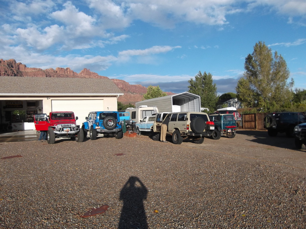

We drove out sat and arrived sun, two of us in the truck a couple guys in a car behind us and one guy flew into albaquerque and had to be picked up.
We based camped at a place called "GRANPAS GARAGE'. If you're not familiar with the place or the owner DANNY GRIMES google him he is an awesome person and supporter of the off road community, not just trucks but bicycles, hikers, rafters, you name them they are welcome at Dannys.
Some of us stayed in tents some of us slept in the house some slept in there trucks but everyone had a shower avaliable as well as a fully equipped shop to work on broke trucks, an awesome patio to hang out on and a man cave to hang out in when it got chilly at night.
