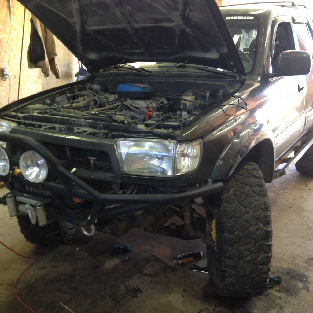

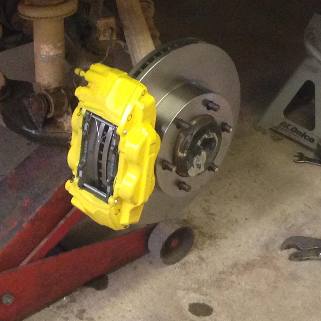

spent some time working on the runner today. finally got around to doing the tundra brake upgrade. I have to say I was expecting more, it may be that I have bigger issues than I thought but I didnt notice any difference. Im still planning on doing disks on the rear and I hope that with these new fronts I may finally have good brakes.

I have a couple new noises to track down as well, a real bad whinning coming from the front of the engine and a growl, Im guess a couple pulleys now have bad bearings but not sure which ones. anyway thanks for checking in everyone.

Weird not better braking. New fluid all around even? Rears properly adjusted? I know, of course but it's the only questions I can think of. Can't say I noticed much difference (other than not warped and pulsing) either, for regular braking. I have noticed a non-return of the warpedness, seemingly shorter harder stops and better stopping while towing.
Can you carefully check the alternator and power steering pump with a stethoscope or pretend stethoscope since they're right on top and still stay safely away from pulleys and fan?
I like the yellow!

Hab this thing has fought me from day one as far as brakes, I pulled the drums today and it could use new shoes "again" but at one time everything was new and it still had a spongy pedal, and lack luster stopping. I adjust everything up, bleed the system and the work good for a few days and then back to same old same old. To be honest they probably are working better I just expected a lot more.
First time I've ever painted calipers, I thought is give it a shot, already had the high temp yellow, glad you like it.

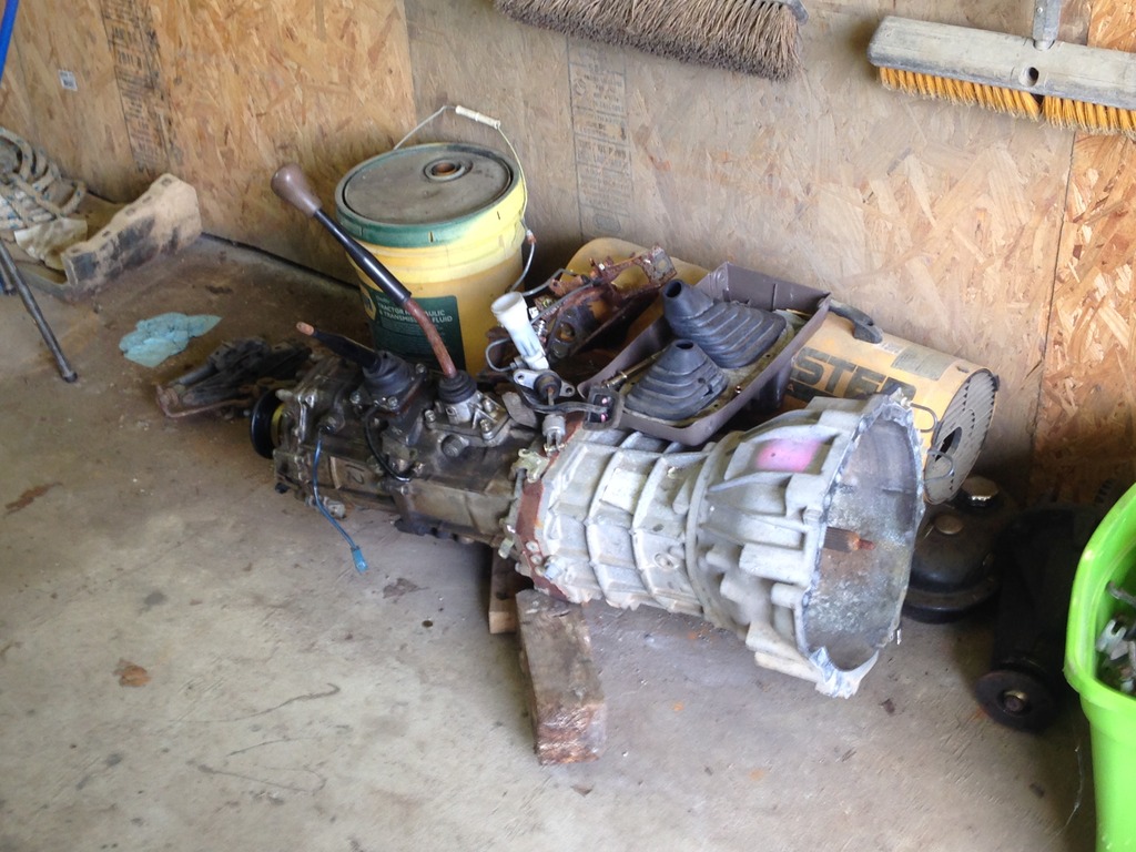

Ok so here's what's coming
I have toyed with the idea of a 5 speed swap for a long time but had always talked myself out of it, I decided if/when the auto gave up I would dig into it then, well after my last wheeling trip I was forced to start thinking about it, the auto over heated twice to the point it wouldn't pull and the fluid is black.
I've been doing a lot of research on this swap and although it's going to be a lot of work I think it will be worth it in the end and so far I'm coming out cheaper than rebuilding the auto.
I've already got a new Asian clutch kit, LUK flywheel, trans and Tcase, pedal assembly. There's a few things I still need to gather up but its getting to be a fair pile of parts.
I've enlisted the help of a buddy of mine too help with the wiring side of things. It's probably going to be a month or so but it will be starting soon so stay tuned.
