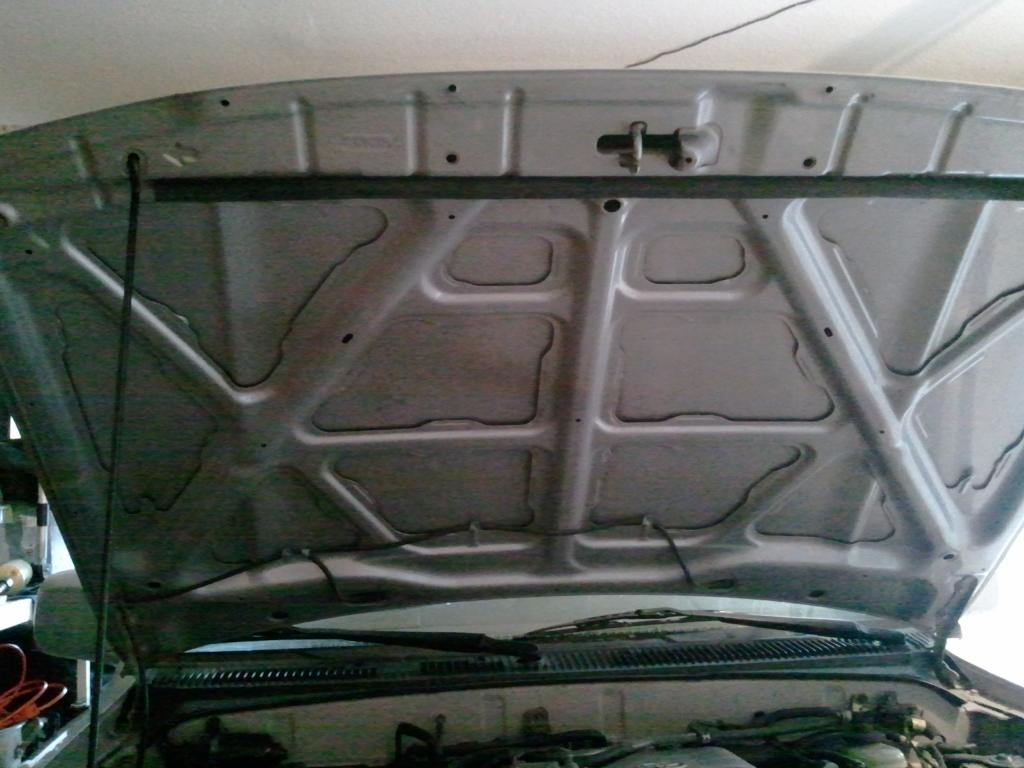

Originally Posted by habanero
You didn't happen to get a glance at your underhood sticker, did you? I'm curious as to what yours says. It's been said the 96- mid 99 aren't separated Cali and non-Cali, though when I buy emissiony stuff I have to specify.
It should about smack you in the face when you open the hood and look up, it's about 4x5" or so. There might also be a vacuum hose routing guide up there too.
And thanks!
no wonder I never noticed it, this is the underside of my hood...

HA! You're NAKED!
Well, thanks for trying. Maybe someone with a non-cali 96 will throw something up on here....anyone?

at least I won't have to worry about transferring and/or matching stickers whenever I end up converting to the purely aesthetic sport hood with non-functioning scoop!
