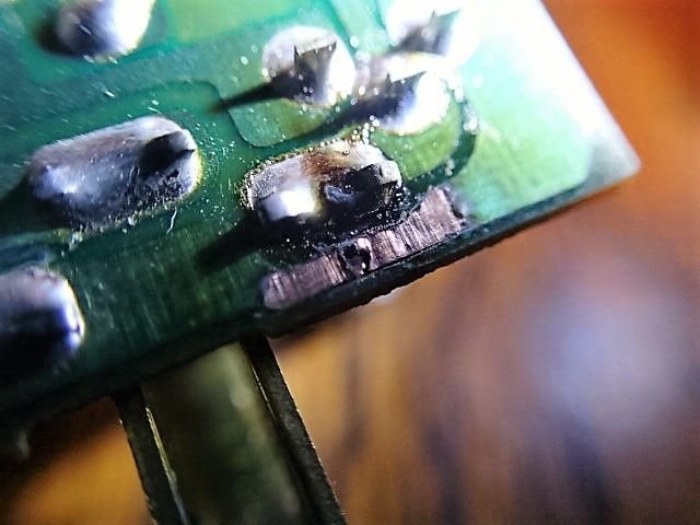

Found a bad spot on the dimmer switch...prolly something I did to it while I was playing wiring games, from what I've read most likely managed to overload the ground circuit on it. For reference:
white/black = ground
green = 12v power
green white= power to dimmer
This is the innards of the dimmer switch, specifically the circuit board attached to the plug.
So the little copper strip at the bottom of the board has been disrupted. This is supposed to go to ground. The discolored soldered bit above it comes in from the white/green wire. Both are damaged. If I jumper those two the dash lights work but obviously not the rheostat since it gets bypassed.
Now deciding how I want to do this...try soldering to repair the weak safety link in the dimmer? It does still have the 15a fuse. Junkyard dimmer earliest is maybe Monday, it's supposed to ice today, Saturday and Sunday, but just rain on Monday.
Hmmm, maybe play with dimmer after getting continuity back until I've got it all right, then replacing with junkyard one. My bad for playing with live wires and loose grounds, I believe. Too scattered in the mainbrain, not methodical and careful enough. What did Nervo19 say? Twitchy!

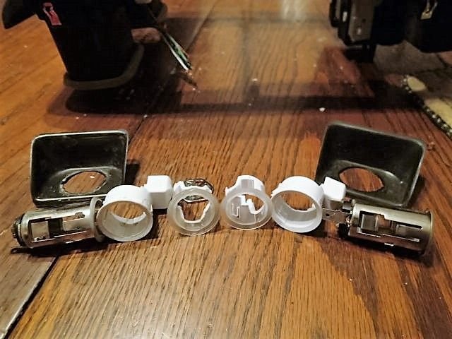

Got a new old dimmer and it's working perfect. Also got some lighter socket surround lights. All of those are not working perfect. Ah, well, lets play with this.

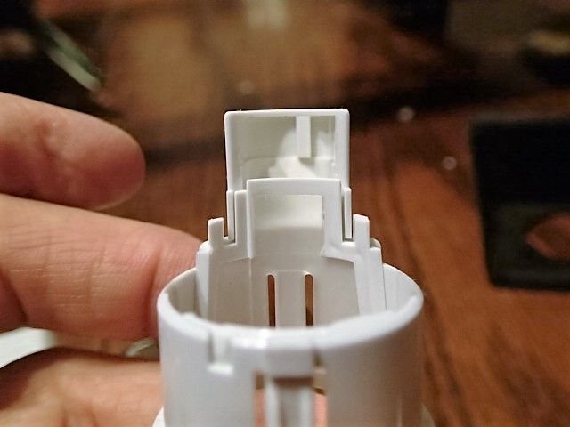

The light is all one piece, the bulb doesn't come apart from the base.
Well....isn't supposed to come apart from the base....there are two tiny tabs that release the posts from the base. The bulb's wires are soldered to them.
And one lighter surround lamp, deconstructed.
Now to find a matching bulb or ???
Looks like there's still a Radio Shack around, time to take the old bulb in and find something usable.
2721092 ?

Well Jason, I managed to introduce an outside ground to my dash light wiring because I'm a butthead. That burnt up my dimmer because that's where the ground is supposed to be. While I had that stuff apart I decided to redo the coloring on my key surround because it was too dull (red). Then I looked at the lighter surround and decided to color that (red too) but then I noticed the bulb was burned out. While I am in there I am moving my gauge light wiring over to the aux start battery fuse block, as well as the wire for the start battery voltmeter.
Anywho.
Got to do a junkyard run in the rain (yay), found a usable dimmer and that's all good. Also found a bunch of non-working lighter surround lights. Glad the guy just gave them to me.
Still want a working lighter surround light (and to see how the new color looks) so I've pulled one of the bulb/base deals apart to see if I can find a bulb that I can solder in. This is NOT a pop out bulb, if you try to the bulb will break unless you release the blades first, you likely know, but not all do, so I'm putting that out there.

Finishing up a couple of things today. One is to change the color of the lighter surround. It's red. All I did was take the socket assembly apart and change the bulb window color, plus colored the underside of the surround that you can see. Pics of the effect once I get the mess all back together.
Random pics...
Bulb illumination window. The release tabs are on either side of the window.

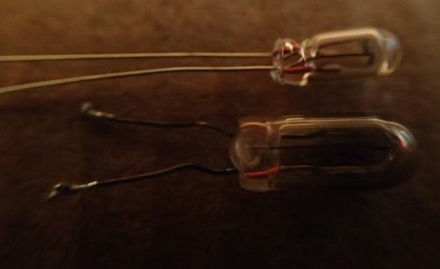

Also repaired the socket surround light. It's an assembly, the bulb does NOT pull out as it normally does in other sockets. I pulled the assembly apart to find a 2 pin bulb soldered to 2 blade terminals.
deconstructed, de-soldered:
Found a bulb (2pk) from Radio Shack for $1.99, 12v 1.4w
The new bulb is tiny! The old one is the size of a #74 but missing most of the base......that could be something to explore if this doesn't work out. I can tell you a regular #74 is too long.
