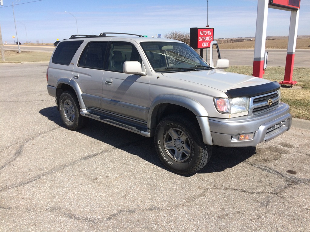

Here is the first time I saw it.

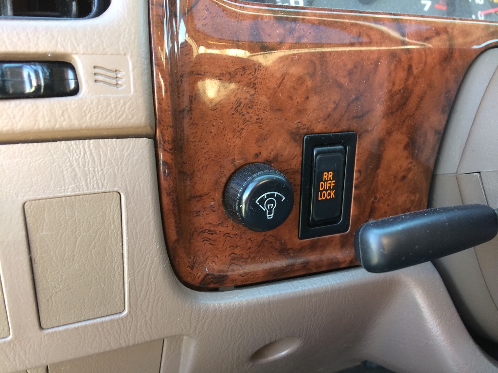

Confirmed the Locker

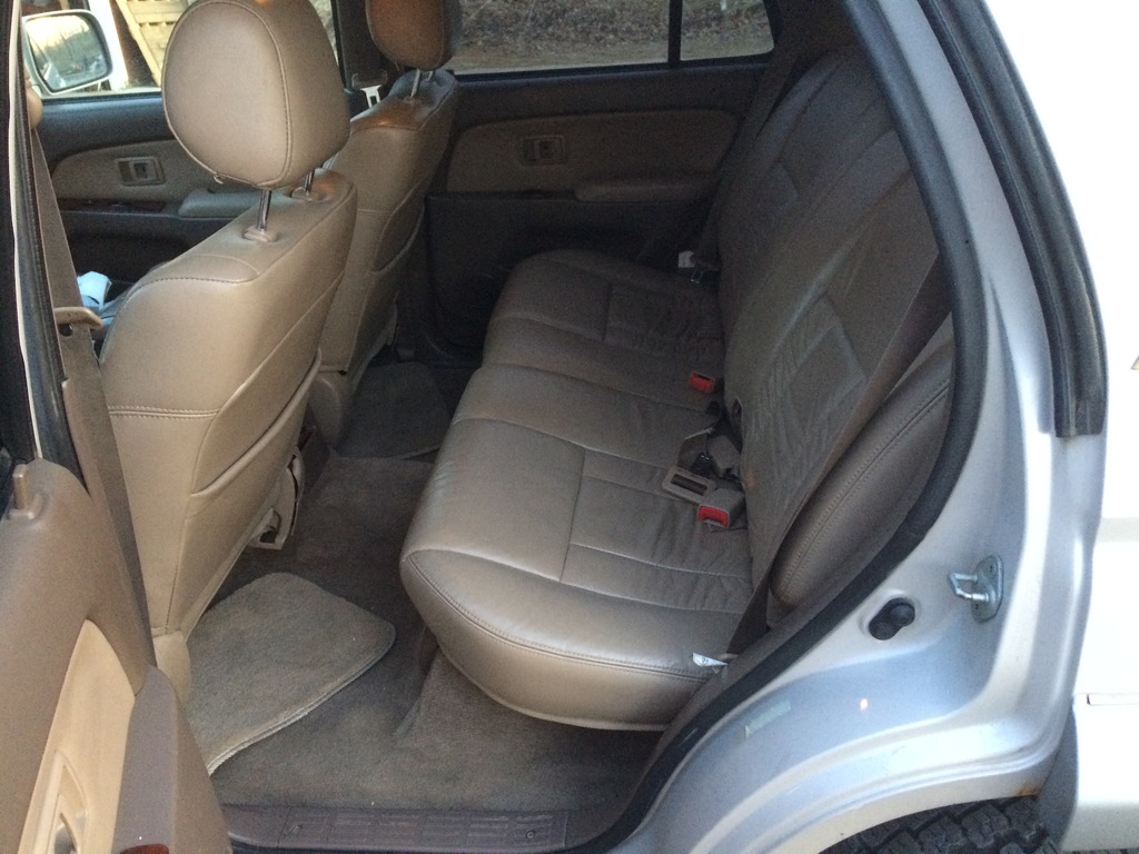

Some Interior shots

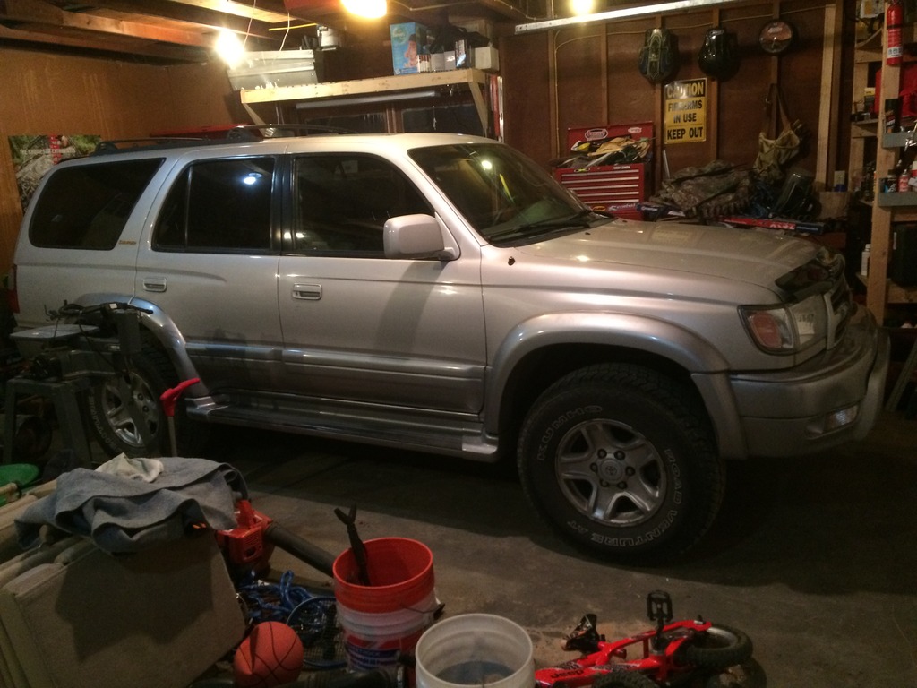

First night in its new home.

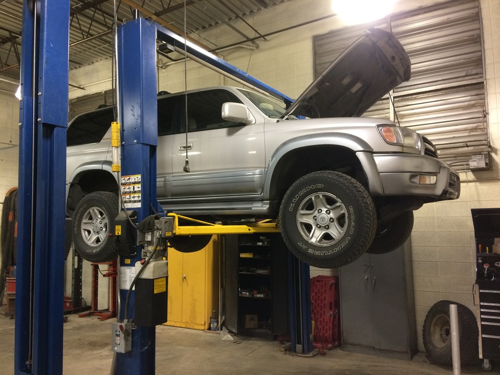

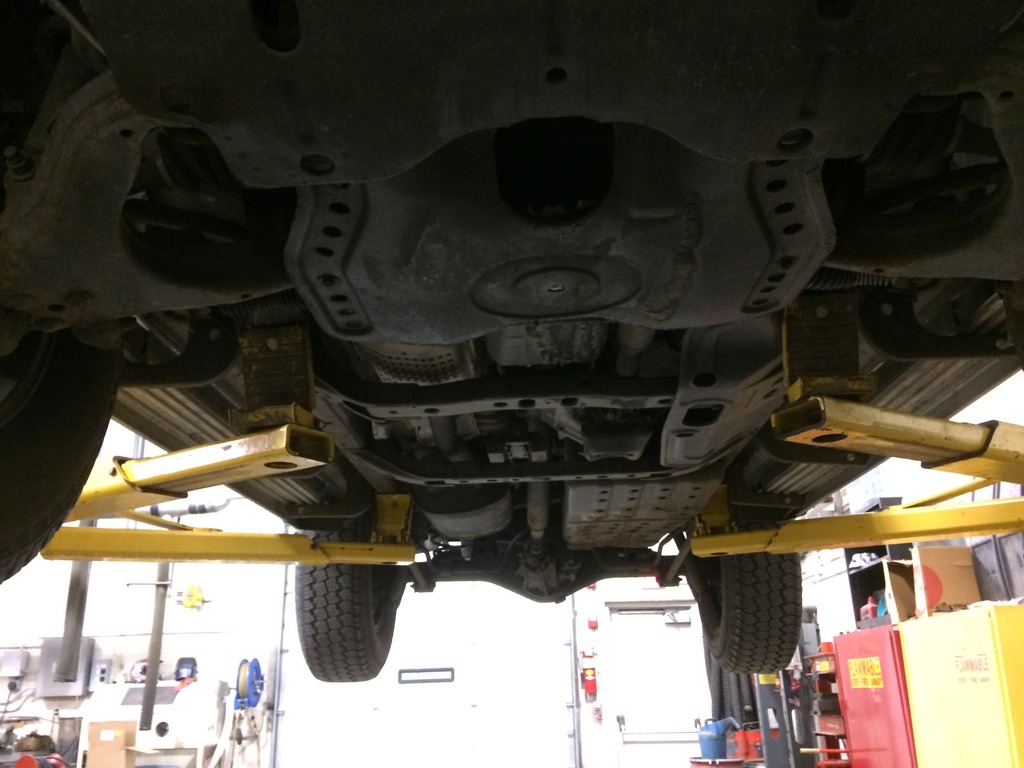

Got it up in the air this morning to confirm that the frame was as solid as it looked on while on the ground.
I still cant believe how clean it really is. Definitely needs some stuff here and there, but I think its a great base to start with.

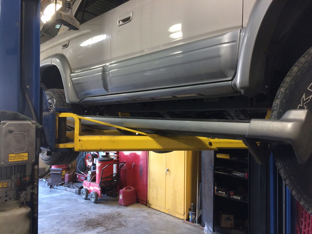

Just did a quick once over it yesterday while up on the hoist.
Changed the oil, and looked over the brakes. They are not too bad. The ball joints are original (still riveted in) and will be getting changed in the near future. Shocks and struts are also original and beat pretty bad, so I am saving for some OME coils and strus/shocks. THen most likely going to go with 285's of some sort.
I really want to set this thing up to daily drive, and to weekend wheel/explore.

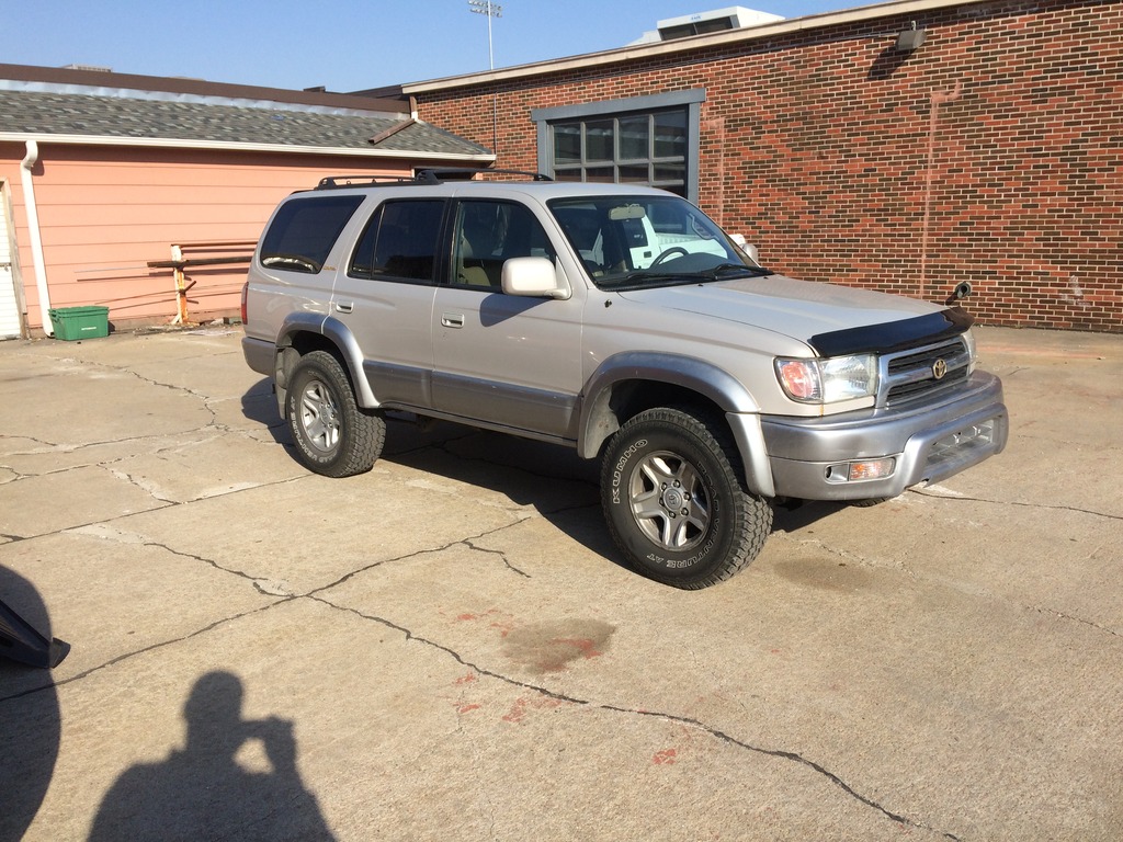

First order of business after the oil change was to remove the rust forming running boards!
I think it looks way better without them.

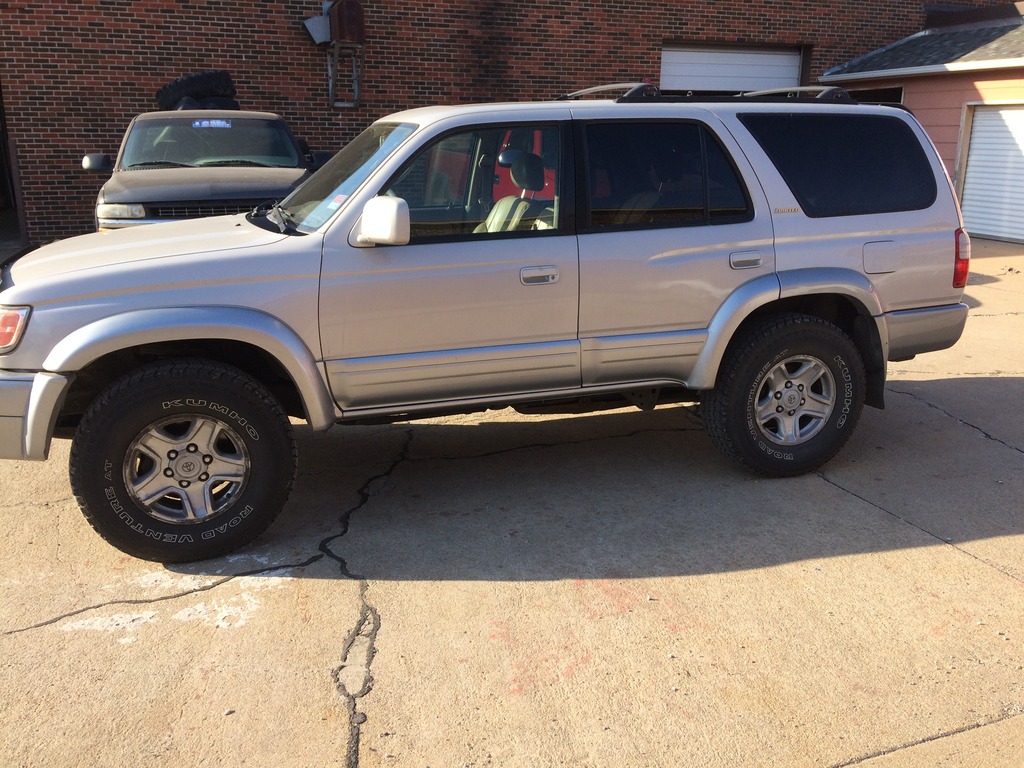

Gave it a bath after the kids and I got home.
Boy is it nice to be able to pick the kids up from school in this. We even went for a little ride last night. I think they like it as much as I do!!

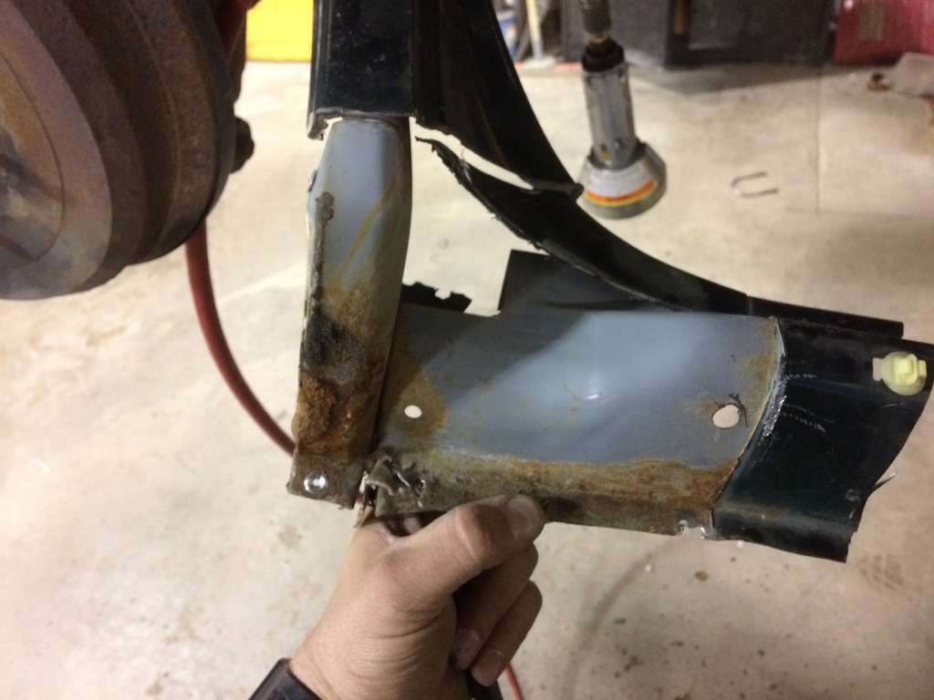

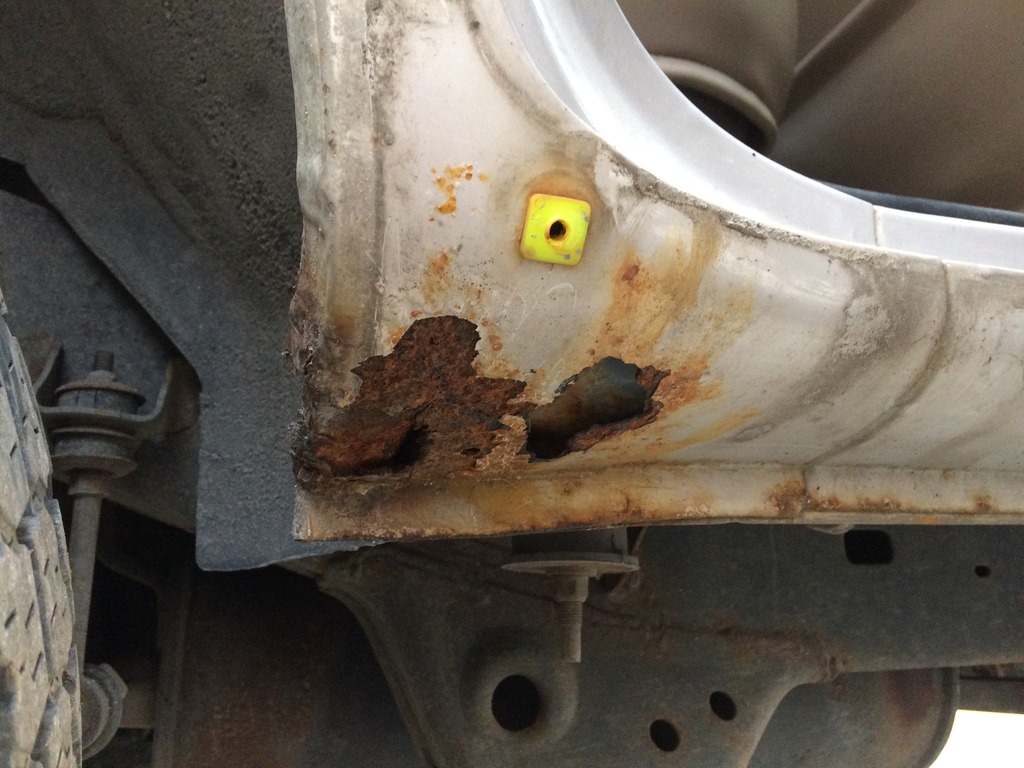

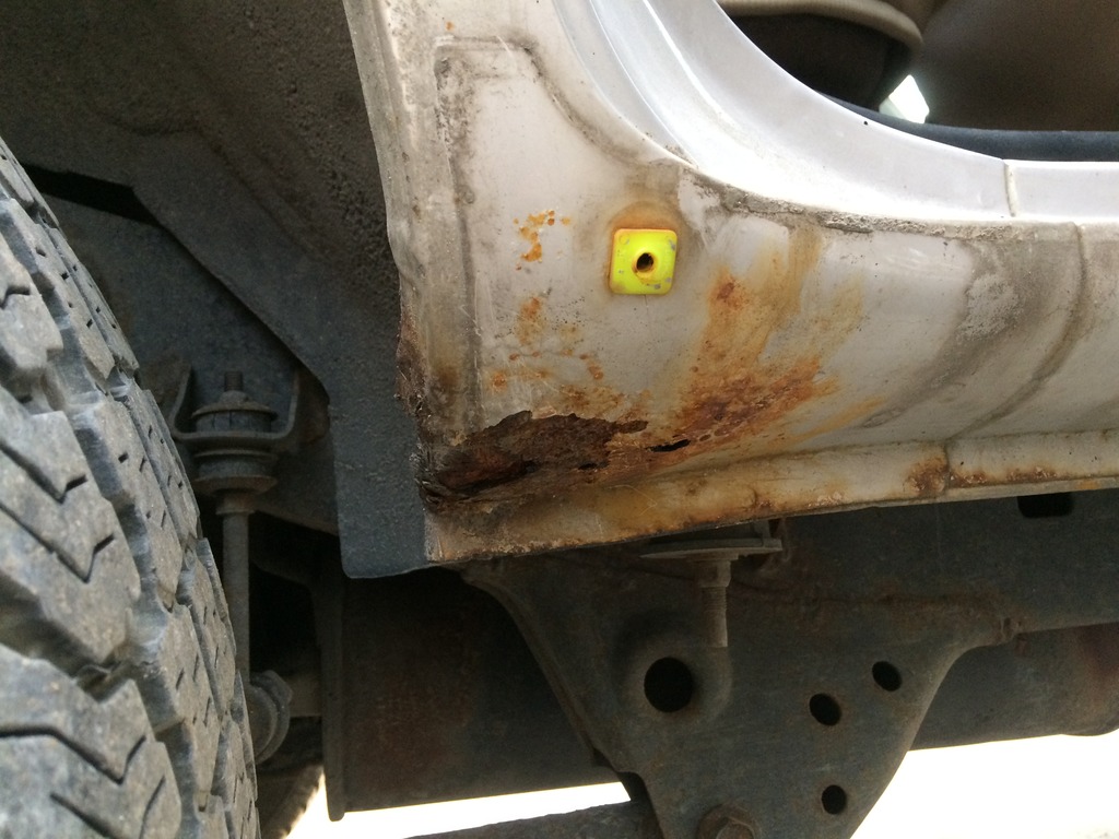

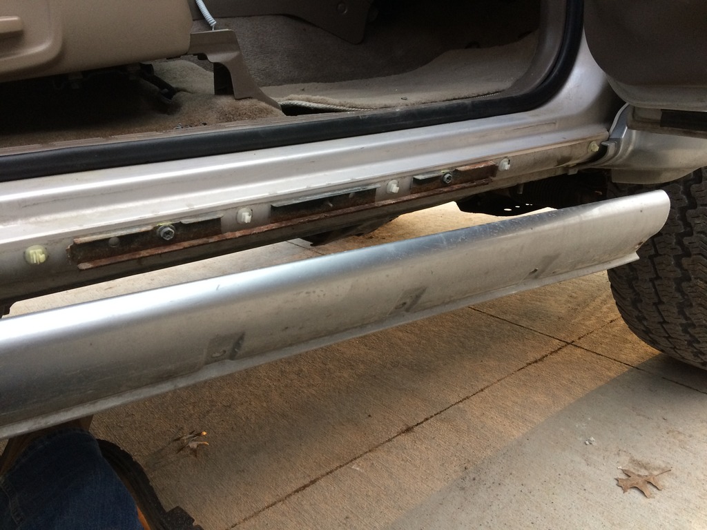

So.....I decided to do some investigating. I knew there was one spot of concern for rust. Right in front of the passenger rear tire.
I started to Remove the rocker trim

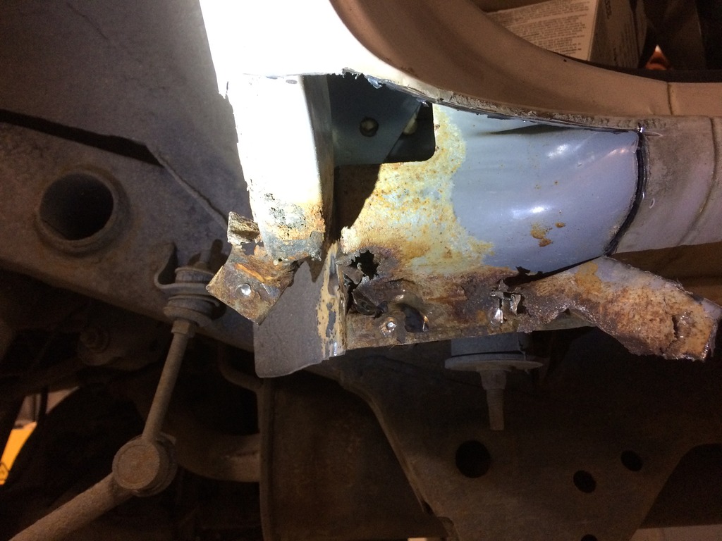

And I discovered some scale. At first glance, it was just bubbled paint, then I started to poke around with a Screwdriver to open it up.
Glad I found it now while its still small.
Lesson here fellow Yotatech members. If your 4runner has the plastic flares, and rocker trim, it could possibly have some rust under there.
When I pulled the rocker trim down, it was full of dirt and a ton of crap.
If I could easily remove all the flares and trim without having to fill a ton of holes, I would. They are just safe havens for rust to start.
Anyhow....... I am planning on tearing into it on Thursday. Cutting out the bad, making a new panel, and welding it in. I an going to use some Fusor 2-part seam sealer on the seam near the tire, and most likely use some duraglass on the patch after its made. then ultimately paint and reinstall the rocker cover.
Just a heads up guys and gals.

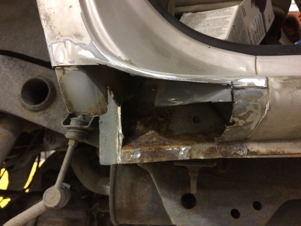

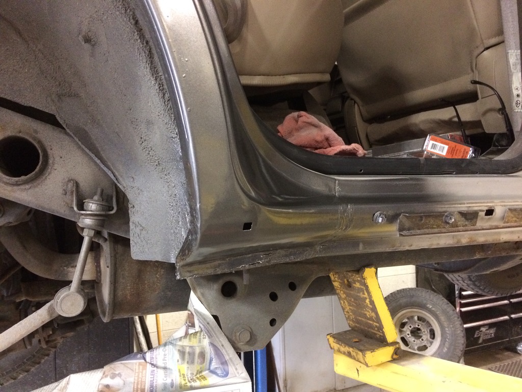

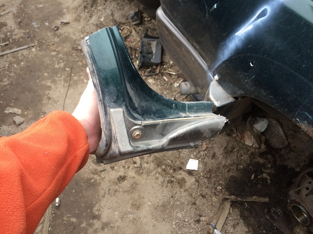

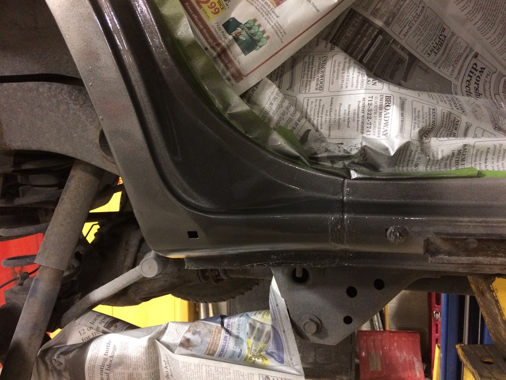

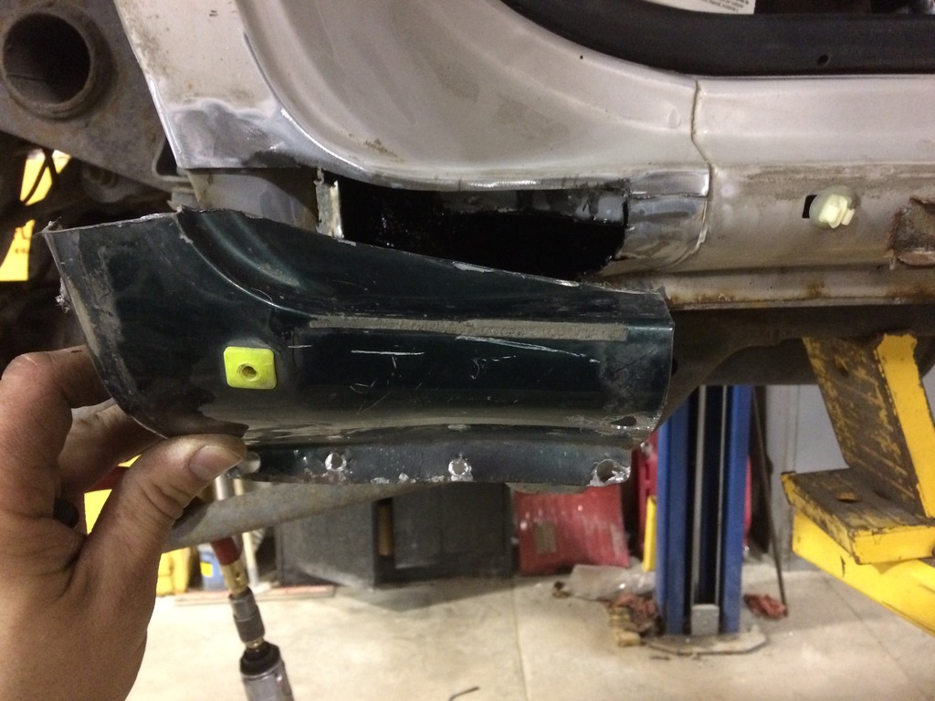

So I tore into the rocker and was able to get it taken care of in two days.
Yesterday morning I went to my local U-Pull it and cut off the section that I needed. 5$ Pretty good deal.

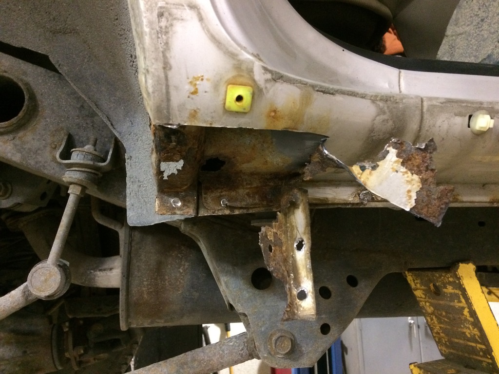

Then I came back and went to work cutting everything out.
Once I cut the outer out, it exposed the rot on the inner. So I cut that out also.

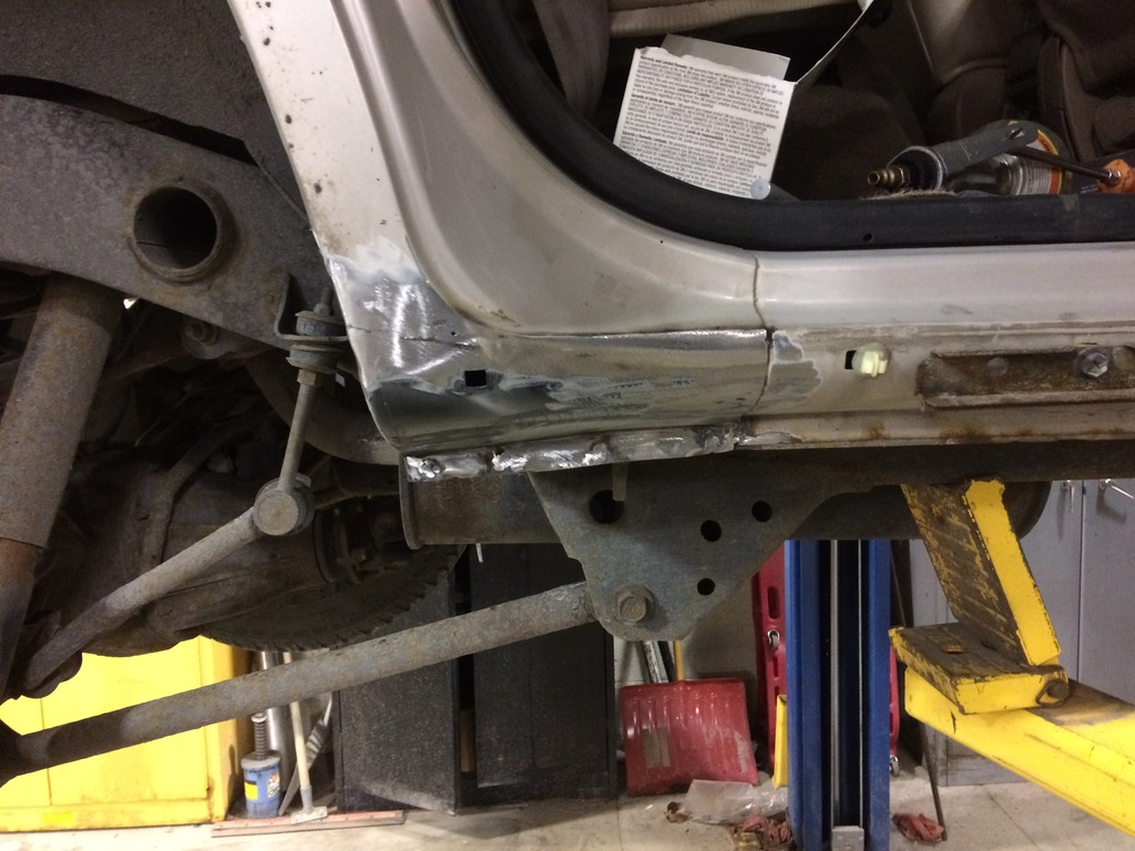

Then I started making my patch panels to plug weld and stitch weld in.

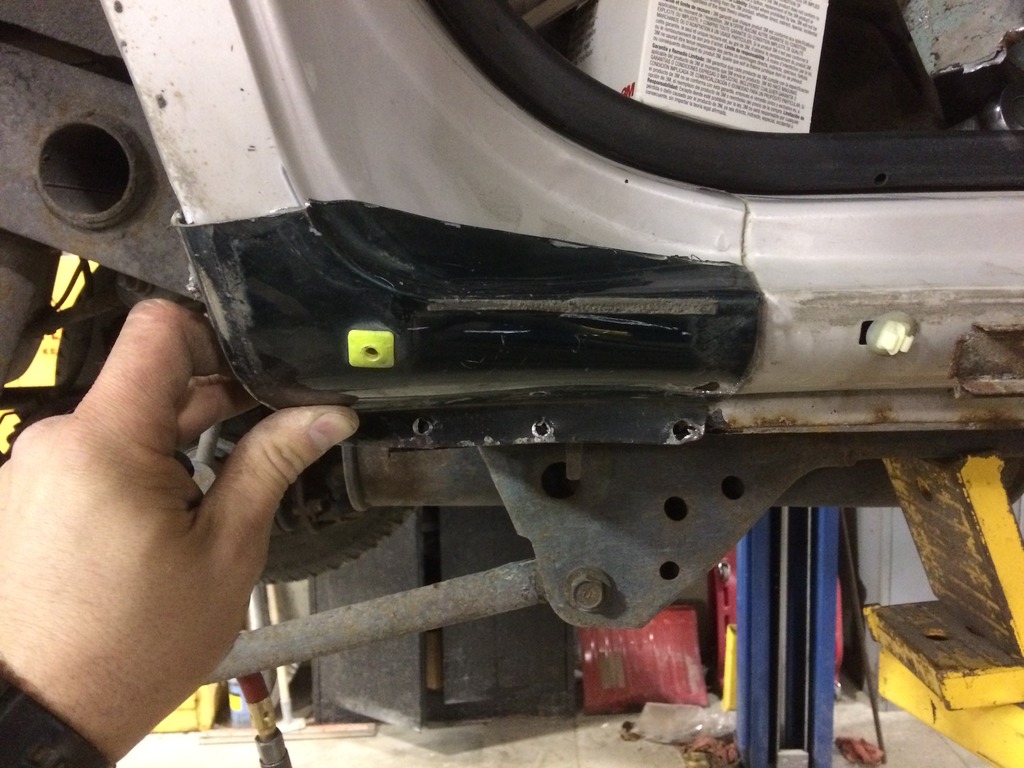

Got it all welded in and ground down.
Then I put some Duraglass on it and smoothed everything out.

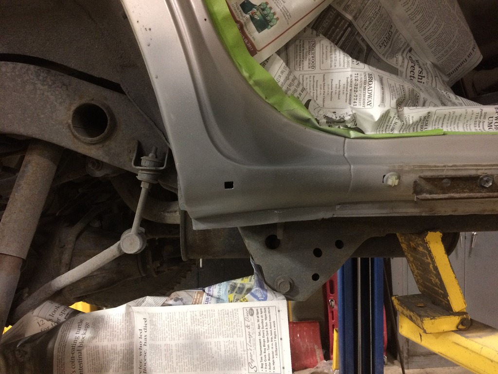

Finally was some seam sealer and then Primer and Paint. I decided to use a puff can I had left over from my 4Runner. It has base and clear in it, which is perfect for stuff like this. Color doesnt match, but the door covers it up. I will cover it with the right color eventually.
When I was all done, I thought that it looked weird with a drop/dip down in the rear. I figured it was a result of the patch not sitting perfect. But I went over and looked at the other side and its the same way. I never noticed that it is shaped that way. The rocker cladding covered that.
So, I have decided to get some new clips from Napa, and i will be reinstalling the rocker cover in a few days.

I would be willing to look around and cut something off to send to you, if you are having trouble finding one.
Let me know if you have any questions. I would be glad to help.
