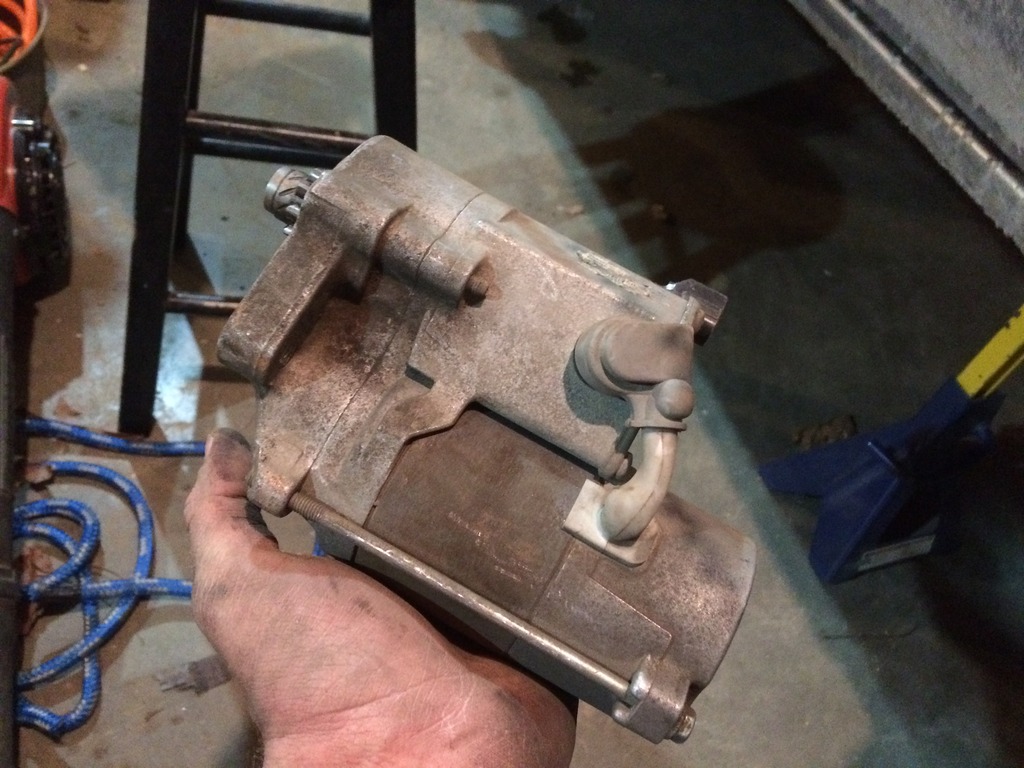

So a week after getting this runner, the starter started to click upon cranking, leading me to realize that it was time for some new contacts. Unfortunately my local Auto/Electrical place has since closed up, I had to order them online. I really wish these places were still able to survive in todays throwaway society, but its just not a reality.
I had already become familiar with this procedure while doing some work for a friend a few years back. I remembered that the hardest part was getting the starter out of its "hole" once unbolted.
Everyday I have the opportunity to work at the shop where I teach. Its nice and climate controlled, has hoists so you can work in the air. But there is Usually something lacking when working like that. Might sound crazy, but for me, sometimes taking on a project at home, on the ground, builds a better connection with the vehicle. Maybe I am crazy, maybe I have been using a hoist so long that I sort of missed doing some repairs rolling around in the dirt.
Fast forward to yesterday.....The starter became more and more unreliable because of the contacts. Since I already received them last week, I just had to find the time to make it happen.
Its been a rough few weeks at work for me, and our lives are crazy with our twins, so..........I kindly asked the wife if she was ok with me tearing into the 4Runner after the kids went to bed.
Lucky for me, she was good with it. I think she realized that I needed some time to just do nothing but think about the task at hand.
So.......I put her up in jack stands and went to work!
As always.......This repair job can seem very intimidating to some. Especially if you are not very mechanically inclined.

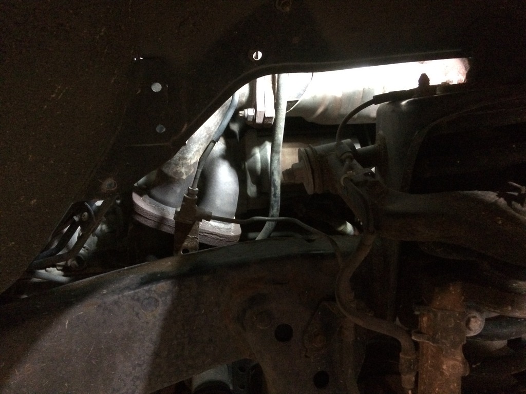

Here it is. Hiding, Lurking behind everything in its way.......
First thing you need to do is disconnect the battery. You always want to do this, but especially on this job. You will have to snake a wrench, or 1/4' ratchet in there, and I can guarantee that it will arc off everything around it if the battery is still connected.
Next you need to remove the 12mm bolt that is holding the Transmission dipstick to the head, then gently twist it back and forth until it comes out. Then you need to remover the 12mm bolt that holds on the brake line that goes to the passenger wheel. Some people remove this line and open up the brake system. I just bend it out of the way. Removing the line just makes more unnecessary work that does not need to be done.
Now, you have to remove the 12v supply to the starter an the remote line from the ignition. I ended up taking the remote line off after the starter was unbolted. I just simply could not get my XXL hand in there in such a way to remove it while bolted to the block.
After you get those two parts removed, you can them move underneath the truck to loosen the two 14mm bolts. I ended up using all 1/2' drive sockets and ratchets to remove these. I know some people remove the bracket that holds the exhaust downpipe, but again.....I do not. Just more unnecessary work.
It took a shallow 14mm with a swivel, and a few small extensions. I was able to use a breaker bar to pop everything loose, and then remove the bolts with my fingertips. The top bolt takes a little more work. I actually used a 1/2' Breaker bar with a deep 14mm socket and broke it loose from the fenderwell then moved back underneath to hand thread it out.
Now..........The hard part. Its like trying to figure out a rubiks cube!! I always forget how it comes out and have to mess with it for some time. About 25 minutes of hand wrestling it in the frame rail, it finally gave up and decided to come out. I failed to get pictures of this, if I only had a third hand or a photographer...... Haha.
But, it has to come out with the actual starter motor facing down and the solenoid straight up. It seems as though it will not fit between the UCA and the Manifold flange, but I assure you that it will.
Once you have it out, it will literally take you 5 minutes to swap everything out.

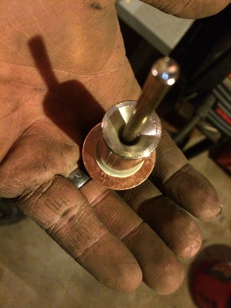

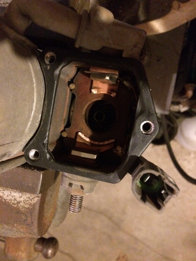

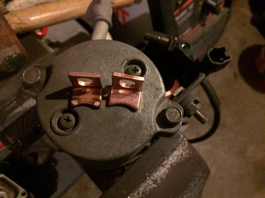

I just clamp it in a vise and go to work. There are three Slotted (phillips) head screws that hold the solenoid cap on. These are usually on fairly tight, but if you put the screwdriver on and give the end of it a quick hit, or two, they will break free from the shock.

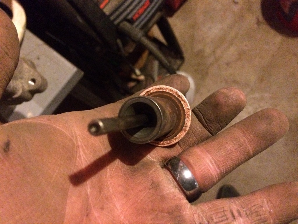

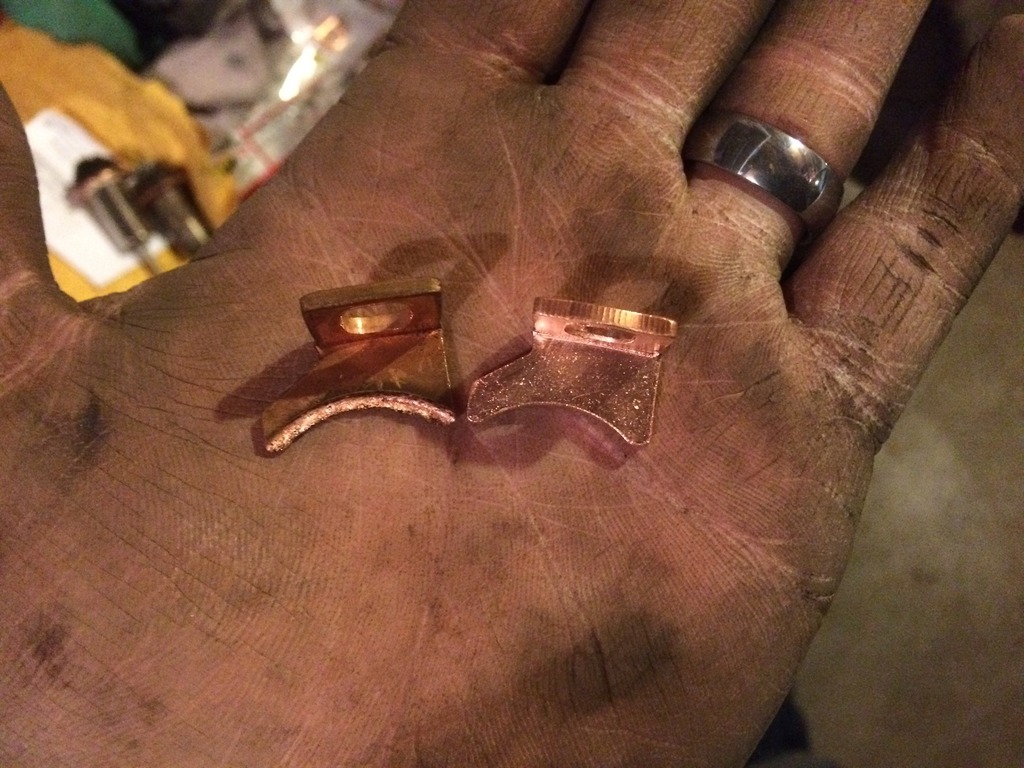

Now that its off, you can see the plunger and the contacts. Sometimes they look so back its crazy, and other times, like this time, they do not look horrible....but bad enough.
You can clearly see the difference in from the old plunger to the new, and then i have some side by side comparisons of the contacts.
The contacts simply unbolt from the side of the solenoid housing. Be careful and take note of the washers and all the plastic parts that fit on the studs to seal up the solenoid.

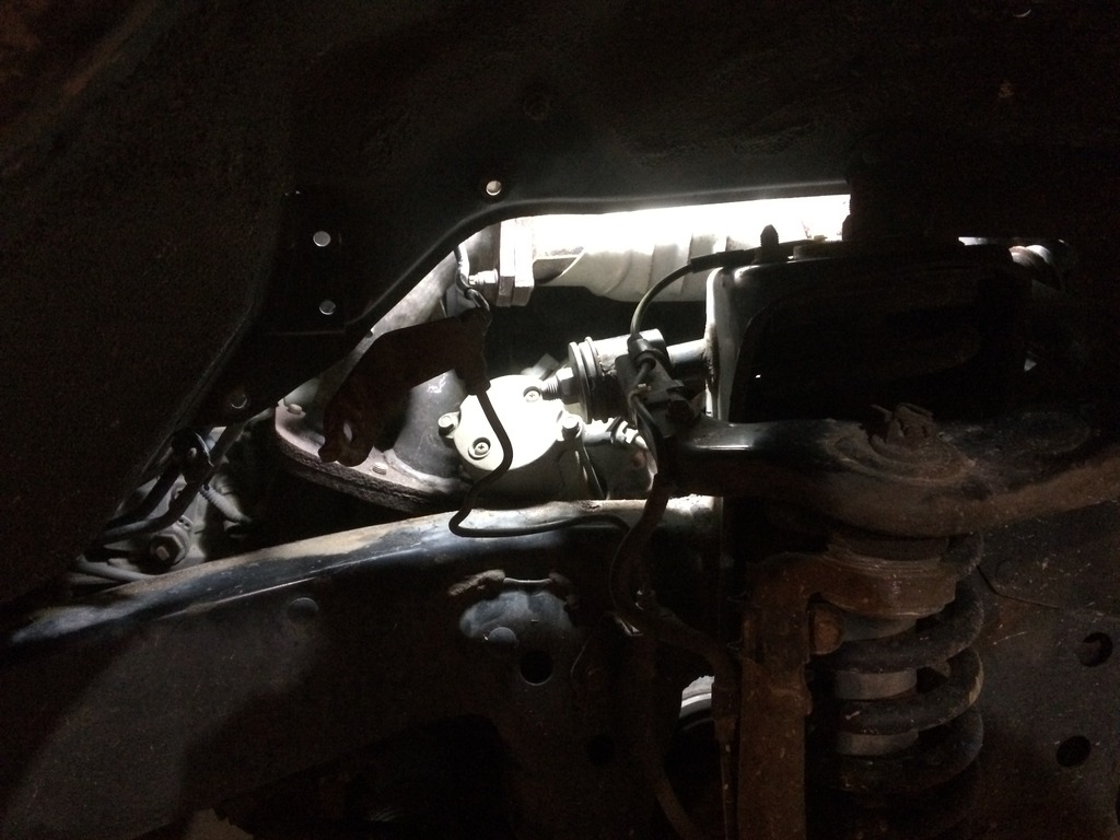

After you put all the contacts/plunger back together.....you can attempt to reinsert the starter..
Now the funny thing is, It takes so long to get it out and then it literally slid right back in in less than a minute. Haha....That one will make you scratch you head every time.
Here it is on its way back in. See you again in another 150,000 miles.....
The rest of the installation is simply the reverse of the removal. Hardest part of the installation is trying to hold the starter with one hand and start the upper bolt with the other. This step helps to have another person there to help hold it while you thread the bolts back in by hand.
Wasn't to bad.....I did not time myself, but it took me about 1.5 hours to do everything. I was in no hurry.
Hope this provides some info for anyone having the same issue.
Oh yeah....The Contacts and Plunger were a whopping $13.95......Please fellow yotatech members.....do not pay to have this done, and do not put a new starter in. These ones with last the life of the vehicle and then some.

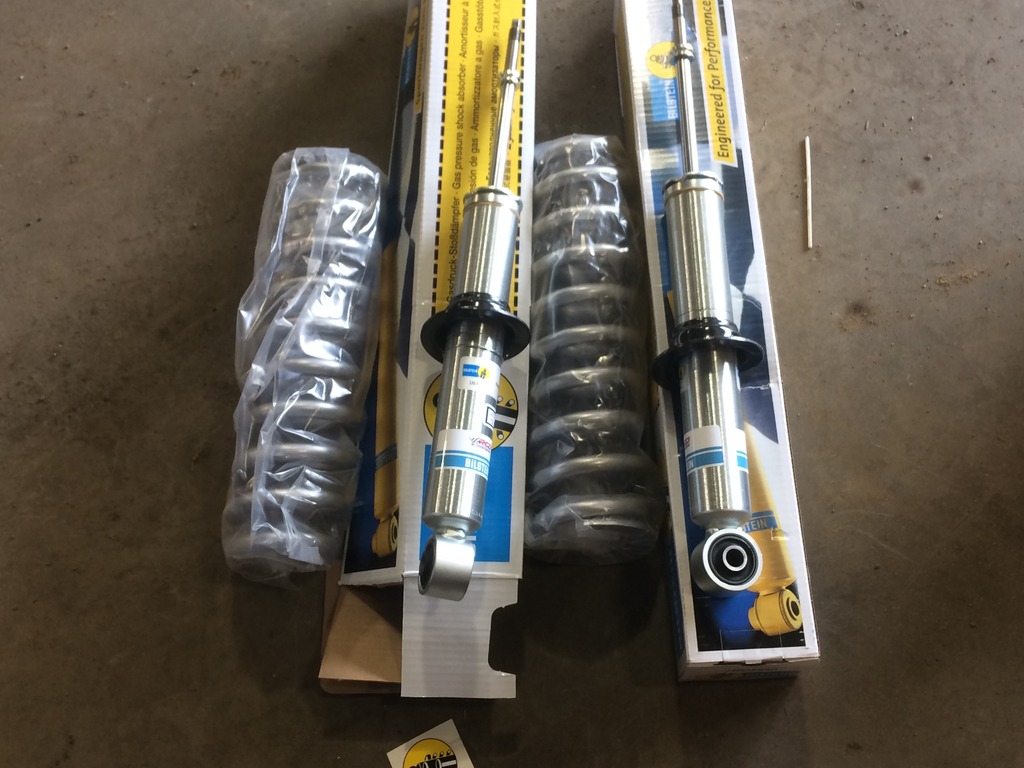

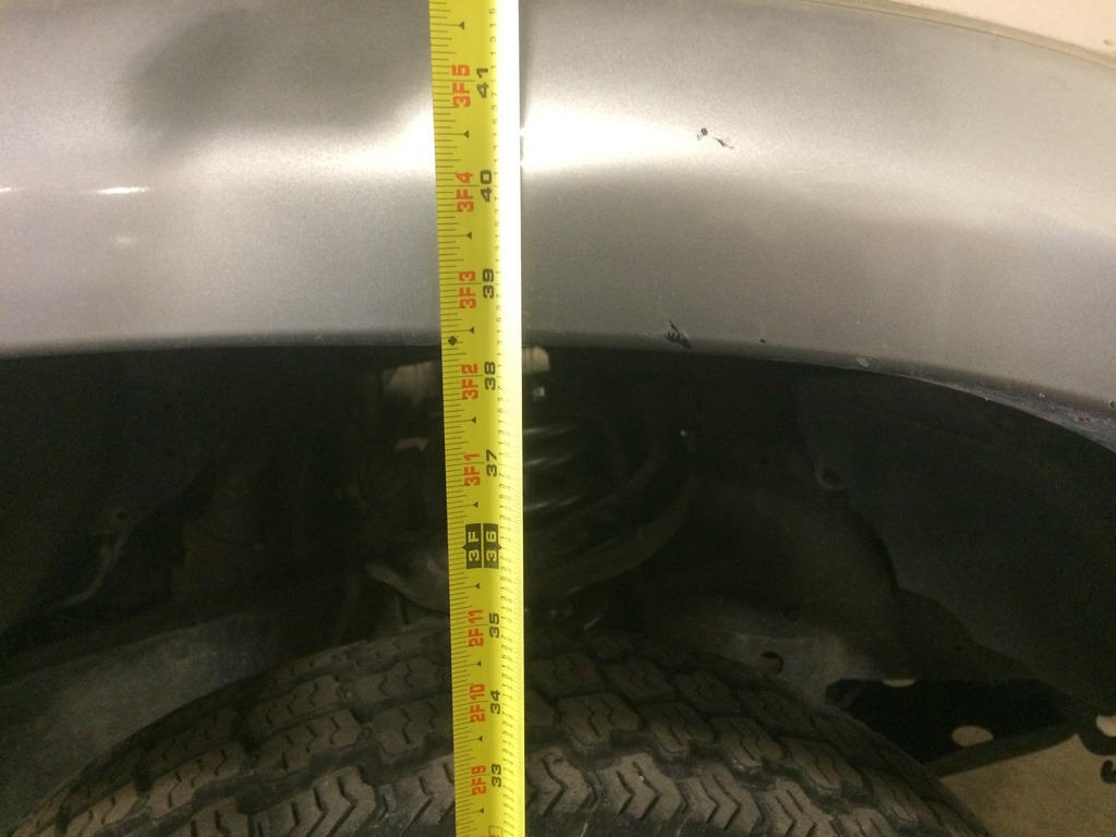

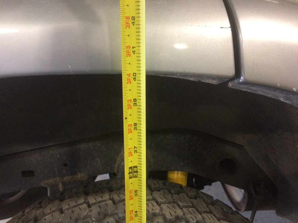

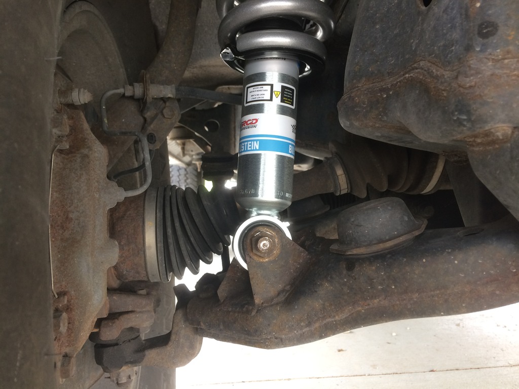

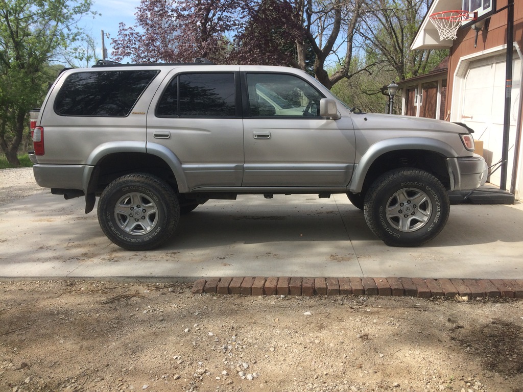

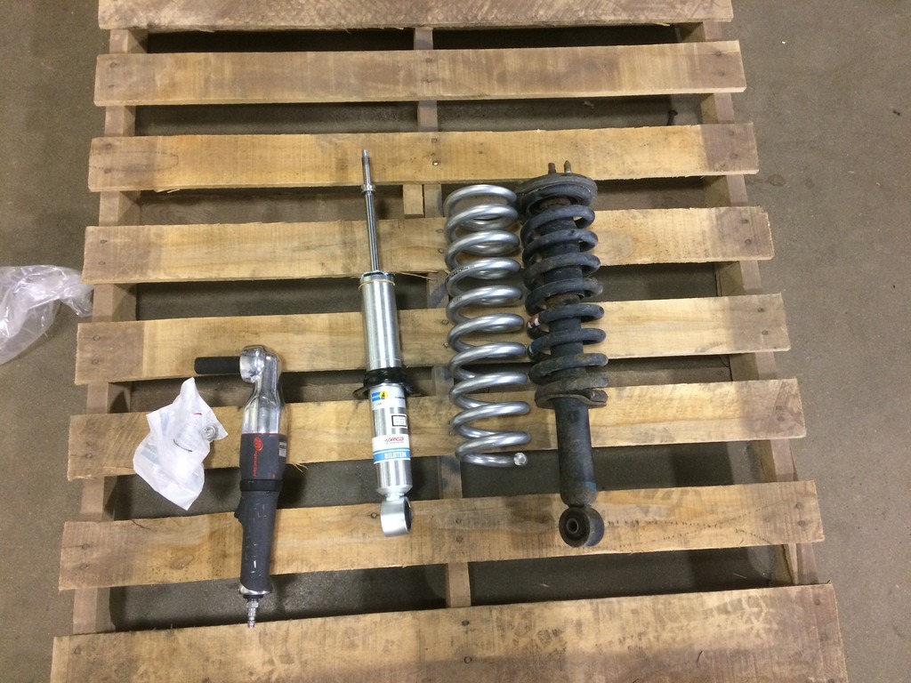

Finally collected all my parts to install the Lift. I will say that this was one of the easiest installs I have done to date. The fact that the rear has coils makes the entire process go so extremely fast. I am used to tearing into, or tearing out, leaf packs, and u bolts.......

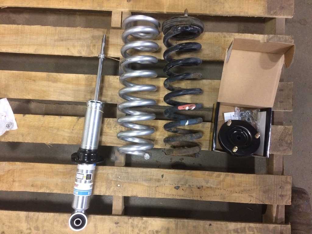

So Anyhow........As I stated before, I went with the Bilstein 5100's up front coupled with the Toytec/eibach 3" lift springs. And in the rear, I went with some Used 97 Lexus LX450 springs that were color coded Blue Yellow White, and Green Yellow White, and some Stock rear LC monroe shocks.

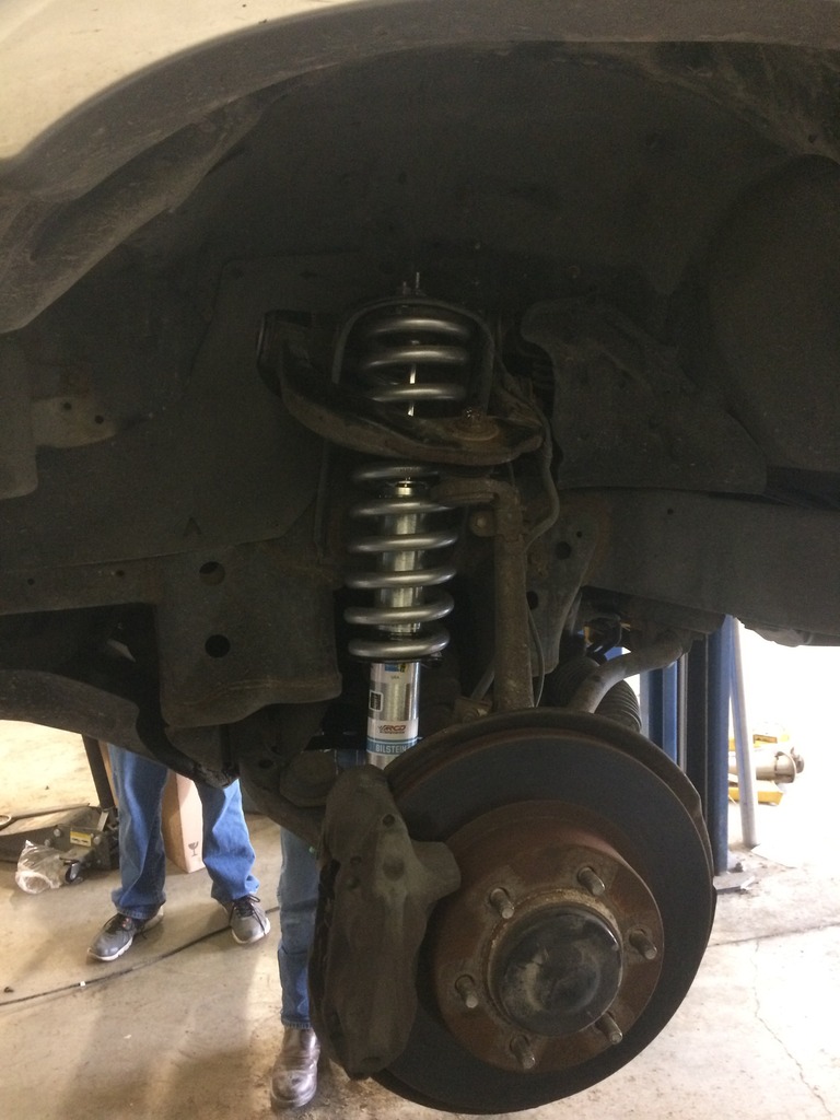

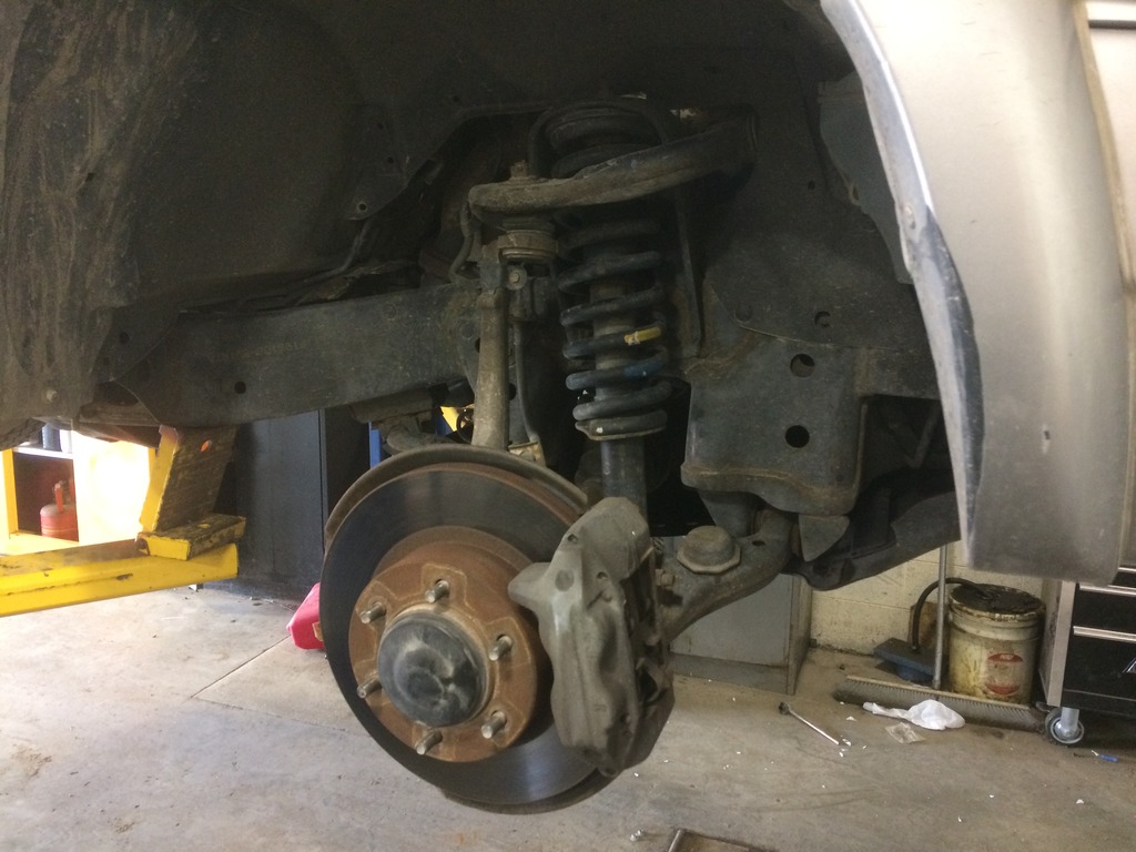

Here is a shot of the new front setup. Only thing not pictured are the new strut mounts I purchased.

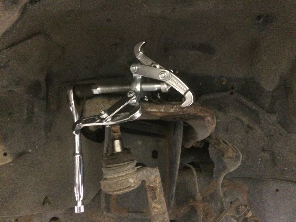

Just before disassembly. You do not have to take the upper BJ apart. I took the drivers side apart then realized that I did not need to and left the passenger side together. In the event that you do want to remove them, a 3-jaw puller does the trick.

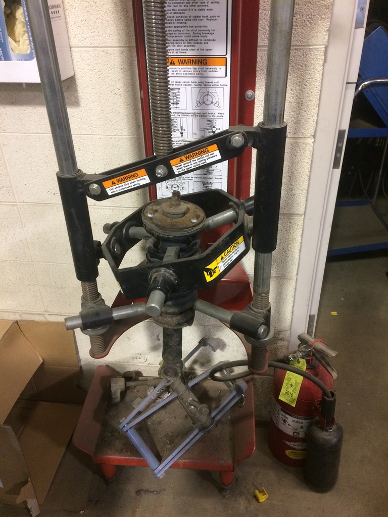

You need a spring compressor to disassemble these or you will have to pay someone who has one to do it for you. Luckily, I am an Auto Tech instructor and have access to everything I need. Here is a shot of one of the struts in the compressor.
Heres what they look like apart. And next to a complete stock strut
Here you can see a comparison of the springs. They appear to be the same length, but the Toytec is much stiffer.

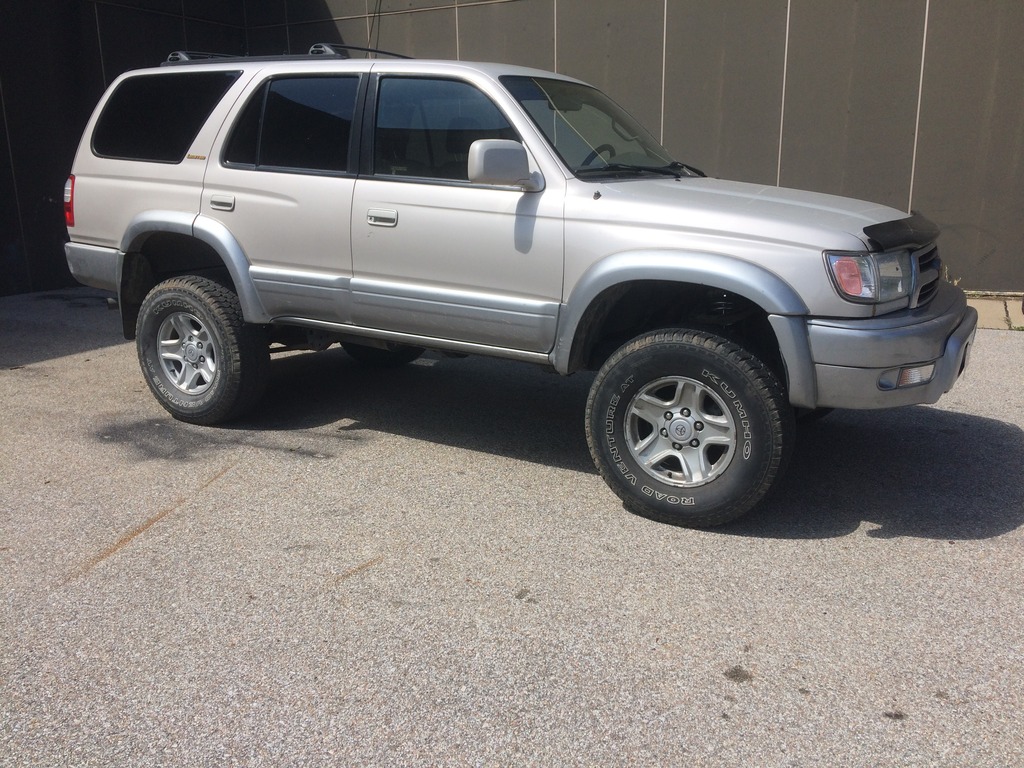

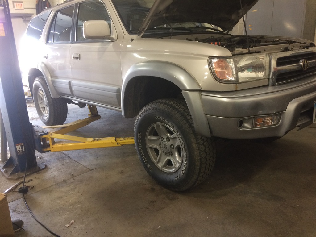

Installed. I went with the lowest setting on the bilteins and achieved 3" with it.
Great picture that shows just how saggy the rear was. This is with the front installed and the back still stock.

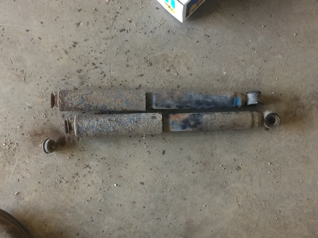

I recommend cutting the rear shocks out. The stud nuts were so covered in dirt/grime and were frozen on. Plus there is hardly any room to get a good purchase on anything to break them free. So I cut the heads off with a sawzall.
I failed to get pictures of this, but I loosened and removed the lower link front bolts and let them hang. Without doing this, even with the shocks removed, you will not have enough flex to get the springs out.
After the links were disconnected, the rear springs basically fell out! They were so worn out it wasnt even funny.

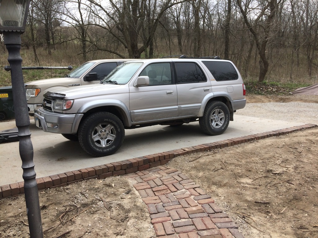

Here are a few pictures of after.
The CV angle is not that bad. But I did install a 1" diff spacer this morning.
This is before the spacer. I will have to get one of after.
Finally a picture that I put together to show the actual difference of before and after. Its hard to tell until you see this.

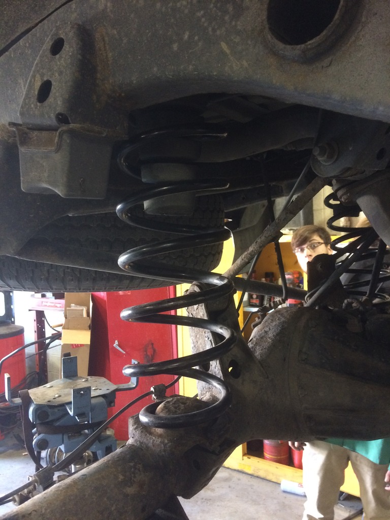

New springs in!
Now this took some time and finesse, because they were much longer than the stock ones. I actually had to use Benchtop spring compressors to compress the springs enough to get them into the proper location while I had some students pulling up on one side of the axle and some on the opposite side pushing down.
I also failed to get before measurements but here are the afters.

Thanks Buddy! It is definitely a blessing sometimes to have access to all the stuff I need to complete a project or a repair.
The ride is unbelievable compared to before. 100 times better. The stock setup was so clapped out and beat down that it was hitting the bump stops in the rear when going over speed bumps. So A lot of the improvement is because the stock setup was so worn out....But.....I have the bilsteins on my f150 and they ride great on there also.
