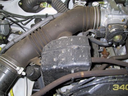

here is the pic - I've heard of other using exhaust pipe. I've never heard of a concern with heat?

That is exactly like mine, except you do not have the rear silencer. All you need is a cleanout plug from Home Depot and a barbed fitting for the FPR line. You may also need to pick up some vacuum line from Checker because it may not reach after you do the mod. Piece of cake.

so you guys are cutting up the intake? I thought this was a reversable mod?
what is a cleanout plug? where does it go?

Nope, no cutting needed. Just replace that big ugly box with a black cleanout plug and a barbed fitting.

Christian is what your calling the clean-out plug the tube that replaces the box? - do you think using SS pipe is a problem?

i would go to a plumbing place, home depot etc
get some hose etc, get some exhaust tubing
mine is set up so that I can throw the stock stuff back in, in an hour
I took my air box out, but you should be able to make this mod by using some rubber tube sections, weld a couple ports into a steel intake pipe, made from exhaust tubing or whatever...
tim

Stick with the stock tube on this one. TRUST ME.

you can just get a pair of PVC plugs and just plug up that boxy silencer and th "J" one. and if you have a nipple sticking out of you intake manifold towards the center of the truck then just get some hose and connect that to the nipple the boxy silencer is connected to.
