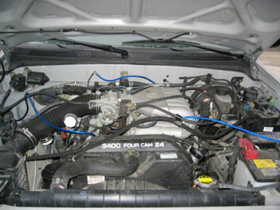

for cheap skates like me pvc caps is the way to go ... and you are wrong they do not come loose , just tighten the clamp , but the MIT will look a lot cleaner and a lot more professional.

any pics of caped ones out there?

heres another pic TBob
