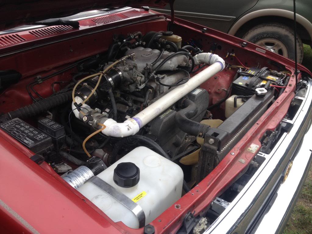

Failsafe solenoid:

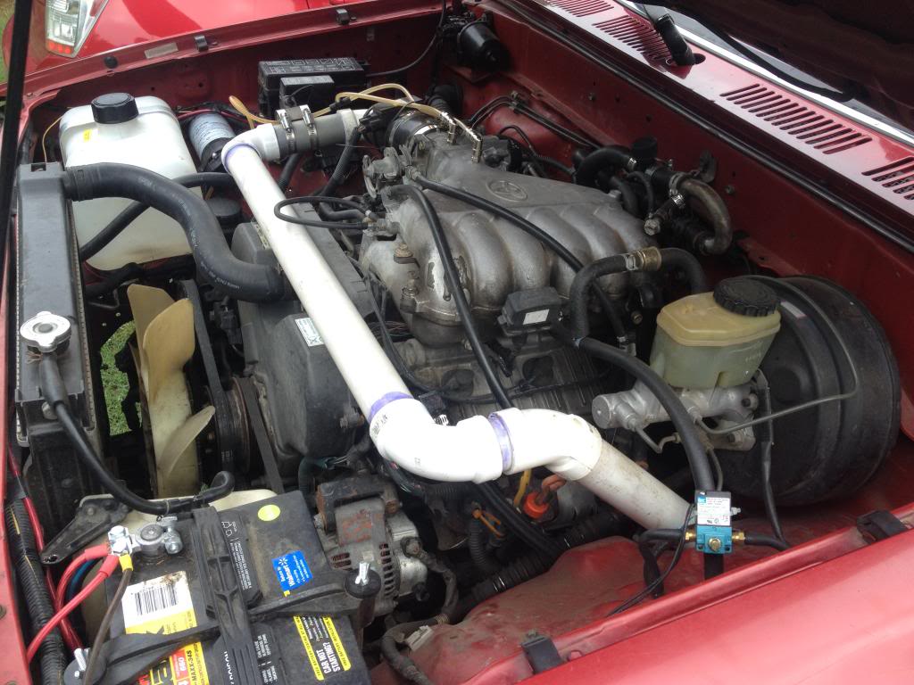

2.5 gallon Devil's Own Tank and 90 degree Coolingmist adapters and nozzles:

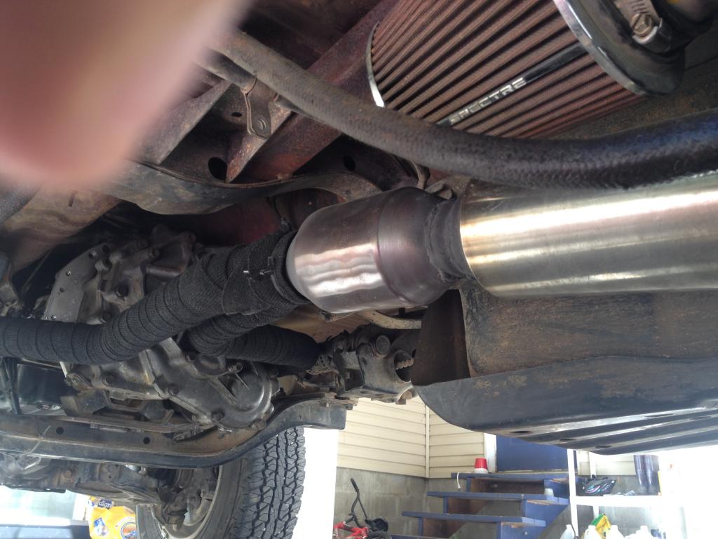

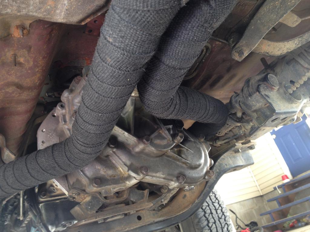

If anybody goes the rear mount method, you've got to wrap your exhaust. I can hardly believe the difference in spool and lag. The turbo is now audible at 55mph cruising and the lag is just about non-existent. Plus I added a high flow cat at the same time, which should hurt spool. But the wrap totally transformed it. The cat took all the stank and rasp away. win/win
