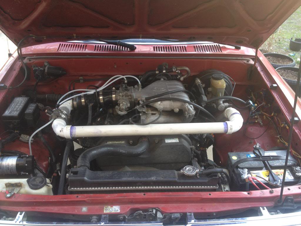

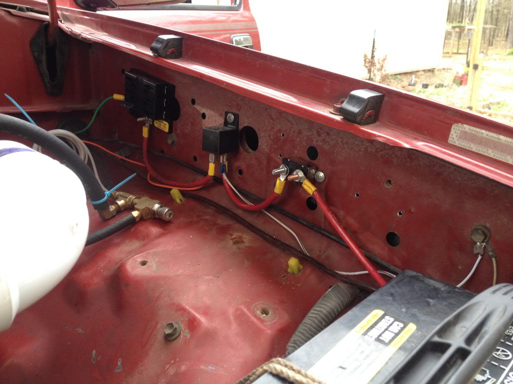

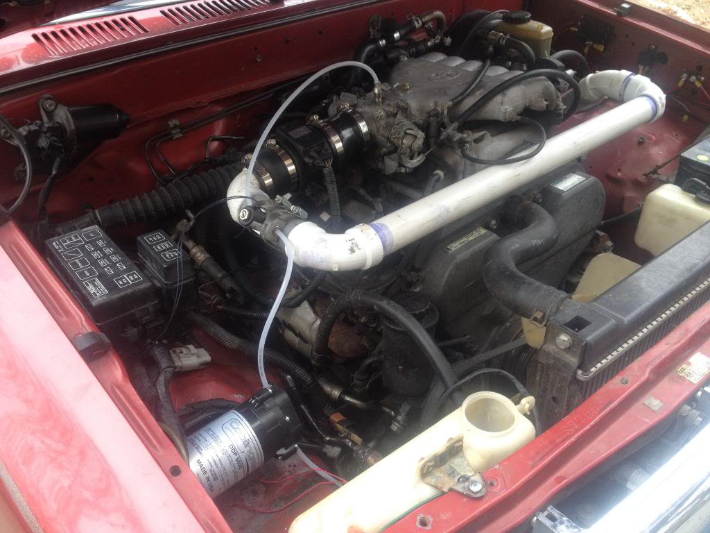

Fixed my janky wiring before starting on meth kit.

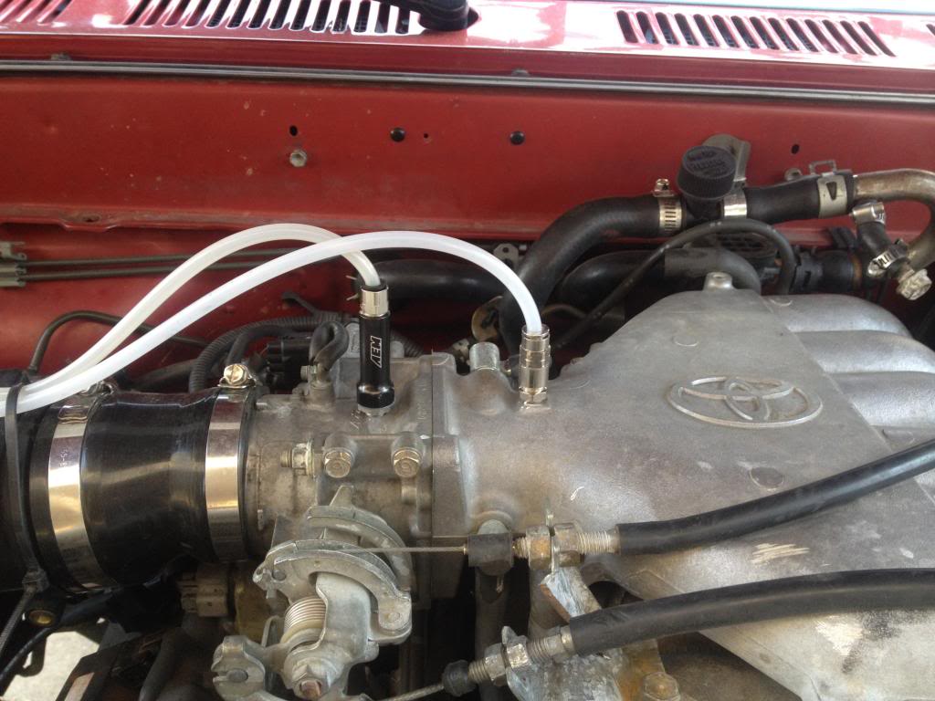

Drilled and tapped 2 ports in intake manifold for nozzles. The kit included a CM5 (6gph nozzle). I tapped and plugged another hole which I'll run a CM14 (16gph) nozzle in. Then if I need more, I can swap out the CM5 later.
Progress on the meth kit. I have zip tie stuff down, and finish wiring the solenoid. That's about all I lack having this up and running. I'm not really thrilled with the tank tap fitting. I need to put a bunch of teflon and silicone on it before filling it up. The stock tank is a little more than 2 quarts. I will find another tank to fit between the stock reservoir and the pump to gravity feed into the stock reservoir.

1 6gpm nozzle, and one 16gpm nozzle. That's about 1400cc/min of straight meth.
I took it out to street tune it today, and got it to ~15psi and it was still in the 11.2 AFR range... So, more boost! At 15psi it felt like the back tires were trying to let loose on me, and this was from a rolling start at 50mph. At what point do I start worrying about stock internals and driveline?! I feel like I could find out the max hp of a 5vz by changing to bigger nozzles, and more boost, but I don't want to find out the hard way.
edit: the only reason I quit street tuning is because I ran out of meth. Boo. Got a drum of M1 20 miles away I need to go pick up.

A repleumed intake manifold would help a lot with the power I bet as well. The stock runners are WAY too long.
I would keep going slowly till you see how it reacts. I would also look into putting it on the dyno once you get the "tune" dialed in. Both to check the tune and to see what your powerband looks like.
Meth is GREAT stuff, allows you to get away with things you could not do with much else. Just make sure that after you have it all setup that the failsafe learns and works. Test it out in a safe manner (aka, low boost) to make sure everything works as it should.
If the meth fails you are at the point you can wave goodbye to the engine.
I would really like to see the nozzles much further upstream then that as well but you would have to move the MAF to do it.

Sounds about right for that setup, make sure that the AFR's hold steady all the way to redline, they line to lean out up top.
I'm not opposed to moving the MAF and nozzles but I can't really see major benefits to be had. That 200psi pump atomizes that 16gph nozzle very easily and completely. I would like to add another small nozzle pre-compressor. I feel I'm going to start testing the limits of the 1.5" PVC charge pipe.
My AFRs hold rock solid all the way to redline. Also my truck has never bounced off the rev limiter since that last video. I unhooked the battery shortly after that and never had a problem again.
