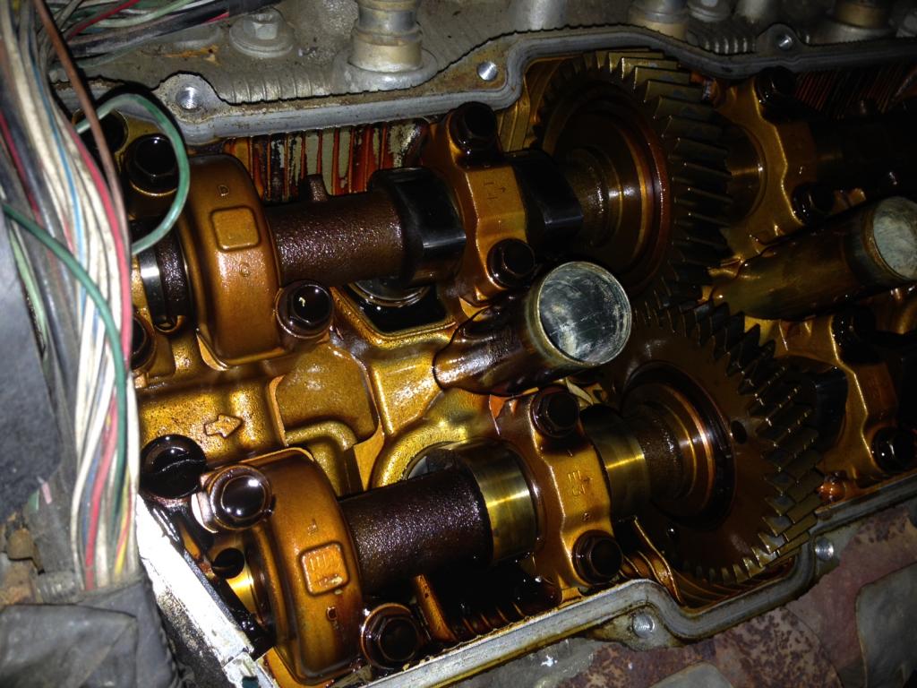

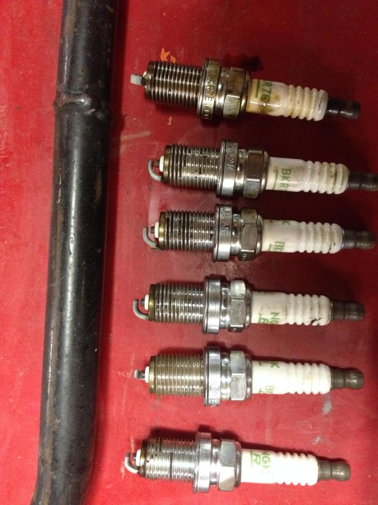

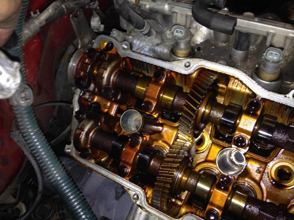

BKR7E plugs were in for 10-15 miles total. My wideband said ~14.7 while cruising. I didn't notice what AFR it went to during that WOT pull. All plugs are white. Every plug I've pulled before this set have been proper tan color.
Before I started pulling stuff I used my stethescope and couldn't pinpoint the noise. It sounds like under the intake manifold. I pulled the plug wires on the driver side and couldn't make it stop. Truck started right up, ran and idled like a champ. CLACK CLACK CLACK CLACK CLACK CLACK CLACK CLACK :-(
I don't know if these pics are in order but everything looks good to me. I can't find anything visually wrong. I cranked the motor over and can't hear the noise. I can see down the intake runners to the top of the valves. Everything looks good to my eye.
Open to suggestions at this point. Next logical step seems like pulling the heads.

Originally Posted by Robb235
So what was the kaboom? Detonation? You're running 100% methanol, right? If so, did that ignite in the intake tract somewhere, and that's what caused your hoses to blow off? That really sucks to hear. I've been following so many different build threads I didn't realize you were running 14psi. That's quite a bit of boost for an engine originally designed to be NA.
100% methanol at ~1200cc/min. It has been running excellent at 14psi other than going thru spark plugs every 3k miles! This motor is a stout sucker. I think that's exactly what happened. With that much meth being sprayed, and the engine misfiring a few times it built up. I mean it was BAANNGG! So, question is, what did that damage when that occurred?

I wouldn't have thought that tapping noise in the second video wa a rod bearing completely gone. But sometime listening to videos isn't a good representation of the real sound, since cameras don't have good mic's they can miss a lot of the deeper sounds that a rod makes, and make it sound like a higher pitched, lighter tappier valve train issue.
If it's a rod bearing, you should have all sorts of shininess in the oil pan.
The usual ping ping boom boosted engine failure is hardest on the pistons, perhaps it's a piston missing a chunk. But a detonation under a lot of boost is basically like hitting the piston top with a sledgehammer, it's a crapshoot what fails - piston crown, top ring/ringland, rod, rod bearing.
I wouldn't throw in the towel, this is just part of the learning curve. Either stick another stock junkyard shortblock in and keep rocking (try to figure out what happened - do you have any logging capabilities?), or ponder doing up something a little stronger - lower compression forged pistons and H-beams, and start rocking it even harder.

I think it would be hard to tell without taking the heads off. It sounds like a floated valve. I'll bet an intake valve didn't have a chance to close up completely and ignition leached through the intake and detonated all of the meth (another reason I don't like meth injection as opposed to bigger fuel injectors and an intercooler) and damaged a spring or valve/seat.
I'm personally in the near future going to buy a spare engine and build it from the ground up with all moly forged internals and heavy duty metal gaskets. My current engine won't see any more than 8 psi until then.
Get your heads off though man

Well aren't you an optimistic SOB! I will yank the heads later today I hope and report back. It does seem as if the scenario went: the ignition misfired a few times, meth pooled up, then ignited.

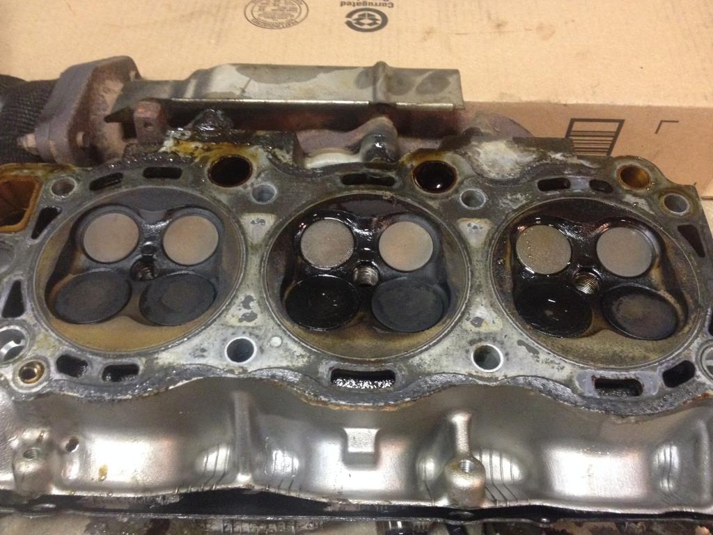

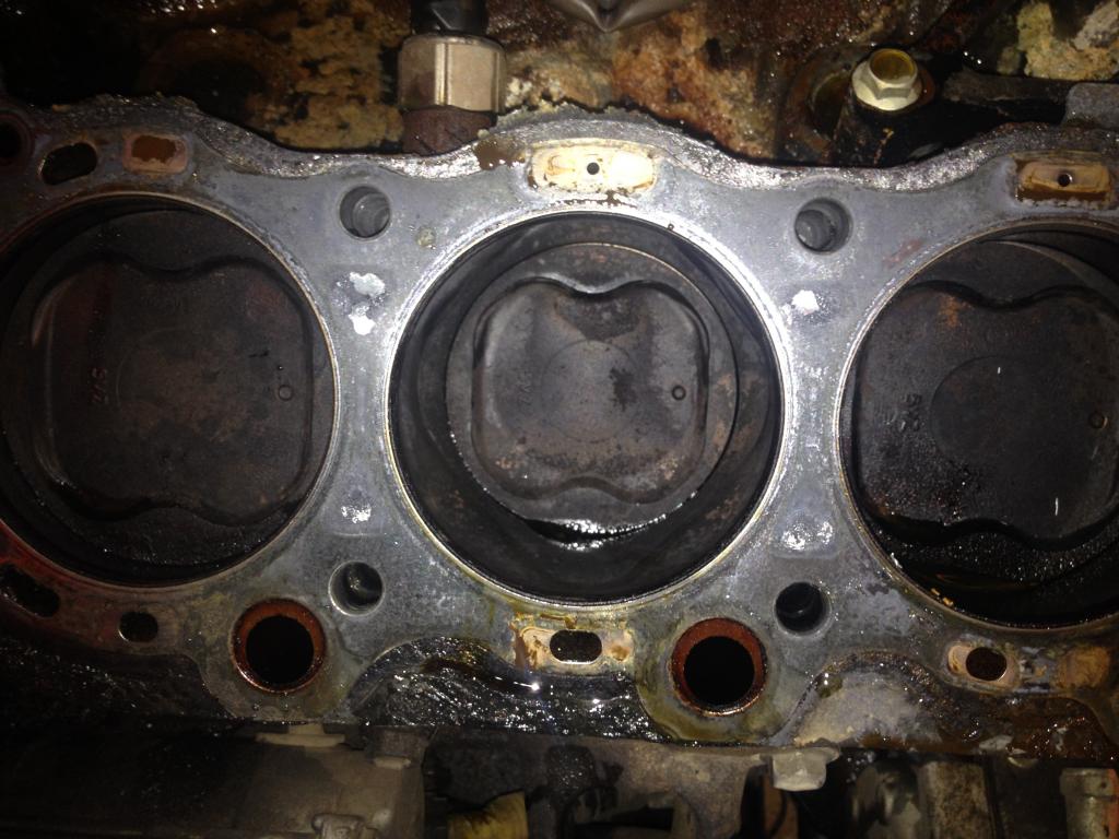

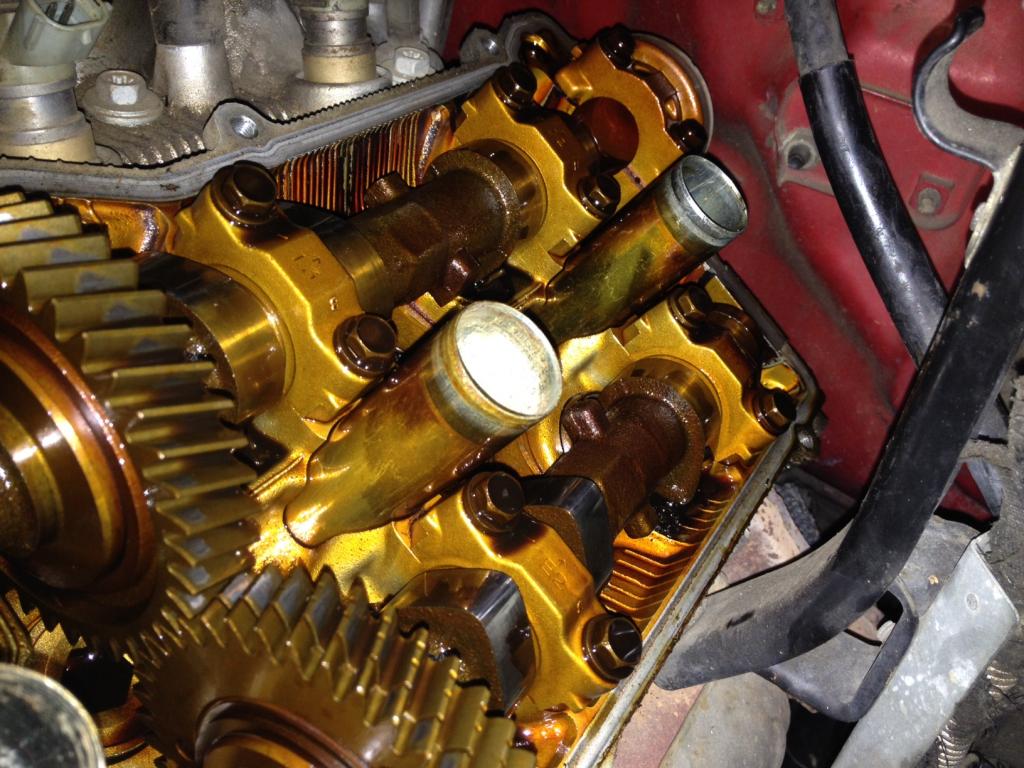

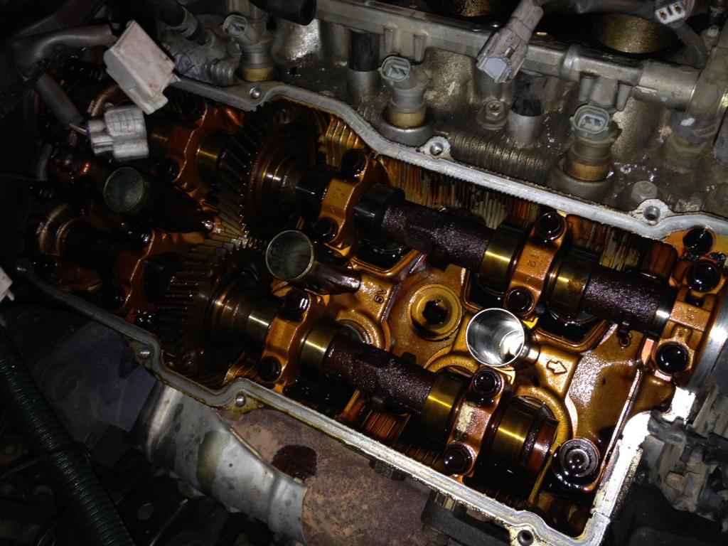

Got the heads off and I can't see any obvious damage to the heads. Everything looks great, actually. The valves, tops of the pistons, cylinder walls look good. Everything is appropriately colored which I guess means it's been running in good tune, until this.
My only "DOH" moment of the night was turning the passenger head upside down and all the shim buckets fell out on the floor. That's gonna suck to get those adjusted correctly again, assuming I reuse the heads.

By chance there is nothing in any of the intake tracks is there? With a backfire like that who knows what might have come loose and got sucked in.
