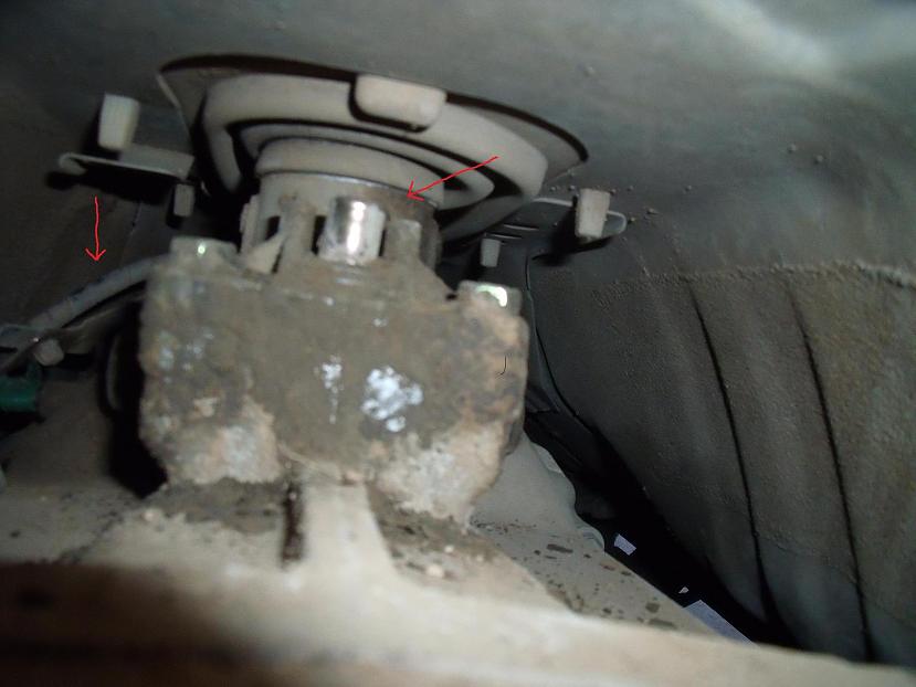

During some research on the extension of the rear differential breather, I came across a lot of questions on a (possible) transfer case breather (with or without extension), but could not find any answers.
This afternoon I made some effort and found the breather, which looks the same as the one on the rear diff (also not extended); see picture.
Anybody experience with extending this breather? how long should the hose be to run it up to the engine compartment (next to the front diff extension)?

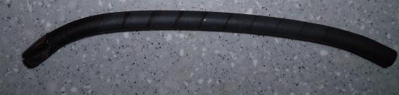

During my search I encountered a small hose that was worn and needs replacement (ductaped a for now). According to the repair manual it is a so-called breather hose that runs between the transmission side and transfer side. (see attachment). Anybody a recommendation what material to use for replacement? (size, length)?
What is the function of this breather hose?

find the same size vac hose at your local auto parts store. As for the function, specifically I'm not certain what the engineers had/have in mind on that newer stuff. I'd imagine its to vent pressure between the Tran/Tcase to keep them equal.. a breather (as you found at the top) is designed to allow pressure out easily but not so easily in but not sure about the hose... something new i guess
Old Sep 18, 2009 | 02:29 AM
drew303's Avatar
Joined: Dec 2006
Posts: 2,880
From: Olympia, WA
unless only one case is truely vented... then they put the hose in place to allow for only one breather vent?
dunno..

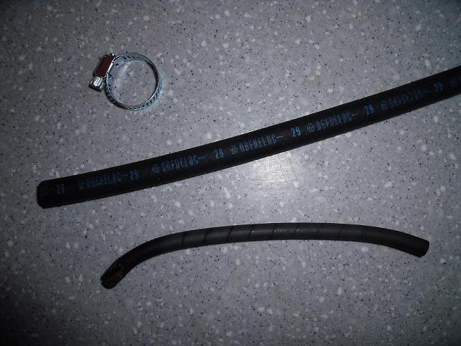

I think you are right; the hose functions as a breather for the transmission side through the transfer breather.
The hose was torn and I found the hose of kind of an inferieur material, if you think it needs to function as a breather and keep water and dirt out of the transmission and transfer case. It does not have a clamps, but just sits and the two nipples.
I replaced it with a much thicker and stronger hose and used clamps to secure. I think it is worthwhile checking.
See attached picture.
