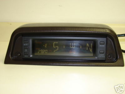

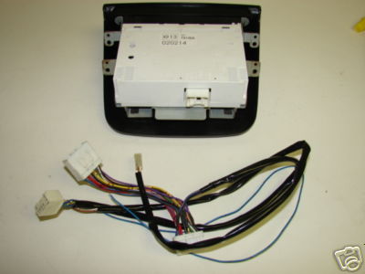

Well I've been wanting a Surf FMU (compass, temp, altimeter, barometer) but I haven't found one. Someone mentioned that the Subaru Forester had an optional Gauge Pack. After doing some research, It appeared that the Subaru Gauge Pack was a single DIN unit. I got lucky & found one on EBAY. Since I was installing a new radio, I installed the Gauge pack at the same time. 4 wires into the radio harness (I don't have a temp sensor yet) are all that's required. You can connect to the speed sensor, but it is not necessary. I now have a new radio & a working FMU. Since this unit was an option in the USA, It reads in Fahrenheit, Feet & Inches.... Woohoo, no conversions for me!
I will upload installed pics later.
Paul
Attached Thumbnails Subaru Gauge Pack (FMU) in 4Runner?-gauge1.jpg   Subaru Gauge Pack (FMU) in 4Runner?-gauge-back.jpg

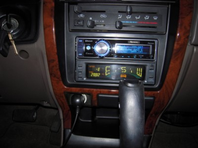

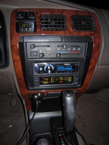

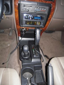

O.K. here's some installed pics. I didn't take pics during installation (sorry) but anyone that can install a radio shouldn't have any trouble. The unit is a single din & screws into the factory bracket with no modifications.
The wiring is straightforward & the unit is marked by the wiring harness. Battery, ignition, illumination & ground. The speed sensor is optional. I still need to get a temperature sensor.
Yes, I know, the head unit is very blue....
Paul
