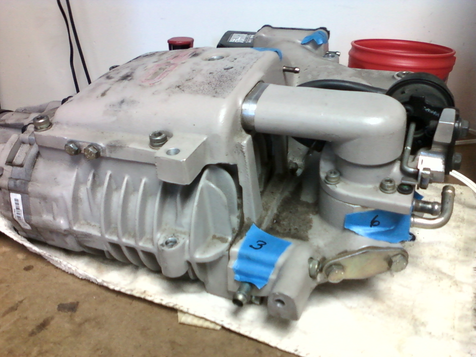

where is the 7th injector located?
I have a 1st gen factory installed TRD Supercharger on my 1999 4Runner LTD. I'm the second owner. I'm not sure where the 7th injector would be installed, if it has one. Attached is a picture of a round aluminum case attached to the firewall which has fuel running to it but no electrical hookup. Any help is appreciated. At 200K + it just blew out an injector on cyl 3 and they are all in sad shape. It's time to give it a bit more love. Thanks for any help.
Attached Thumbnails !!Speedy's Supercharger Thread!!-0709131719.jpg   !!Speedy's Supercharger Thread!!-0709131718.jpg

It would be located below that #6 tape where the plate is. You don't have one.

Texas_Ace: Thanks for the reply. So that aluminum cylinder must be a fuel line booster? Does anyone know where I can get the original installation instructions, data sheet and owner's manual (if there were any for the 1st gen)?
Yes, that would be a rising rate FPR. Supposed to help the lean out issue when you add the boost but IIRC the stock fuel pump can't keep up with it so it didn't work quite as good as it should.
