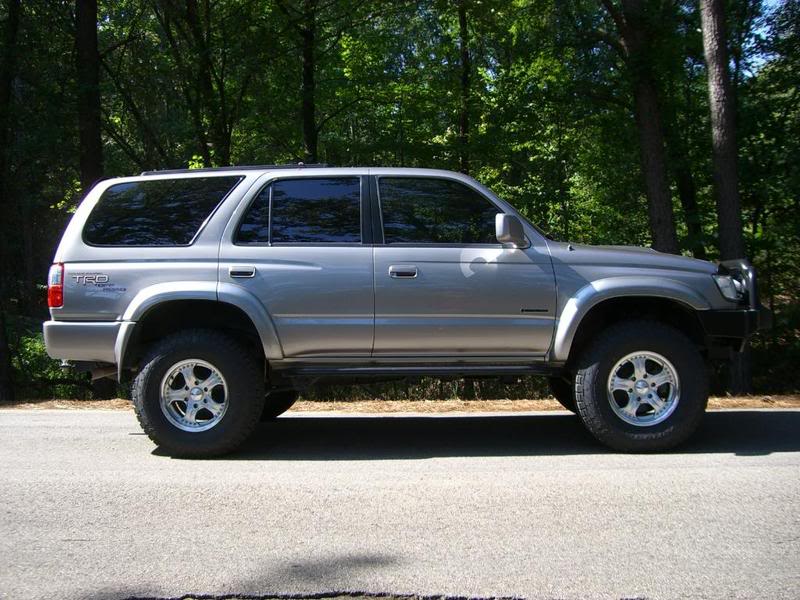

Just saw this one while looking over some info on wheels. I really dig these.
Anyone know mphudak? I'm curious what suspension he has on this:

Sticking this pic here to compare. I think I like the Level 8 Wheels better so I'll likely get those an sell my TRD IS wheels.
