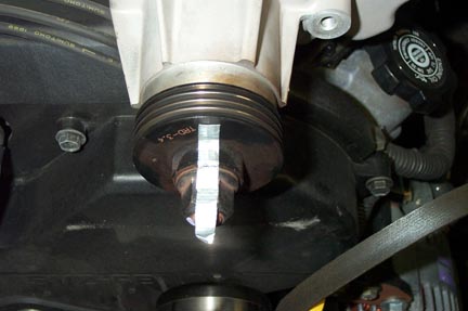

I checked closer for the sound this weekend. I pulled the SC belt off and noticed the SC pulley would wiggle back and forth (twisting motion). Kind of like it's worn on a spline or key.
I don't have the tools to pull the nut off (it's tight, though). I can't hold the pulley still and turn the nut. Maybe if I had a strap wrench or air gun.
I'll be taking it in and let you all know what happens.

pics of pulley
here are pics of what my pulley is doing. I think the nose drive is fine, but with 70,000 miles, its probably time to take care of it while I'm at it.
